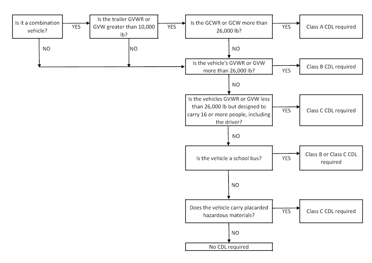

If I understand it right you will need a CDL to drive it just because it has air brakes.
You will have to jump all those hoops too.
So I looked into this and there's no CDL requirement for air brakes. These require a CDL to operate.
  1. Has a gross vehicle weight rating (GVWR) of 26,001 pounds or more
  2. Is designed to transport 16 or more passengers, including the driver
  3. Is used to transport hazardous materials in quantities that require placarding
And commercial use of vehicles and vehicle combinations is different to private use. I made a flow chart a few years ago and posted it in a towing thread. I just searched and found it.

Many states require air brake endorsements on your license to operate a vehicle with air brakes. An endorsement is different than requiring a CDL. You said that the GCWR is 26,000, what is the GVW rating? Must be less than 26,000? Depending upon how it’s setup, may not be much more than a glorified 450 or 550. If you want more speed and power, swap the rear end out for a 2 speed or change transmission out to a 8LL.
I like your chart. I know the Illinois Farm Bureau puts out a nice document for farmers covering transportation requirements of both State and Federal laws.
I have a class B non-cdl with air brakes. Initially had to get it to drive the fire trucks when returning from calls and on the State highway (can drive to a call without a licenses, can't drive back unless you have the proper licenses).
Since then we have had a couple of farm trucks over the years that I used the licenses for to be covered.

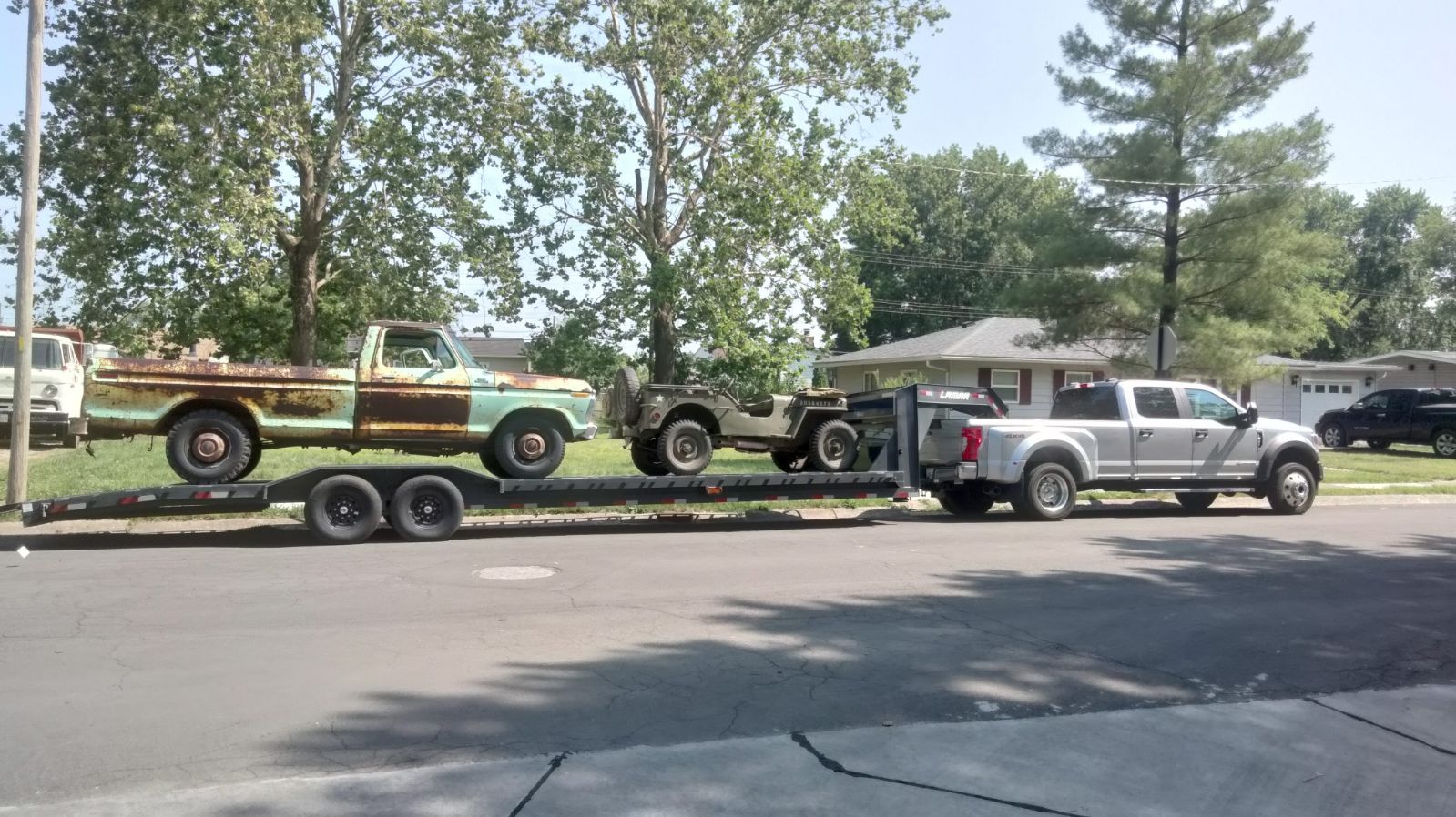

My brother-in-law has an F450 and my nephew bought a 31 ft trailer to tow behind it.
They have had really good luck with that setup. It has the 6.7 PowerStroke. We have used this setup to move my L3560 with the mower on it and it handles it nicely.

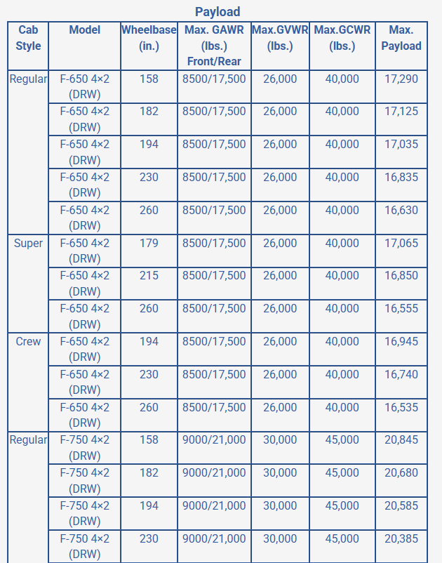

I have an '02 F250 Lariat Super Duty 7.3L with a chip and programmer and it's a great truck for towing the boat, or trailers with reasonable loads, but last summer it kind of sucked at pulling the M6060 and RC3712 on the 22ft trailer. It got me out and back, and once the TC locked up in 3rd gear it pulled ok on flat ground but struggled on any significant hill. I thought about buying a newer 6.7L Ford Super Duty in a year or two but I'm not sure that I want to get into all of the emission stuff on a new diesel.

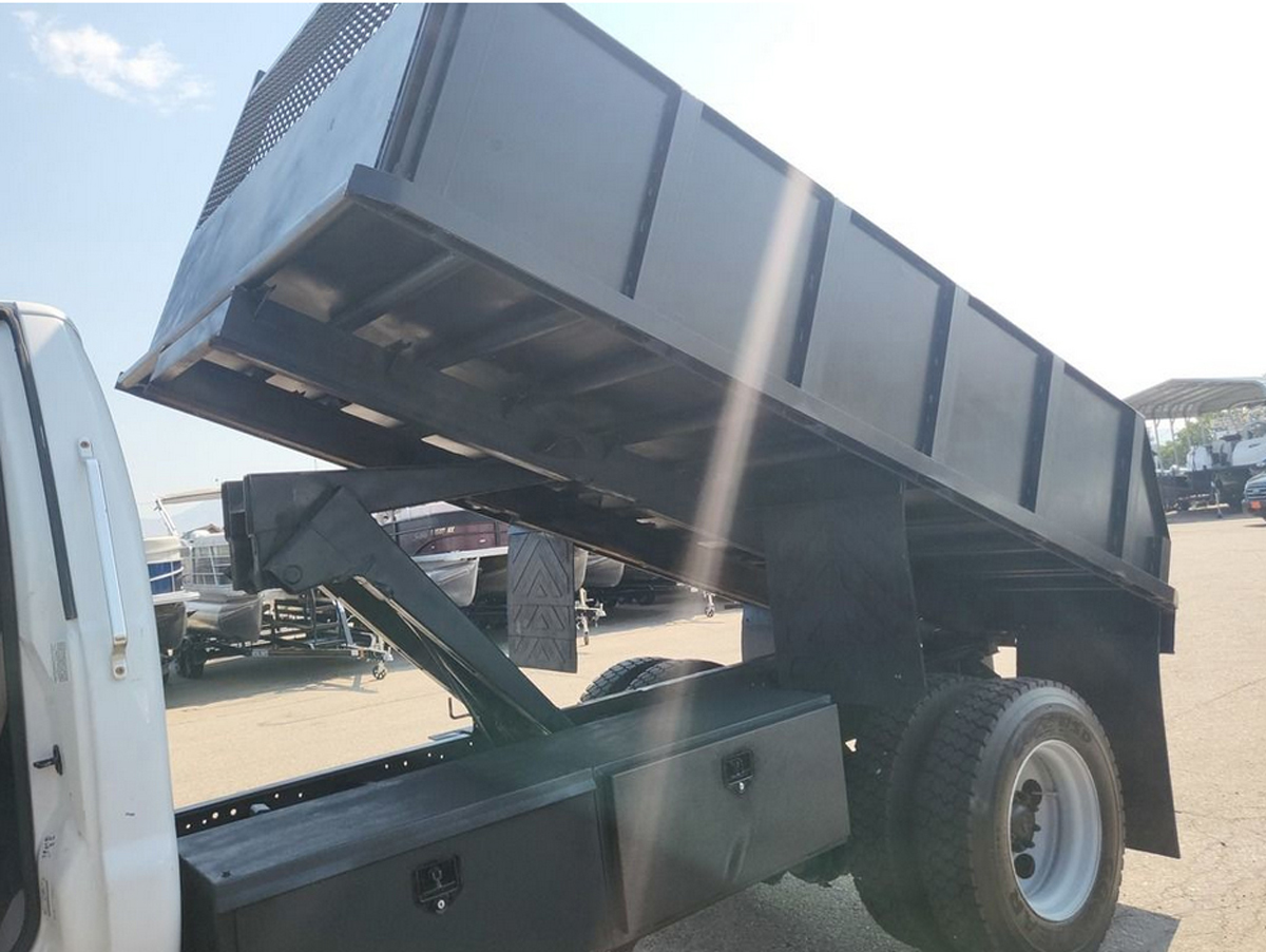

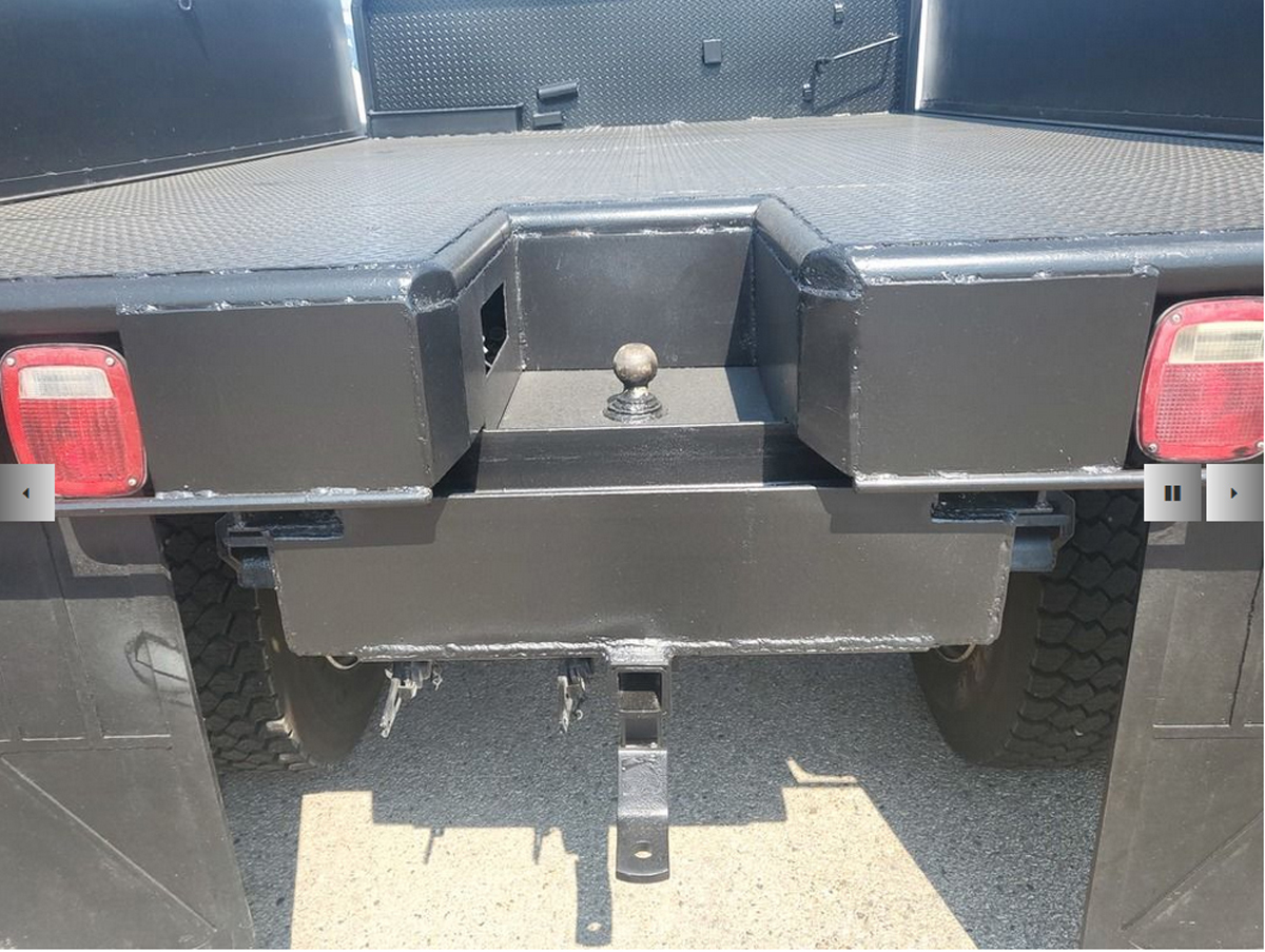

I have a 16ft PJ dump trailer which works well behind the F250, although when fully loaded with 7,500lb of firewood you definitely know it's there. So my thought the other day is why not buy a big dump truck with a dump bed and gooseneck ball and sell the dump trailer. I'd only use the truck to pull tractors and implements around, pick up firewood, pick up gravel and move dirt etc. I'd use the F250 for the boat, going into town, roadtrips, and pulling the smaller single axle dump trailer.

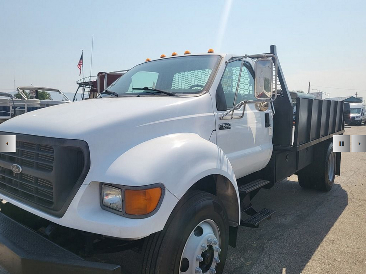

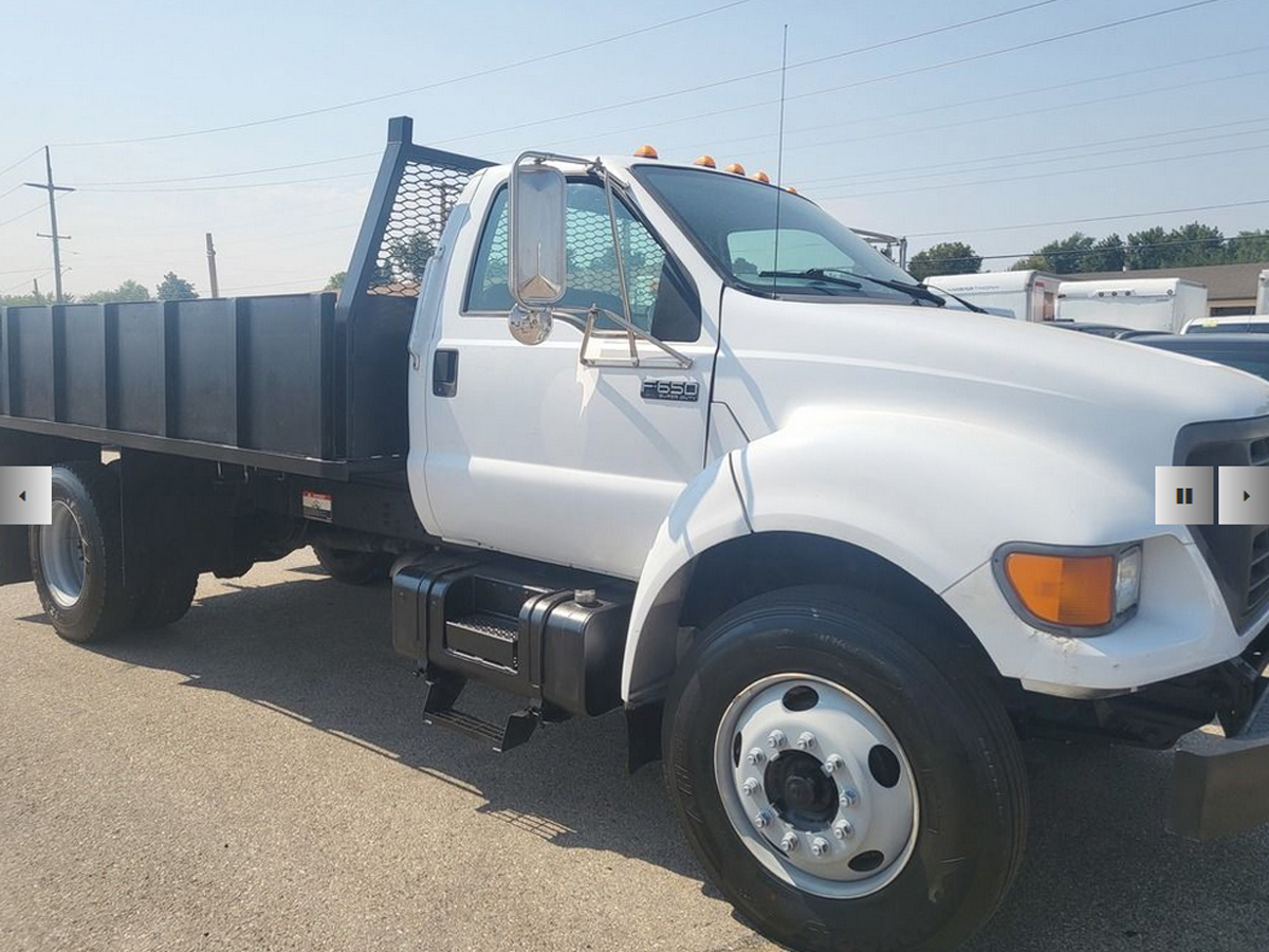

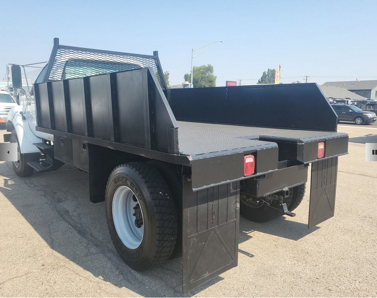

I saw an '01 F-650 2WD for sale that has a Cummins engine, dump bed and a manual 6-speed transmission with less than 45,500 miles on the odometer. The interior of the cab is very much like my F250 with many parts being interchangeable.
My good friend in Hawaii who has a successful towing and recovery business is telling me to buy something like a 2005 Peterbilt 330 Crew Cab Western Hauler but that's $63K and I think way more than I need. The F-650 below is under $30k and if I sell the dump trailer that would drop the price by $10k or so. So what say you? Is this a dumb idea or does it have some merit?
Here's the F-650.

Last comment...according to your flow chart (which I agree with) you need a Class A CDL. Work around is a farm exemption or personal use only. Check the State regs as the flowchart I believe only applies to "Commercial Vehicles".
