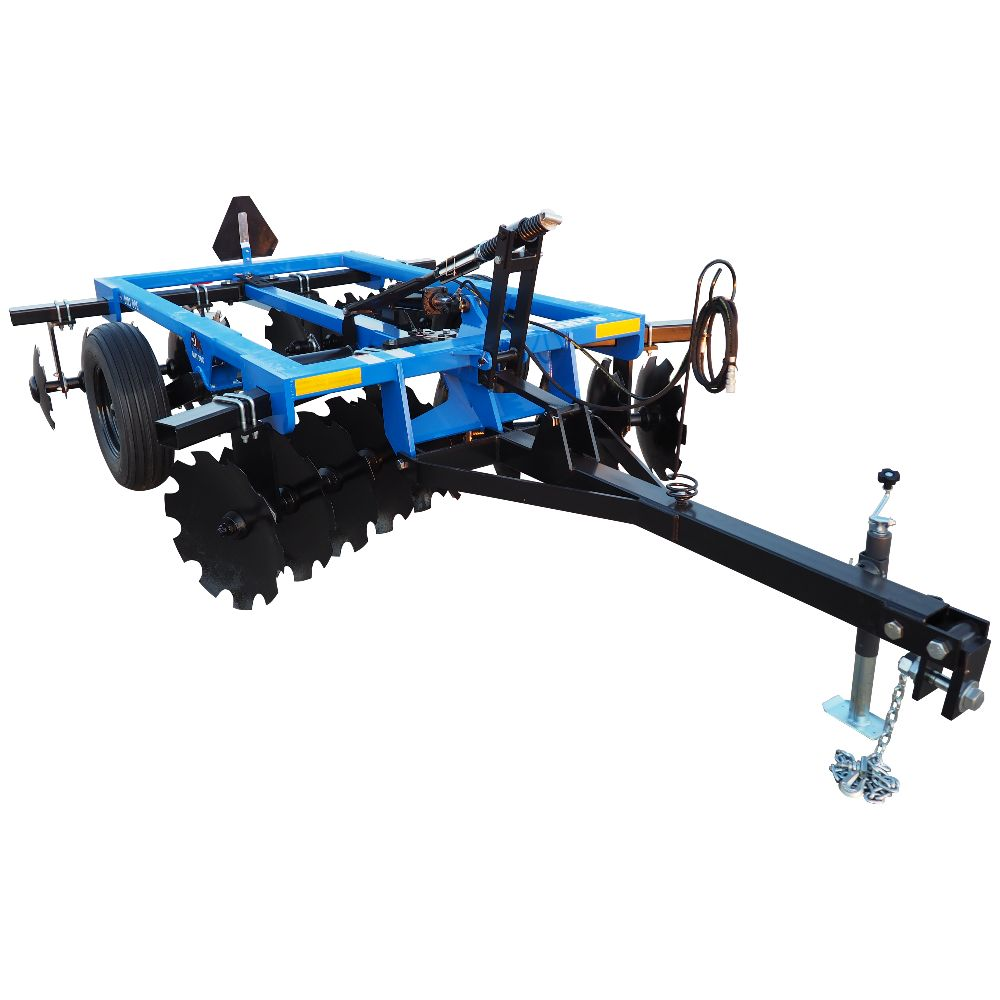

Here's an example of a modern disc harrow made by Dirt Dog that's a much lighter version of the one I have but probably costs five times as much! Notice the coupler which is the same concept as the one on mine.

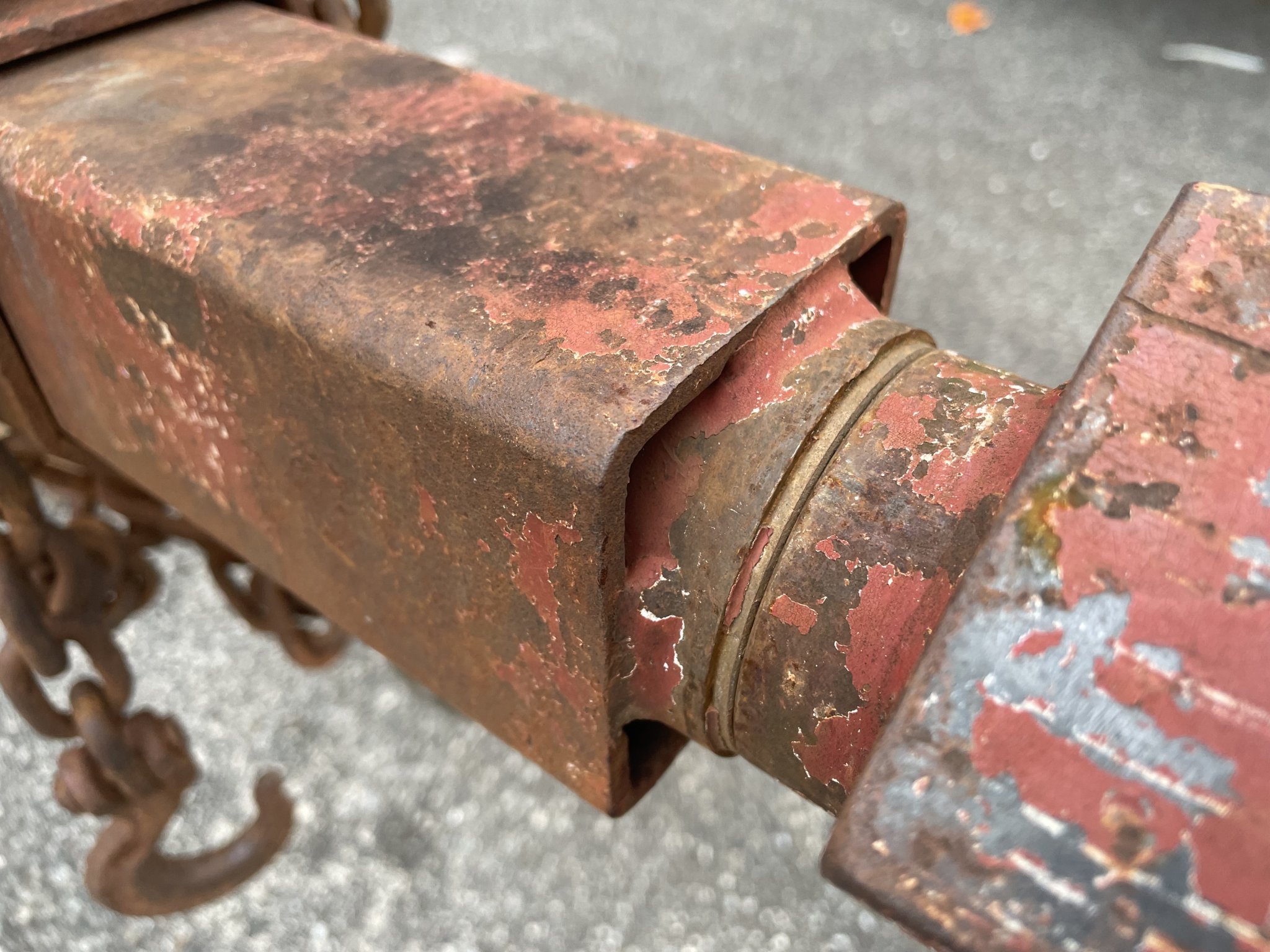

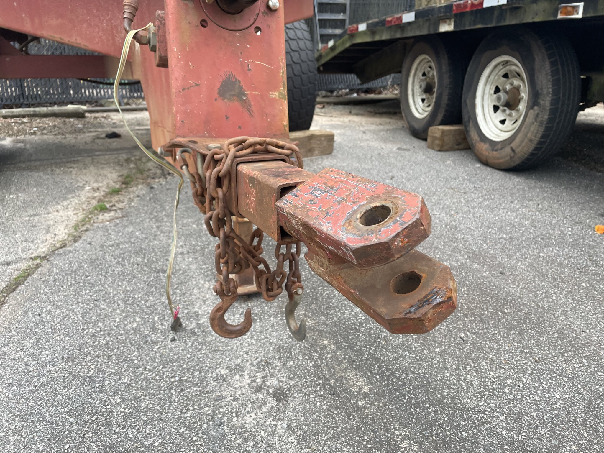

This is one of our implements at work. I’d be willing to bet there is a large bolt with nut on the other side of that round tube that is welded inside the square.
Your idea may be simpler to make with metal on hand.
That's awesome! Thanks for posting those photos. I've never seen that set up but it was Option 3 minus a link so I don't see how that articulates in the vertical plane though.

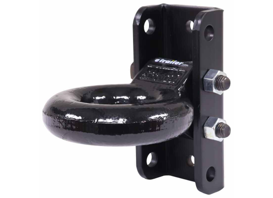

I'm still leaning towards adding a jack and lunette ring to the harrow, and making up an adapter to pin a pintle hook onto the drawbar. Probably best to have the lunette ring adjustable for height so something like this.

Canton, Georgia
You’re right. Wasn’t even thinking of vertical, only left and right! I think your pintle idea is best.
