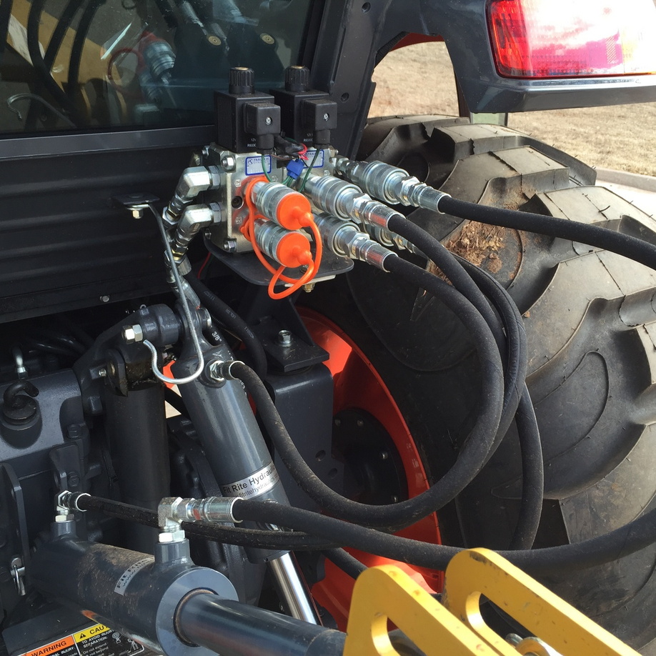

I have one rear remote ( kubota dealer installed) and would like to get a top and tilt kit for my L6060 cat 2 3pt. So three part question. 1) Do I need to have a second remote installed or is their a device that can switch between the top and tilt function that connects to the one remote? 2) if I need a second remote, is this something I can install myself ( fairly mechanically inclined; have done brakes, small engine repair, etc)? What kit would you recommend; should I just duplicate the one already installed)? 3) Which top and tilt kit would you recommend? I see the names Fitrite and Summit Hydraulic here when reading about this on the forum. To the best of my recollection, the 1st remote kit installed by the dealer cost about $1500 installed. Thanks as always.
Something like this is all you need. This guy went from having a single factory set of couplers to having 3 sets, all controlled from the OEM control lever with a 2 switch pistol grip control grip mounted on the OEM rear remote lever.
