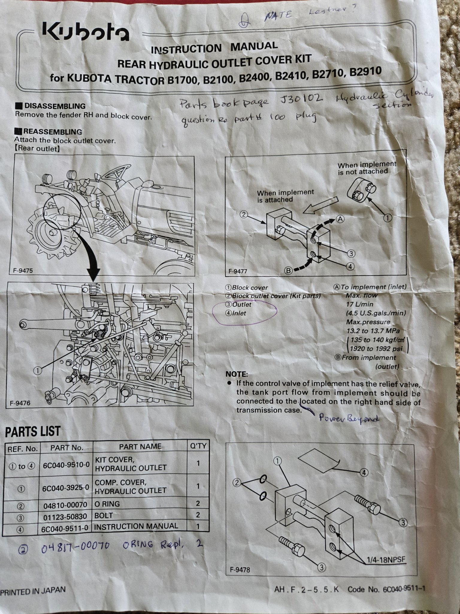

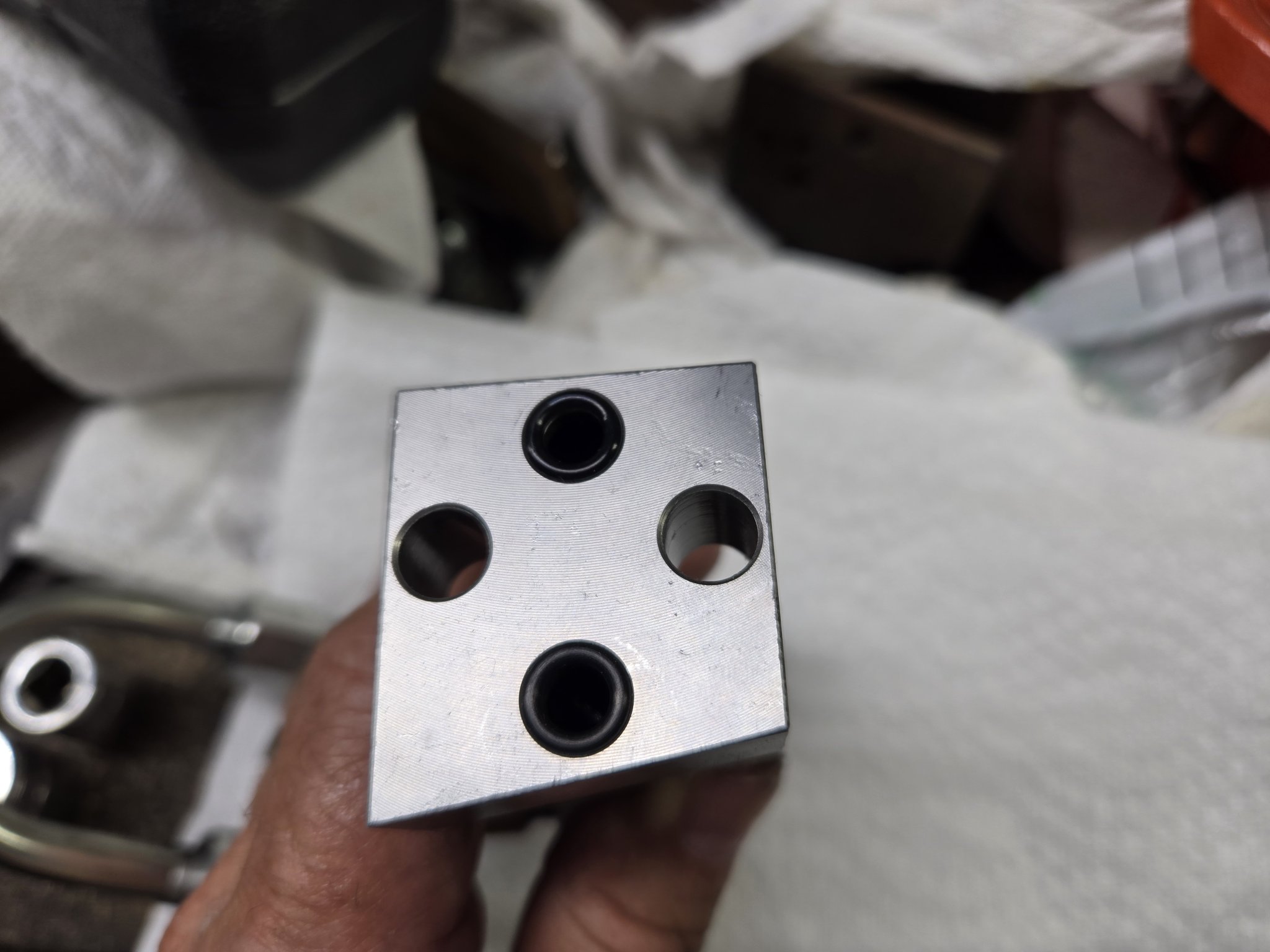

Spec is on the attached OEM Instruction Manual. Says 1920 to 1992 psi. Tractor PRV is at 2250 psi, which is in range for the tractor. Block with O rings also attached. I put in new OEM O rings each time though they do not look damaged. Thanks.
8,664
4,422
The Block and all related parts are OEM, the valve is not. Valve has P and T ports. Also has PB but not using that. The entire assembly works great, 3 remotes on rear and two on front. Only thing is the Block leaks a little at end of stroke when goes to the PRV.
The two ports in that block are pressure out and power beyond high pressure return. The tank return port is the unused port in the transmission case.
You are using tje tank return port on your valve for power beyond. Thats probably about 1500 PSI more than its rated for and I suspect the manufacturer would not approve.
Back to your problem and its not the system pressure.
The OD of the orings should be a little larger than the ID of the ports in the block (snug fit) and when fully seated they should protrude above the surface. Check and measure that protrusion with a straight edge.
