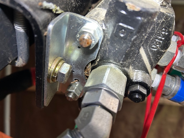

Here is the numbers on the valve (sorry it is upside down)
and the connections to the valve power beyond
4,725
1,017
Connection to the tractor
left side goes to power in (P)
right side to power beyond (unknown symbol on valve)
center is tank return (T)
Here is the power beyond port on the valve. I think the symbol may be a B for Bucher?
