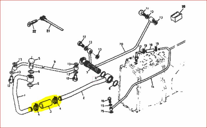

With 500 hour on that old of a machine, I would check for a dry rotted suction line that is sucking in air to the hydraulic pump. ;)

It has a steel suction line, but that is a great reminder. I had a steel reinforced rubber suction line that the inner liner came loose and sucked closed on occasion. Operate it next time and everything was good. Drove me nuts before I found it. I am going to drain the oil and look at the screen, then do some pressure testing. Thanks
