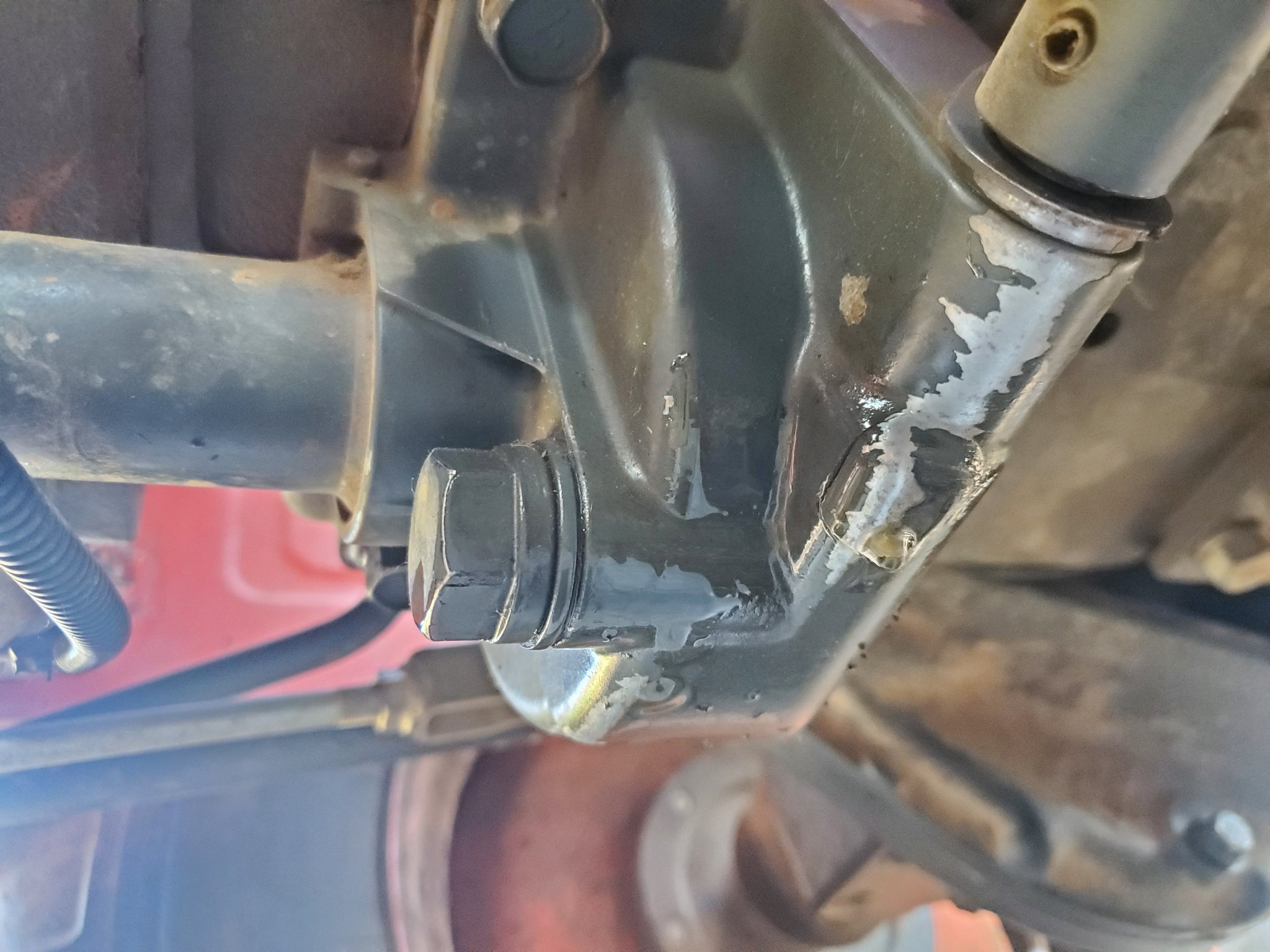

A friend of mine owns an L3700SU and cracked the FWD shift lever shaft housing. All the fluid drained out. I was able to MacGuyver seal the crack using JBWeld, enough to get the loader to move 2 inches with about 1 gallon of fluid added. I do not want to dump the entire +6.2gal load again if the JBweld bandaid fails. Questions:
1. We need to move it out of the field to where we can work on the damaged housing. What is the Minimum fluid needed to engage the HST?
2. Is Mobil Delvac good enough to use in this L3700, or should he be using SDT2? It only has 700hrs on it. Bought it new, but the dealer has since shut down the business. So SDT2 is only online accessable.
