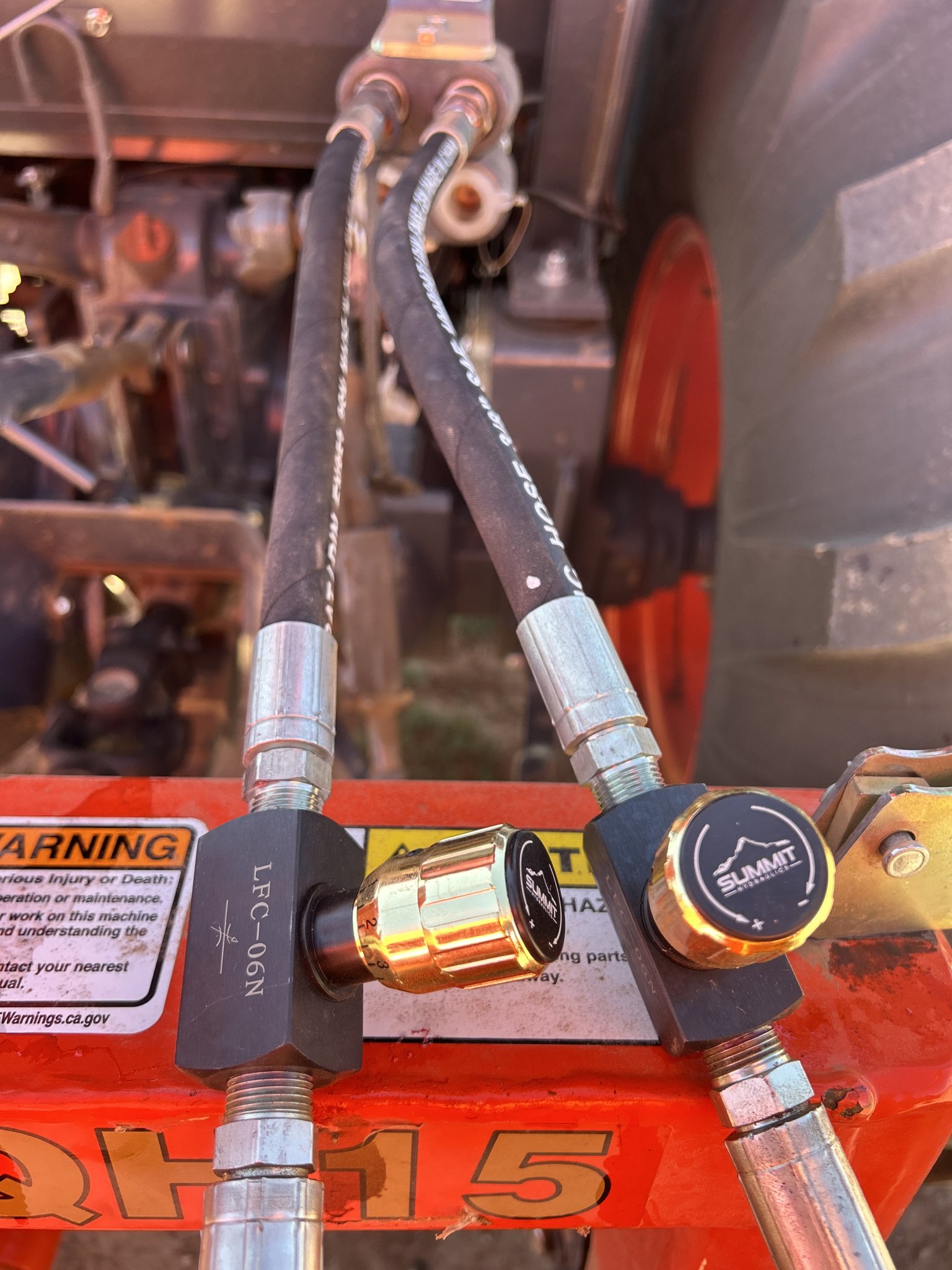

Just added a couple hydraulic flow regulators to my air blast sprayer. The volute was way too violent when I would manipulate the remote lever. I added these to slow down the action. I'll put them through a test run spraying this weekend but after installation it appears that it has accomplished what I was looking for.
