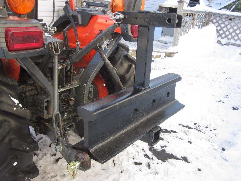

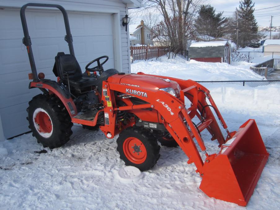

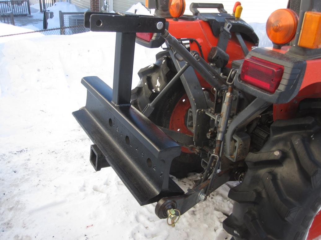

Just bought a 2012 B2320 last week. 12 of these were traded in by a Xmas tree farm (used for mowing/spraying & replaced every 2 years), serviced by the dealer & brand new LA304 loaders installed. Not it's main intended use but I used it the day after purchase to knock down snow plow banks at the end of our driveway, widen the driveway & create some space out back to park the tractor (and my old faithful 1980 B7100/implements when I can get it moved from the cottage to sell it). With a full bucket of packed snow/ice I had a lot of wheel spin (Ag tires)so spent part of last Friday welding up a 3 point rear ballast from a 26" length of heavy gauge railroad track. I wanted something as compact as possible as I don't have much room to maneuver (punched lattice on back deck in 3 spots!)& if it works out may be leaving it on most of the time - main reason for 2" receiver welded to the bottom of the track. Not sure what it weighs but took 2 of us to mount it. Just got blessed with 53 cm (21") yesterday & last night so will get to try it out shortly. Probably not heavy enough for gravel/soil work but already figgered how to make a bracket to add my 2 B7100 suitcase weights.

Spent over 3 hrs clearing driveway, more to do tomorrow. 2 big storms since I bought the tractor & I have no more room to push/pile snow! Back to my snowblower.
Rear counterweight seemed to work well. Never had a loader before so not sure what to really expect. Happy with the way it worked today.

Piker, if you want to add more weight to your fabricated piece, you could add another RR iron under the 2" receiver. Just weld it on the ends with a strap across both RR irons, and at the receiver. Then you'll have more weight, lower, still compact.
You could fab a upside down "V" at frame so you could back up and set you weights on it when you wanted to free up you 3pt.
