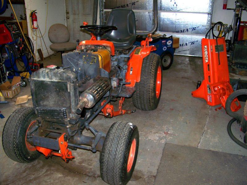

This is the B7100 HST I just bought along with the spare motor. Have $2500.00 in it so far. Also have the MM 60 inch deck, removed for transportation. The existing motor has allot of blow by, is hard to start and uses oil. The 2nd motor is suppose to be in good condition, PO said he heard and saw it running before he bought it. Just had to take his word and hope for the best.
I have removed the tin getting ready to swap out the motors. I will need to put a few hundred more in it for gaskets, misc parts and new tires. It does run well enough to know the transmission is working well along with the lift. The mower deck will need some work but it is functional.
I can take it, tell me the good the bad and the ugly of my deal?

I bought mine for $2k with no implements, and feel I did well. These are hella good tractors, from my limited knowledge. I am tearing into mine replacing what needs replacing, and my sheet metal is not as nice as yours. I think you did well, for what you have in it.
Swapping engines gives you the chance to really get to know the machine, as well as address what needs attention. Actually looks like a good project, and you will have quite a horse when done.

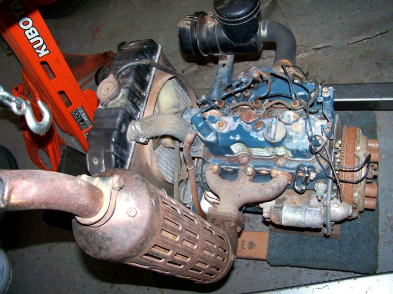

Little update on my progress. Original motor is out and have all the accessories off it. Started messing with the replacement motor, the closer I look the better I feel about it. It is too clean on the inside to have very many hours, either that or it was well maintained.
Will have to use the radiator from the original, front grill mounts are different. The old radiator is in better condition but such as life. Found a local radiator shop and will see what they will charge to go through it. Someone must have had trouble getting a hose off the top fitting. The neck is twisted and not sure how one could do that other than a big pair of channel locks.
Farmer fixes have caused me more grief, especially if they had a welder. Have one on the mower deck I will have to deal with when I get to it. In that case a big hammer did the dirty deed plus maybe a welder. One of the gauge wheels is stuck in the mount and looks like they tried to adjust the height with a sledge hammer.
The saga continues...
