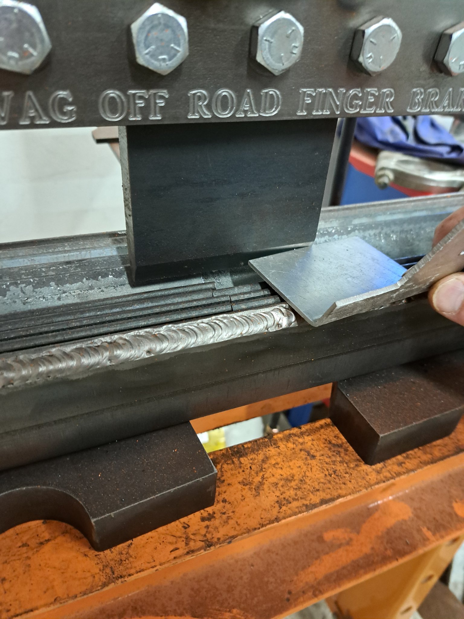

So I measure it up real quick and notice a small difference in height, Maybe 1 1/2" give or take....Nothing to worry about.
So first I have to get the old jack out.
Now my "wood scrap pile" pales in comparison to the "metal scrap pile" , so cutting two 14'ish inch "spacers" ain't gonna happen............ and me stopping work, driving to Home Depot, getting a 2x4, waiting in line to pay for it and having to "check myself out" (which pisses me off entirely) , then having to drive back home fighting the Sunday drivers and "Blue Hairs", just ain't gonna happen neither.
So I "cobble up" these "spacers", and it's off to the races....

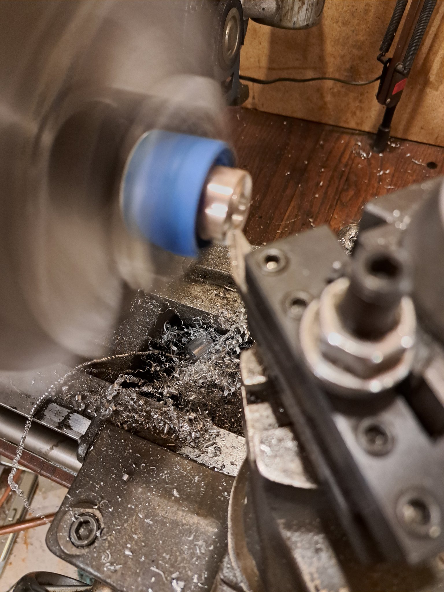

Now I chuck it up and drill it out.
I really need to get some "soft jaw adaptors" for things like this, but today, "time is of the essence", so a little painters tape will have to suffice.
Drilling goes well.

Now I chuck it up real quick and take a few thou. off.....
Nope not quite....gotta take a little more off...
Rinse and repeat with lathe......

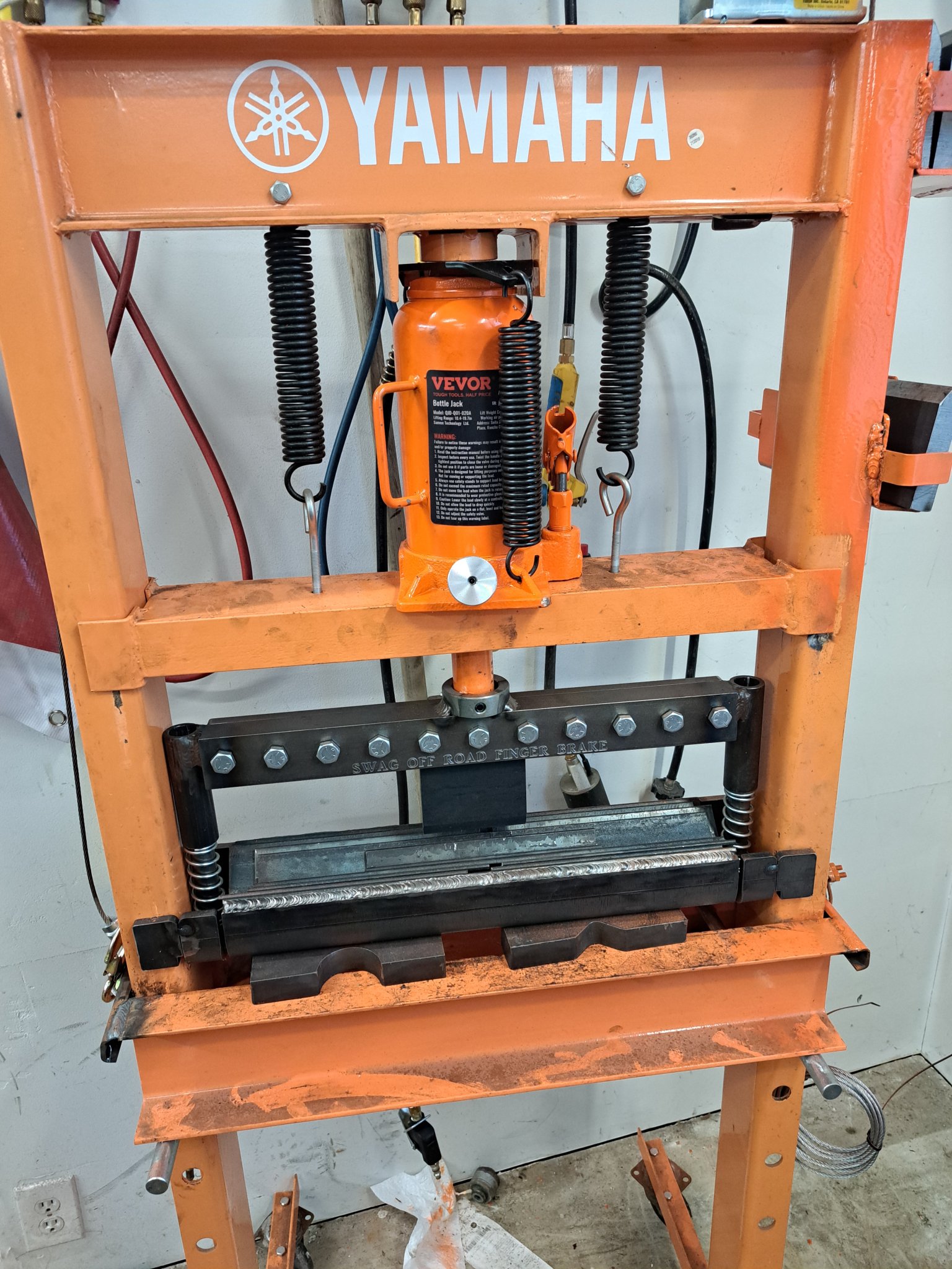

Done!!!!!
Now I just gotta put the " deck" back in place and go cut some veggies........
Hmmm.......Damn......
When I put the deck back to its original spot, the ram press's the brake down so that it won't allow any metal in the brake.
Hmm.. well that sucks. I either have to use the next set of holes, or I can cut the ram down...
If I use the next set of holes, I have to overcome about 3 inchs of "dead space"...Certainly not ideal..
Also, it is a little low to comfortably work with....(even for me)
I kick around the idea of making "special spacers" to account for the 'dead space', but that just doesn't sit well with me for whatever reason....
The only other thing I can come up with is to cut the ram down a little...

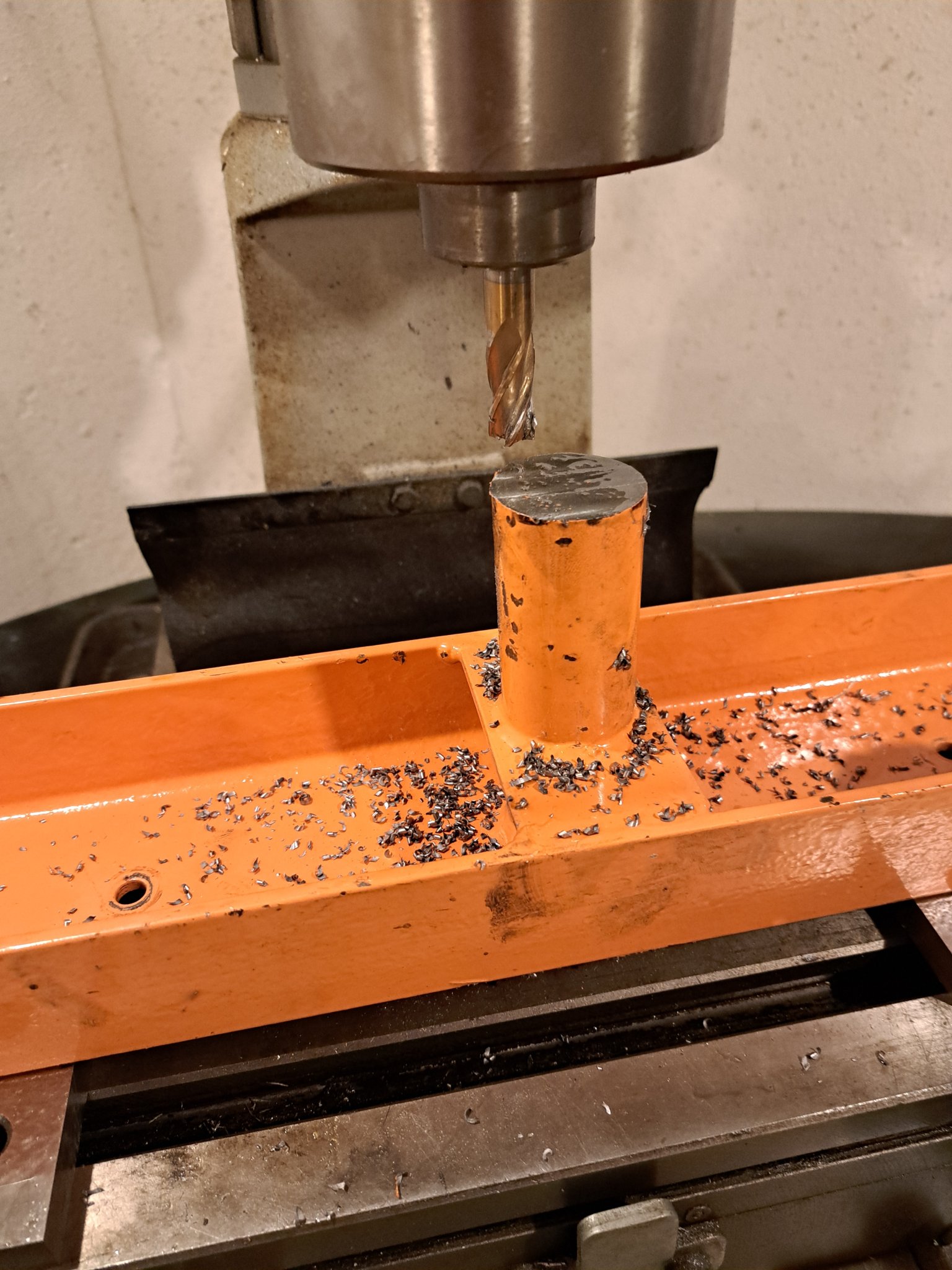

So a few options of how to cut it run through my mind... Sawz-all, angle grinder with cutoff wheel?????
Mehhhh......Hey I got it.....I will use my horizontal band saw, and just " hold it in place'
Great idea dumbass..........
I wish I had the excuse of "I was drinking" , but alas I don't...
I had this illusion/delusion that I could get a "pretty straight" cut, so back downstairs I go....
Wife: " Paul, what are you doing? They are going to be here in a couple of hours...."
Paul: "Oh #$%k it, just order some &*^ damn pizzas....hell these people are used to eating out of 'roach coaches", Jets pizza will be "gourmet" to them"
Wife: "A$$hole......."
Well now that I got making dinner "out of the way" lets cut that ram down. (y)
5,880
3,150
Did Wife ever understand you had “pressing matters”..?? :LOL:
1,929
2,054

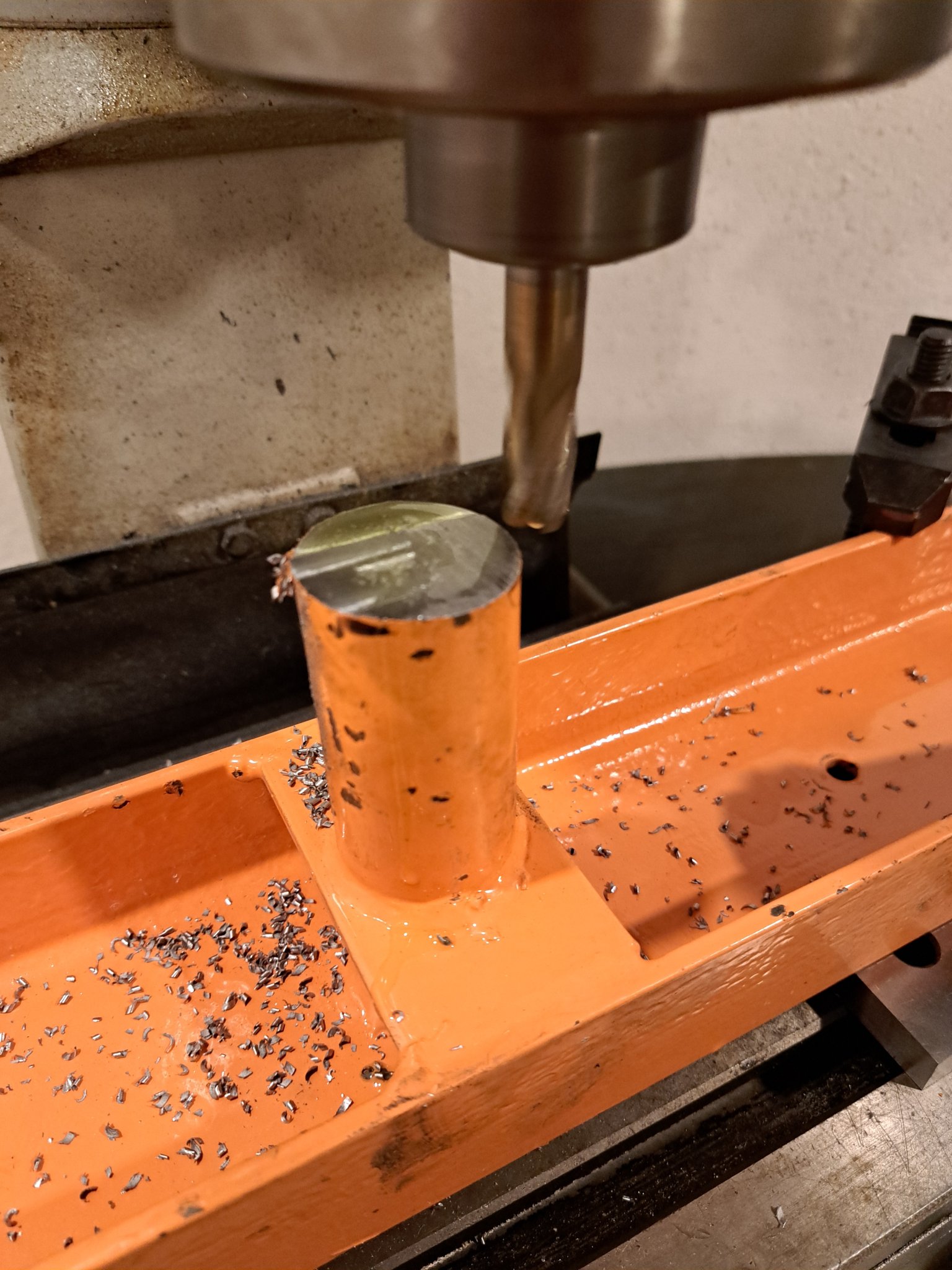

Well here it takes about 5 times of the ram "jumping off" the band saw, but I finally 'Get'r done"
And not totally unexpected, it's crooked as hell.

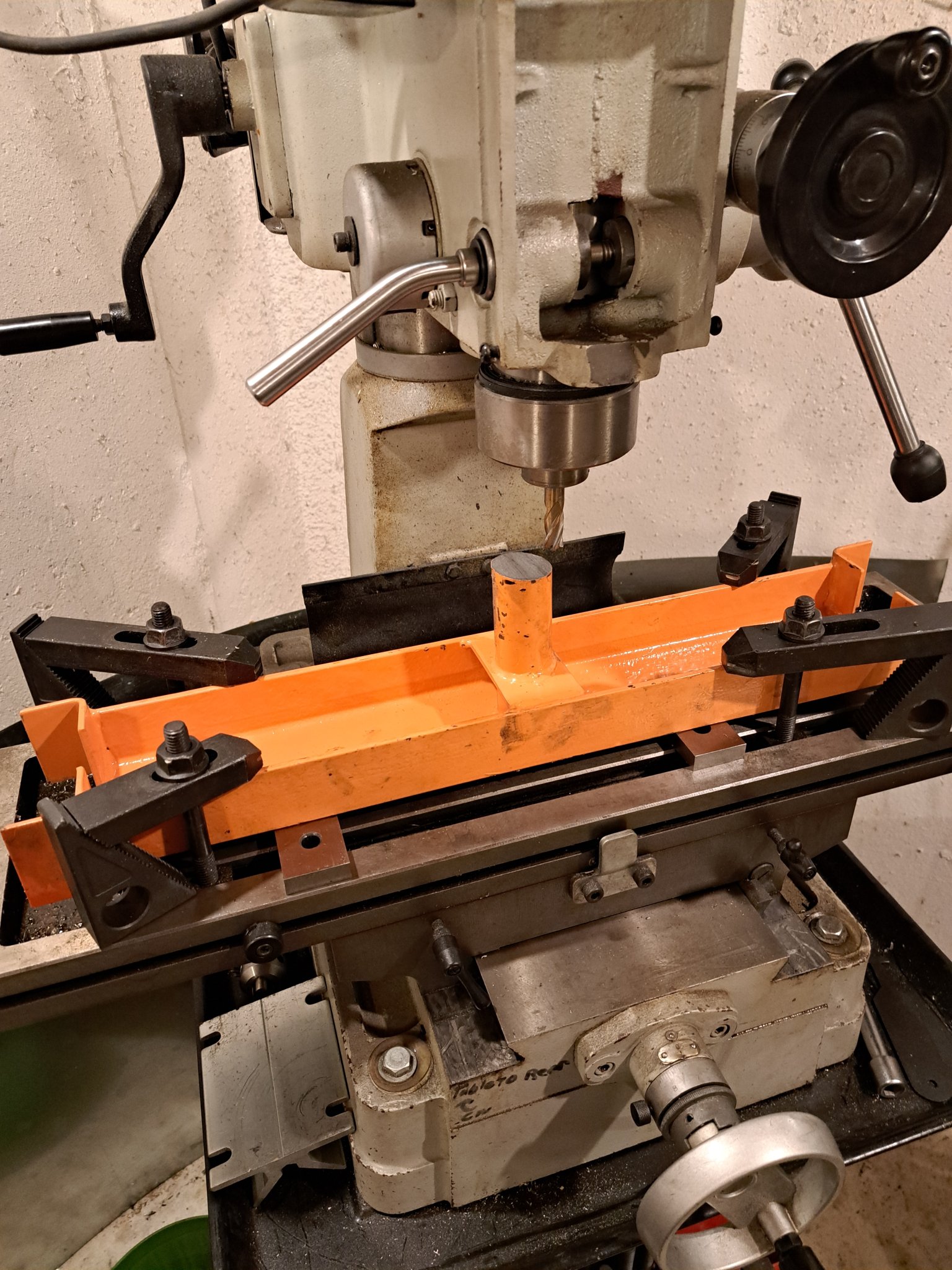

There is no way that I am going to be able to use this......So its off to the mill.
I grab some "cutting fluid" (all Machinist's, please avert your eyes momentarily)
Hey, its basically all I have, and since I retired from MX, I no longer rebuild forks, so the "inner tightwad" has gotta try to use it for something.
I am not crazy about my "hold down" set up, but it's basically all I could come up with and it was pretty solid.
A few passes with the Chinesium Mill, and it we are all set.
Now I just reinstall the "ram" and Walaa........Done!
