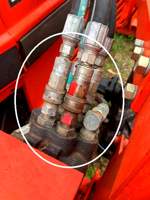

The female coupler clearly says Pioneer on it. There should also be a part number that will identify the series on it.
Then go buy a matching coupler and screw it on to the hose on your gauge.

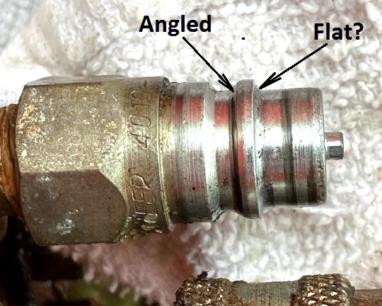

Yeah, saw the Pioneer brand logo on it....but these old eyes missed any part number. But looking now...does show something (though still hard to read).
Pioneer (4010)
Probably a 3P ?

Those are Pioneer 4000 series (ISO 5675) couplers - 4030-3P is the Parker part number for the 3/8" female half but any 3/8" body ISO 5675 will interchange.

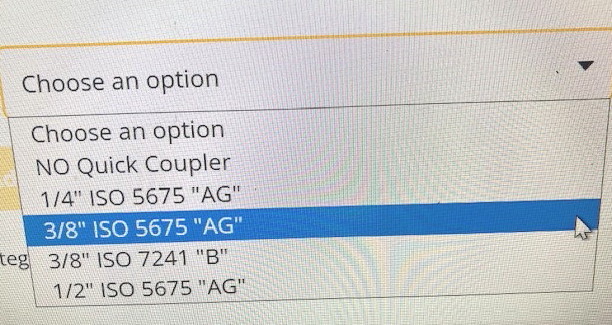

Decided against the hose. It will be simple enough to see a pressure gauge when hooked to the loader valve.
So just ordered the connector and a 5k psi pressure gauge. That way I can keep the gauge in my toolbox on the tractor.

With a complete number and the diameter of the tip, I'm sure I could help.
We aslo have four documents at the top of the page you screenshoted, they can be downloaded and print to help determine what you have.
Also, you'd obviously need a female coupler on your gauge, so we would ask that you order the cause without a coupler, then the proper female coupler for the Hydraulic Couplers page and we'd build it for you.
