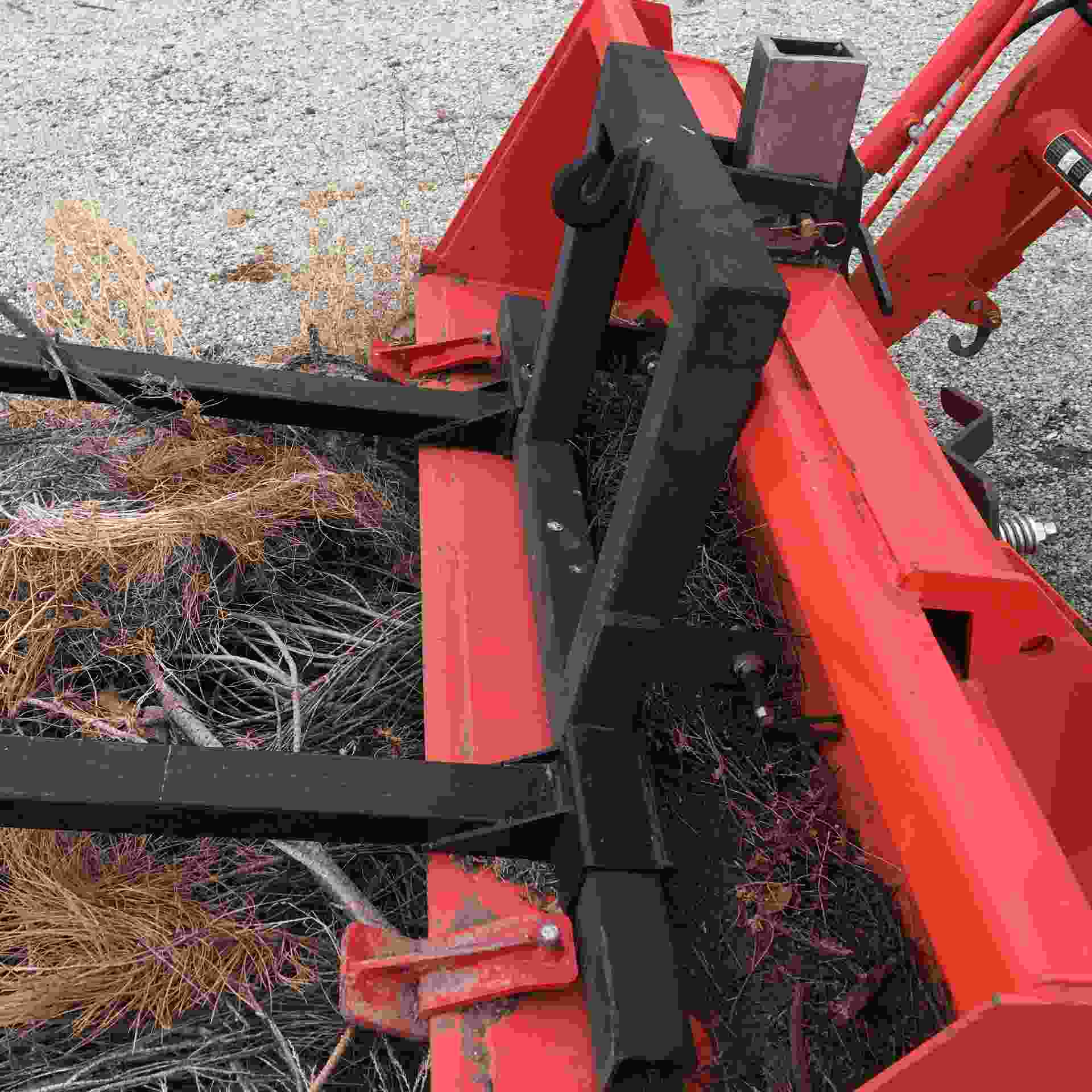

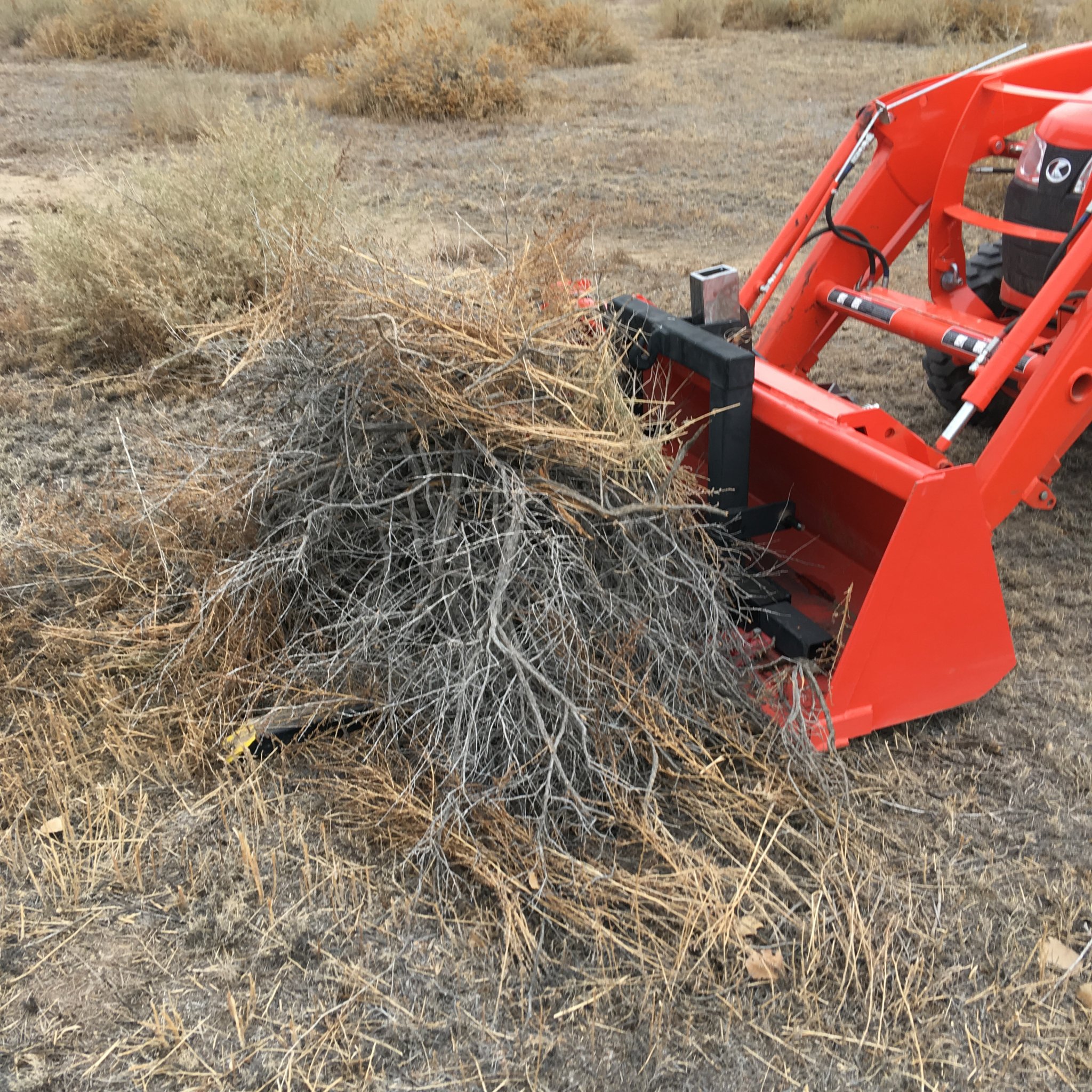

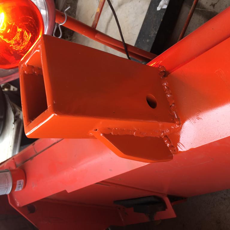

I wanted to use my Titan 3 pt forks to lift and move some light brush to burn piles so I had a post fabbed and welded to pin the top of the hitch to the bucket. I think It'll come in handy for light work.

Could you show us some more pictures as to how this works?

Those welds look to be on the cold side. Use it lightly, until they are proven to hold.

+1, especially the horizontal welds, verticals, not so much. Looks like a SMAW weld with insufficient amperage..
Sure way to tell is see the underside of the weld to see if the metal was heated through.

Heck, I can pick that stuff up manually and toss it in a wheelbarrow. I guess the bird poop welds aren't gonna be stressed with some old straw.
Aww... there’s no reason to belittle a man’s accomplishments..? A guy does what a guy needs to do and it will probably get ‘er done!

Welds look like bird poop. Just being honest. Candidly, I don't care, it's not my rodeo.

Just calling a spade a spade...oops that is racial today, sorry. Just telling it like it is, nothing more. I'd never post a picture on a public forum like that. Those are cold welds, plain and simple.
