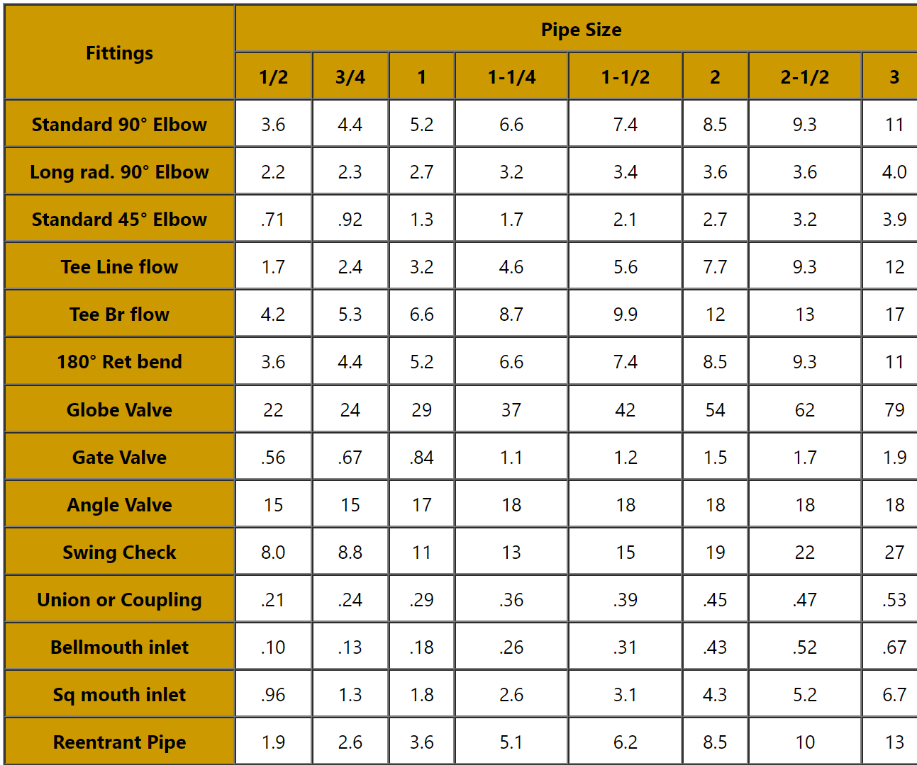

As @GreensvilleJay stated the pressure drop in a line is determined by the resistance of each element of the line (sometimes referred to as 'equivalent length' of pipe). Here is a quick table I stole off the internet:
When you add up all the elements in a line you will have the equivalent length resistance of a straight run of pipe. There are plenty of charts you can then find that will show you the actual pressure drop as a function of the pipe size, equivalent length and flow. The only time the pressure will be the same at both ends is when there is 0 flow - a static condition. As soon as there is flow there will be a pressure drop.
