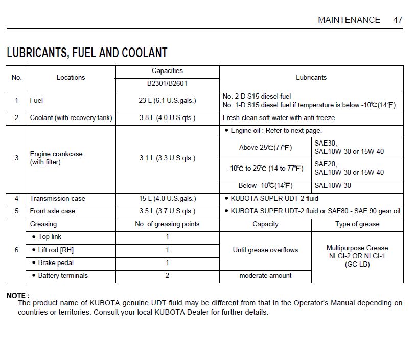

Type of grease is listed in your manual, look up what your local Auto store has and see if it meets the specification.

Just refer to your owners manual and buy according to the specification.
My only comment is, don't buy a clay based grease because it will harden in the zerk fittings and you'll have to eventually replace them.
Other than that, they sky (and your wallet) are the limit.

While waiting for your machine, you can read the manuals. It's available if you google "b2601 owners manual" You will get the Operator and WSM.
