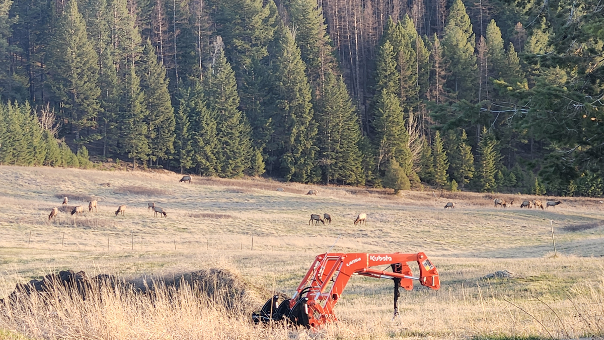

Here's my LA1154 with EA grapple hanging out with some elk.
