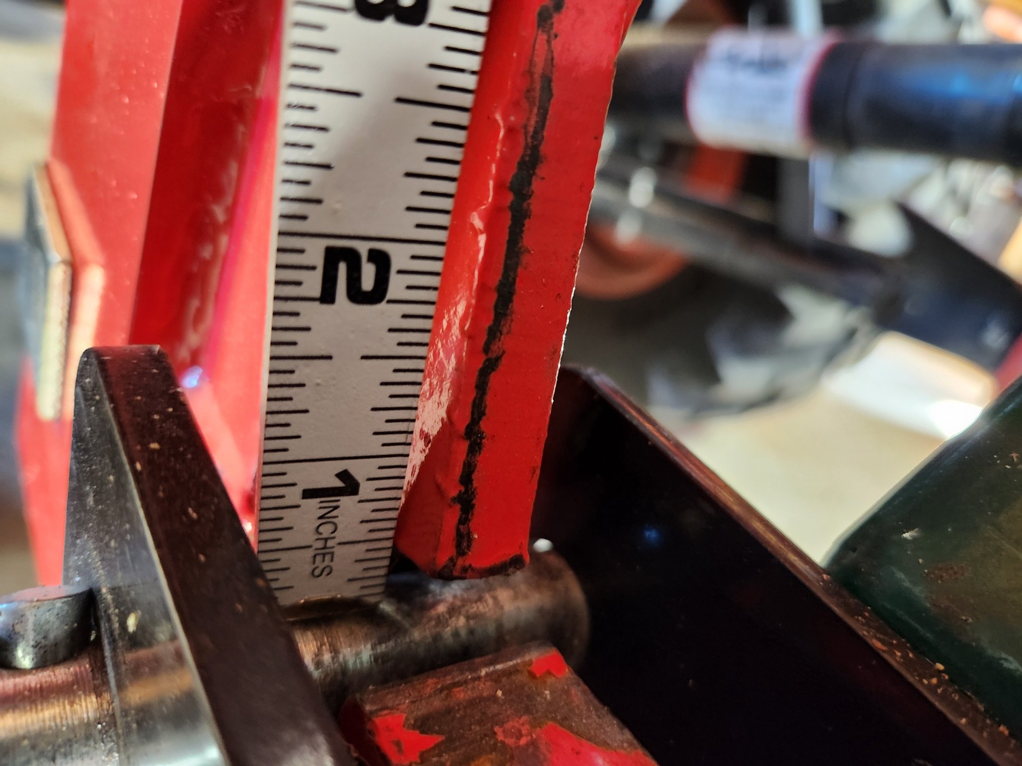

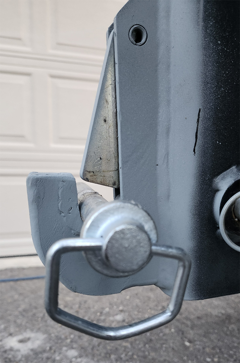

I wonder if he missed the point of my question re the gap. His response confused me to be honest. I made a post the other day about converting the QH15 to a QH16 to avoid needing bushings. Even after starting the conversion, the gap between the lock and the 7/8" pin is the difference between a CAT 3 pin radius and a CAT 1 pin radius i.e. 0.28" or 7.14mm for those north of the border.
I'm going to use the EA land leveler this weekend on the QH15 and see if the gap causes any issues, but I'm sure at some point I'll decided to add some steel to the lock to get a better fit.

I suggest welding some 1/4 thick bar stock to minimize that gap. 30thou would be OK !
Even though I'm 'north of the 49th', I KNOW what .28" is....;)
One huge problem with excessive gap is 'lateral teetertotter' damage..

That's basically what I was thinking. There's enough clearance when the lock is retracted to increase the length of the lock by 1/4". I'll have to drill out the pins that the locks are secured with and use a bolt and nut when reinstalling.
And that was the whole point of this thread i.e the "lateral teetertotter damage". The first photo shows a huge gap between the pin and lock and it seems to me that the implement wouldn't be locked in properly. I get that it's a pain to deal with all of the comments when you put yourself out there as Courtney does, but I would think he'd want his QH to be the best it can be. I think he said they're made in India.
11,324
4,856
it really doesn't matter where they're made, it's WHO designed it ! They should have practical experience in USING the 'device'.

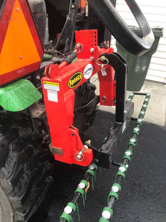

I just took this shot of my speeco. Looks to be about a 3/8" gap. I made sure to have my chipper lifted so it was in the bottom of the cradle.
Thanks for the photo. That looks a lot better than the GWTC variant. I'm heading outside shortly to run the bigger tractor so will get to test out the QH15 conversion.

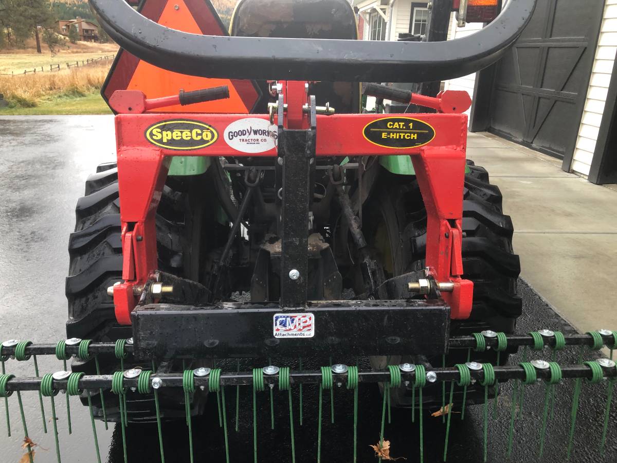

I just saw an add on Craiglist for a Speeco QH being sold locally, and it has a GWTC label on it. :giggle: The seller wants $200 for it and says that it's basically new. My only reason for showing photos from the add is that it looks like there's a "significant" gap between the lock and pin. So perhaps GWTC based their latest design on the Speeco, which they sell.
