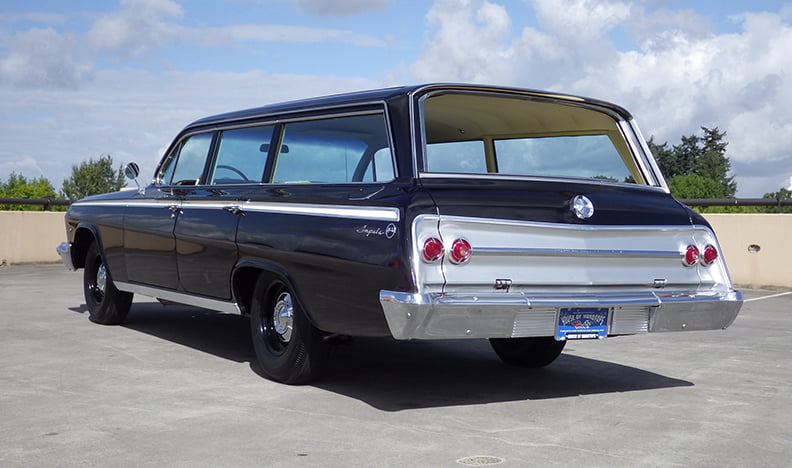

Growing up we had a 62 Impala wagon with a 283/and 3 on the tree.
That's back when a woman could shift a standard transmission AND still throw out her right arm if she had to hit the brakes hard...... so you didn't go through the windshield.... :ROFLMAO:
Dad put dual exhaust on it with el cheapo mufflers...... sounded sweet.
looked kinda like this one.....
