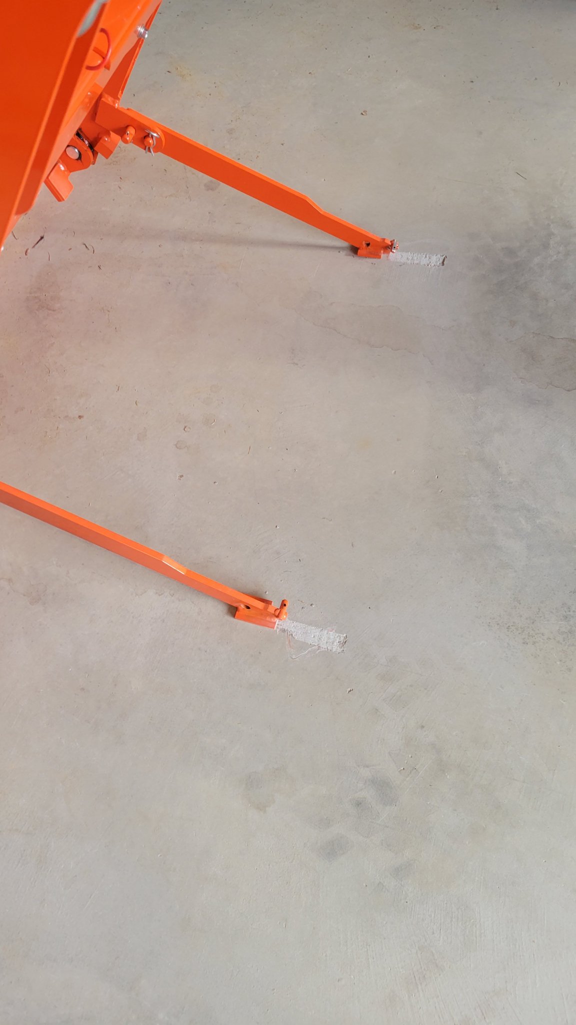

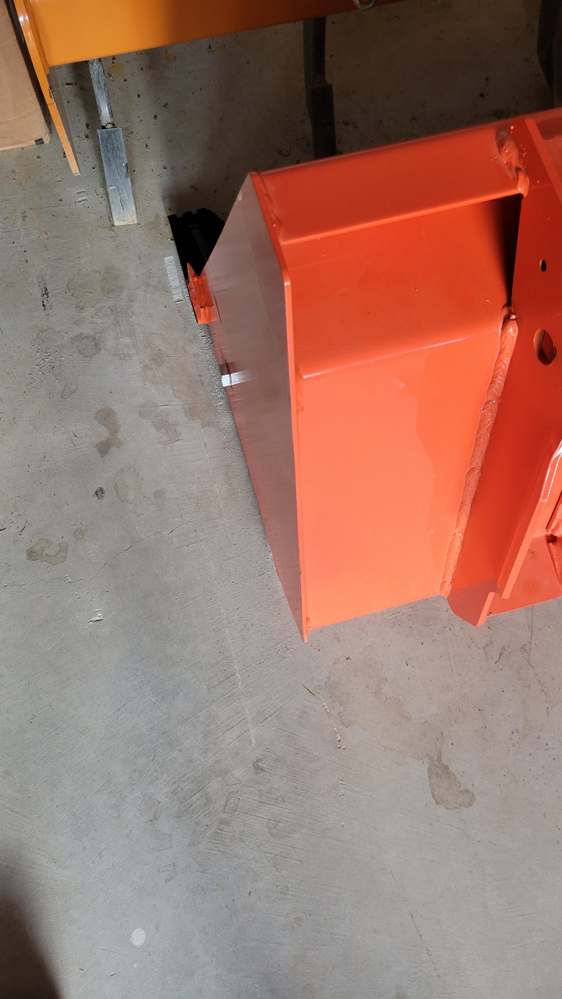

My garage floor is getting beat up from removing and installing the loader (I take it off when I need to mow). Anyone have any suggestions or ideas to prevent further damage?

I just throw down a partial sheet of OSB to protect my floor
I think you want something that lets you slide on.
I hate OSB because the stuff just pulverizes and makes a bigger mess.
3/4 plywood will last longer. MDF might slide better.
1/4 steel plate will work best but will be slippery. A sheet of HDPE will work too.
I generally don't worry about my floors but it looks like your floors are exceptionally soft. Mine don't gouge the way yours does. I occasionally get skid marks but no digging in. Heat spalling is a different story...

You could just leave your loader on.
Or, put down a cheap sheet of masonite. It's hard enough to stay together and cheap enough to be disposable.
However, my shop is not a show piece, so I would just let it ride if it were me.

That's mighty soft concrete ! Is it 'fresh' or how old it is ??
A sheet of MDO ( IF you can get it...) works very well
concrete 'forms' are made of it, as well as outdoor signs...

I use a variety of things, a pair of 2 x 6s go under the back blade when I lower it to park the tractor, furniture dollies to move whole implements around, and rubber stall mats under the FEL bucket and the snow blower when I lower them. Keeps them from rusting on the concrete. If you put the bucket of your FEL on a rubber mat, it probably won't slide and would stop the rests from gouging. Or depending on the size of your loader, two mats would support the whole loader. They are 4 by 6', although I think you can also find 3 by 5. TSC and most farm stores carry them.

Thank you everyone for the suggestions. House was new construction 2 years ago and I was also surprised by how easily it gouged.

Not enough Portland in that slab. Use plywood on the floor.

It's certainly an option but the garage is nice as I can disconnect it and still park the tractor in the same spot to easily reconnect it when needed. Horse stall mats are looking like the winner currently from a price vs performance perspective. I'd love to do the racedeck tiles for the entire floor but I can justify $100 much easier than $2000. That and I can use the extra money for more implements that I don't have any room for!

Greetings, I had that problem with ice chains tearing up garage floor. I went to a gravel pit that had conveyors for moving gravel to different piles and asked if they had any used conveyor belt. They gave 18 inch and 24 inch wide, what ever I wanted for free. I just measured what size I needed and run the tractor along on it, no more floor problems.

THose old conveyor belts have a ton of uses. Setting up on pavement for backhoe use? Piece of conveyor under riggers! park on a dirt floor, now park on conveyor sheets. Shed floor, cover it with conveyor materials. Free is the perfect price!
