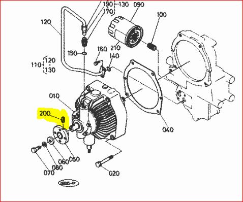

I wouldn't think a few min of the tractor moving around in the back of a truck would do a thing to it as it's a pretty tough tractor.
On the input to the hydrostat pump there is a set screw that keeps the collar from spinning on the shaft, it's 200 on the parts diagram, check that.
Does the lift work well?
If it does then it has a problem beyond the hydro as that is the pump for the hydraulics.

I'll check that set screw. The lift works perfectly, so I guess the hydro pump isn't the issue. Maybe something in the rear end? Or is that part of the hydro? I don't know much about hydrostatic transmissions.

It looks like that set screw is covered so I have no way to check it. No big deal. I changed the oil and filter, changed the hydro unit filter, greased everything, and fired it up. Started mowing and it shut off. Forgot I had the fuel turned off at the fuel filter. After that it would start and then shut off right away. Tried bleeding it through the bleeder screws and it didn't help. Cleaned the sediment bowl and filter and filled the bowl with fresh fuel, opened the injectors, and tried bleeding again. Now I'm not getting fuel at all. Tractors and I just do not get along...
