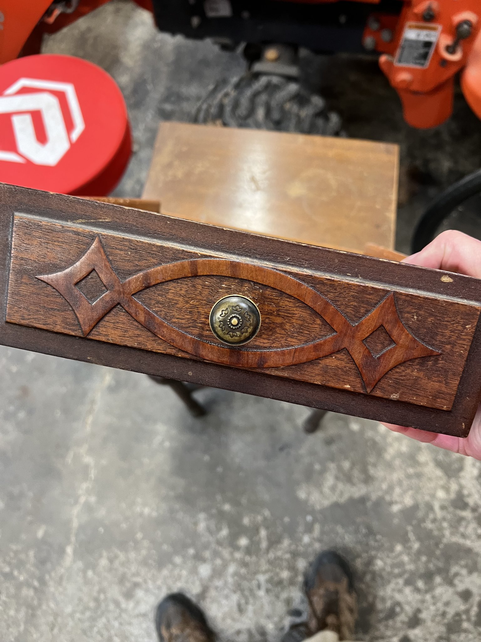

Not a major project by any means. Always liked this little table.
I think mahogany top. Drawer looks mahogany with a black walnut accent.
Don't really want to strip and refinish fluted legs, edge banding, etc. At 100 +/- years old, likely a shellac or varnish finish.
Will likely just use a walnut colored "restoration" product to smooth colors and cover scratches on all surfaces except the top.

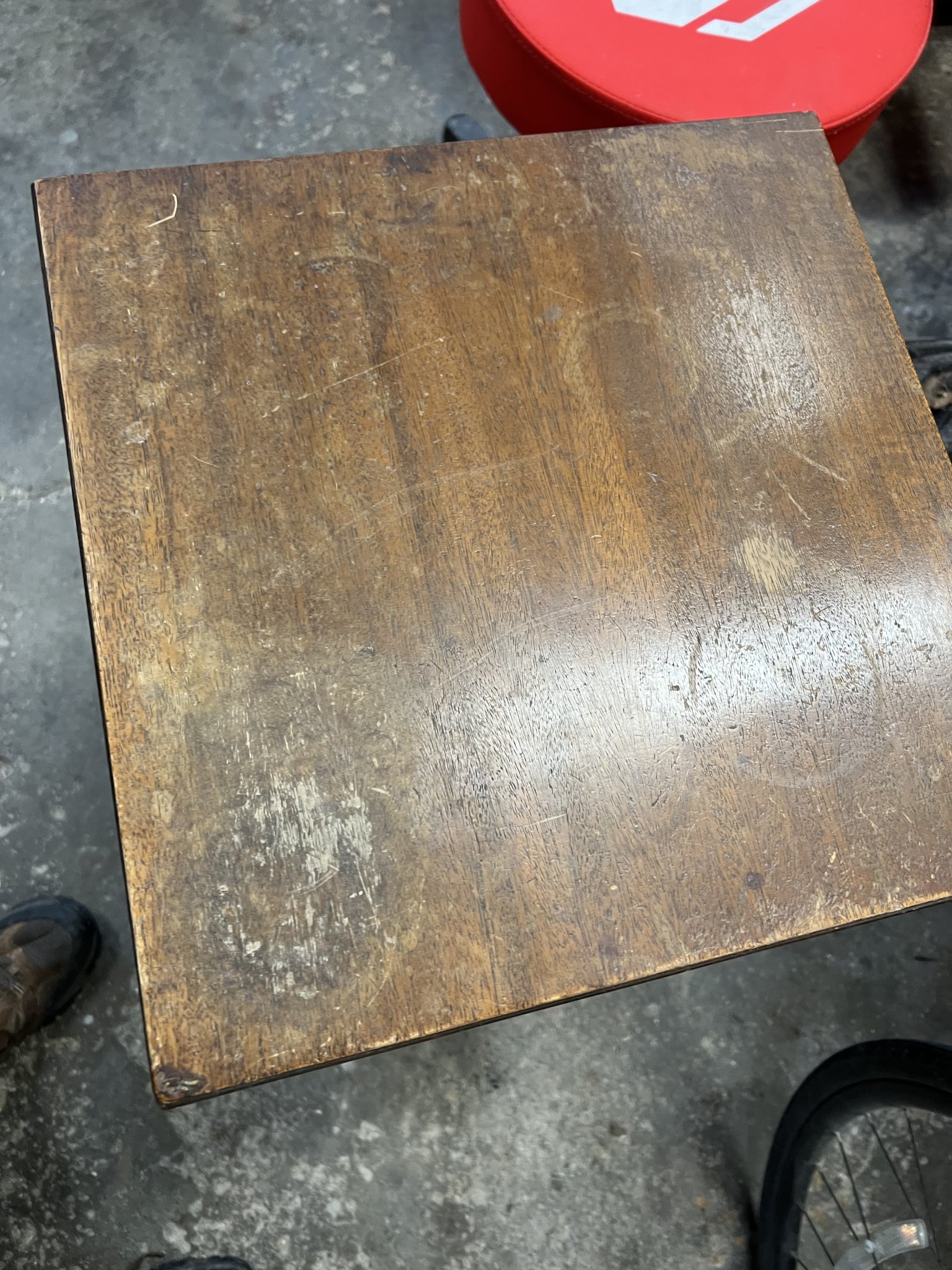

Top will be sanded with steel wool and have a dose of clear satin polyurethane. Leave natural color.
The Mrs. said I did something to the top 20 years ago. Don't recall what I did. Might have been no more than Lemon Oil - don't recall.

I dribbled some of the Howard Mahogany on the top, so that got stained too. Not a bad thing.
Noticed corner of the mahogany top delaminated. Of course, all my wood glue was hardened up….

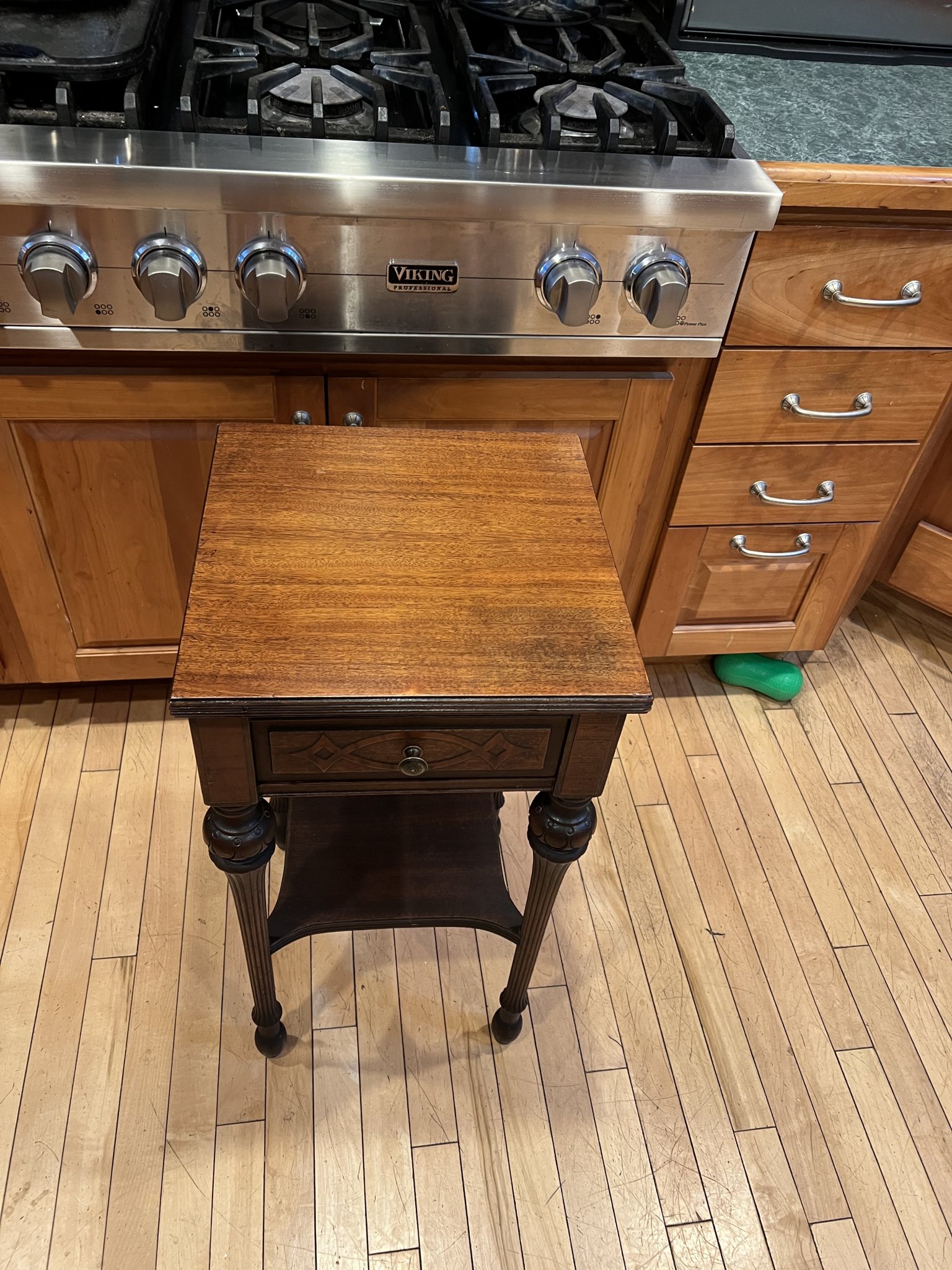

Came out pretty well. Far from perfect, but much better than before. Can still see the water spot, but I’m okay as is.
Like the Howard product.
Spray poly didn’t lay down real smooth, but it was low-50”s here. Warmer would have been better.
Buffed it with a scotch bright pad. Pretty smooth, but more wouldn’t hurt.
