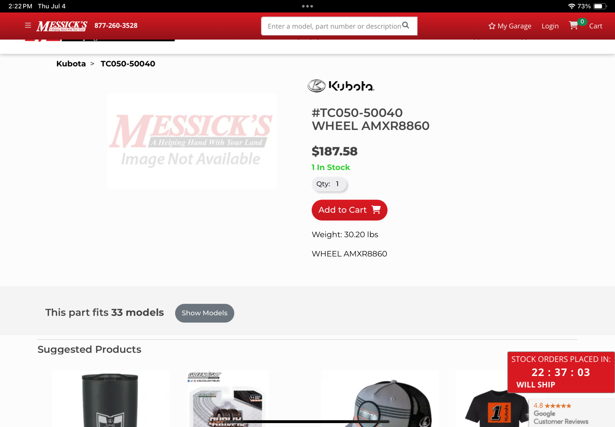

Make sure about the size the online parts show a different size
Some sites show availability around the $200 level

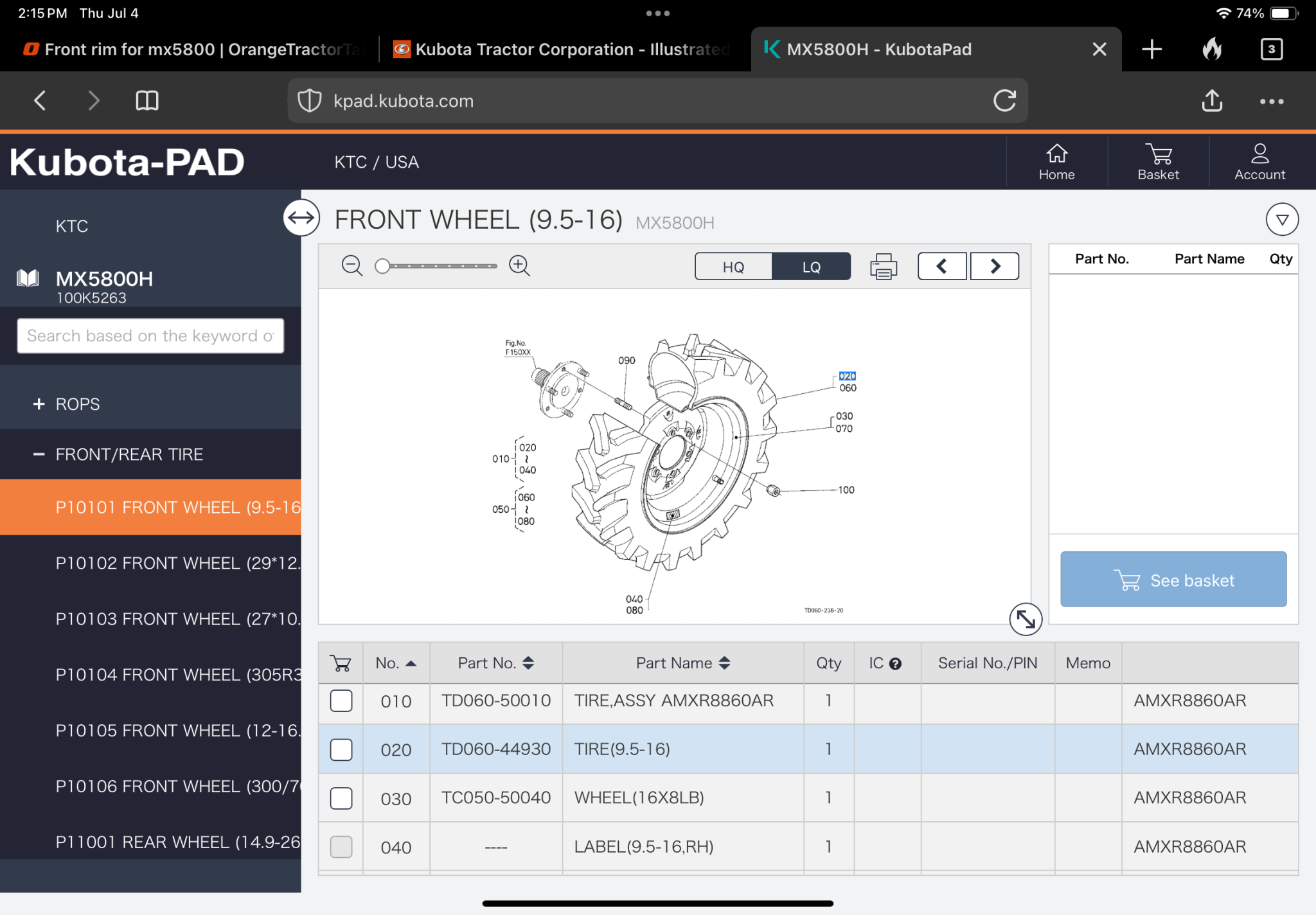

unfortunately kubota disco'ed this particular rim design so my only option is to find a used one or a dealer with old stock kicking around.
My local dealer brought in what he was told was a direct replacement, but it's not the same offset and now the tire bottoms out at full lock against the loader mounting arm.
The 16x9.75 dimension is stamped right on the rim. I tried the Carlisle site, but since these rims were made under a contract for kubota, they dont list them so I'm SOL

What is the part number your dealer ordered in? Kubota site list this;
WHEEL(16.5X9.75)
TC050-00790
for the R4 tire. Russell posted the AG tire version.
Looking again, this wheel shows holes for weights I'd guess. Not a solid face like your picture.
