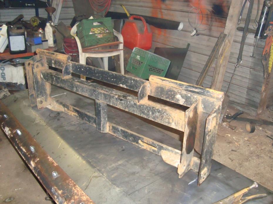

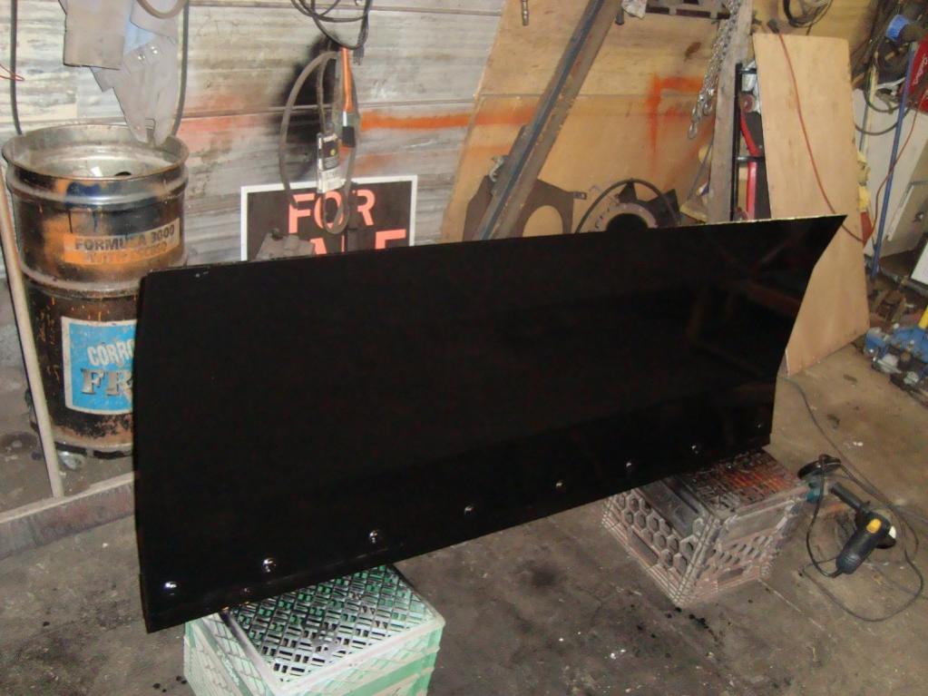

Latest project is a fel mounted blade for snow. This is just a very simple blade, it does not angle. The loader is off of my old B7200 and I just don't think it is strong enough to take that kind of pressure. Also the quick attach plate is not heavy enough. The reason I am building this is because the bucket is 48 in and the tractor is 51 in wide. Very annoying when I am pushing snow. Anyway here nare some pics.:D dusty

Have you pushing forward yet?
Mine is working good too. but I have a long distance to push the snow.
so it always leaves wind row.
So, I'm thinking to put wings on each end to carry snow all the way.
and here are some questions;
1. Should I make the wing in 90 degree? or 45 degree in angle?
2. How big wing should I build?
3. Should I make multi-angle adjustable?
4. Should I make in square? or a half moon shape?
5. I want it to detachable wing too but what do you think?
I have 6' snow blade.
Thank you.

Ya Greg I wasn't real happy with the color scheme either but Kubo orange was 20 miles away so it got painted black. Joe, multi angle adjustable for sure. If you are going to the trouble of building extensions you might as well get as much versatility as possible. As far as them being removable that should not be a problem, just have them hinging on one long pin with a mechanical adjuster for angle. Thanks for the responses. :D dusty

Thanks JB. We haven't had much snow either. I have been out 5 or 6 times. But nothing really heavy. I haven't had a chance to use the blade much. It actually tips forward enough that I can use the top of the blade to pull snow away from tight spots. I didn't plan it that way but thats how it turned out. I really like building things and seeing how other people do things really helps.:Ddusty
