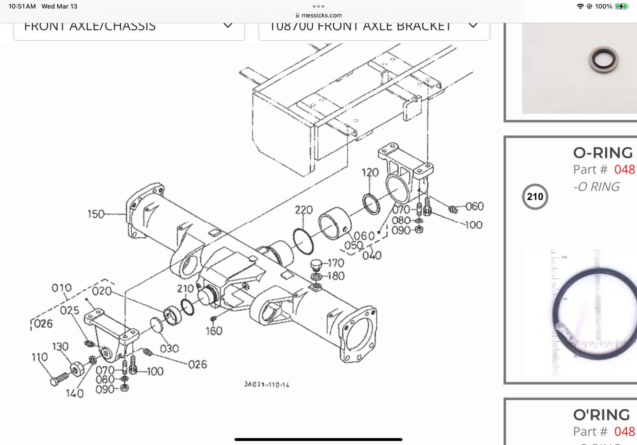

My circa ‘96 M4700DT “Front Axle Bracket” and “Bushing”…. are not greaseable…. despite the Owner‘s Manual lubrication instructions and depicted Zerk/Grease-fitting….none exists on my bracket.
Research tells me I have an “early” bracket…which was superseded later with the greaseable type.

Kubota wants $290 for just the bracket and I have drills and taps.
The Messicks parts diagram offers “tips” from users on how to accomplish REPLACEMENT of the bushing. If I do this and the bushing is not worn-out, I plan to include drilling a grease-hole thru the existing bushing.
But the “Tips” state: “Need a sharp flat chisel and hammer for removal of the old one. Jack up tractor and put stands under it and get ratchet straps to put on the differential to suspend it. Will need to remove coupling on the drive shaft and remove drive shaft and unbolt the housing of the bushing”

Items (10) and (20) are the parts being addressed. The replacement/superseded front bracket (10) is indicated in this illustration…. my earlier bracket has no grease-zerk or plug (items 25 & 26)

If you'll notice on each bracket is two bolts and two studs. The driveline must be removed to drop the axle down to remove the brackets. There's no reason you can't drill and tap the original bracket. I have had better luck using a die grinder to cut the old bushing out for replacement.

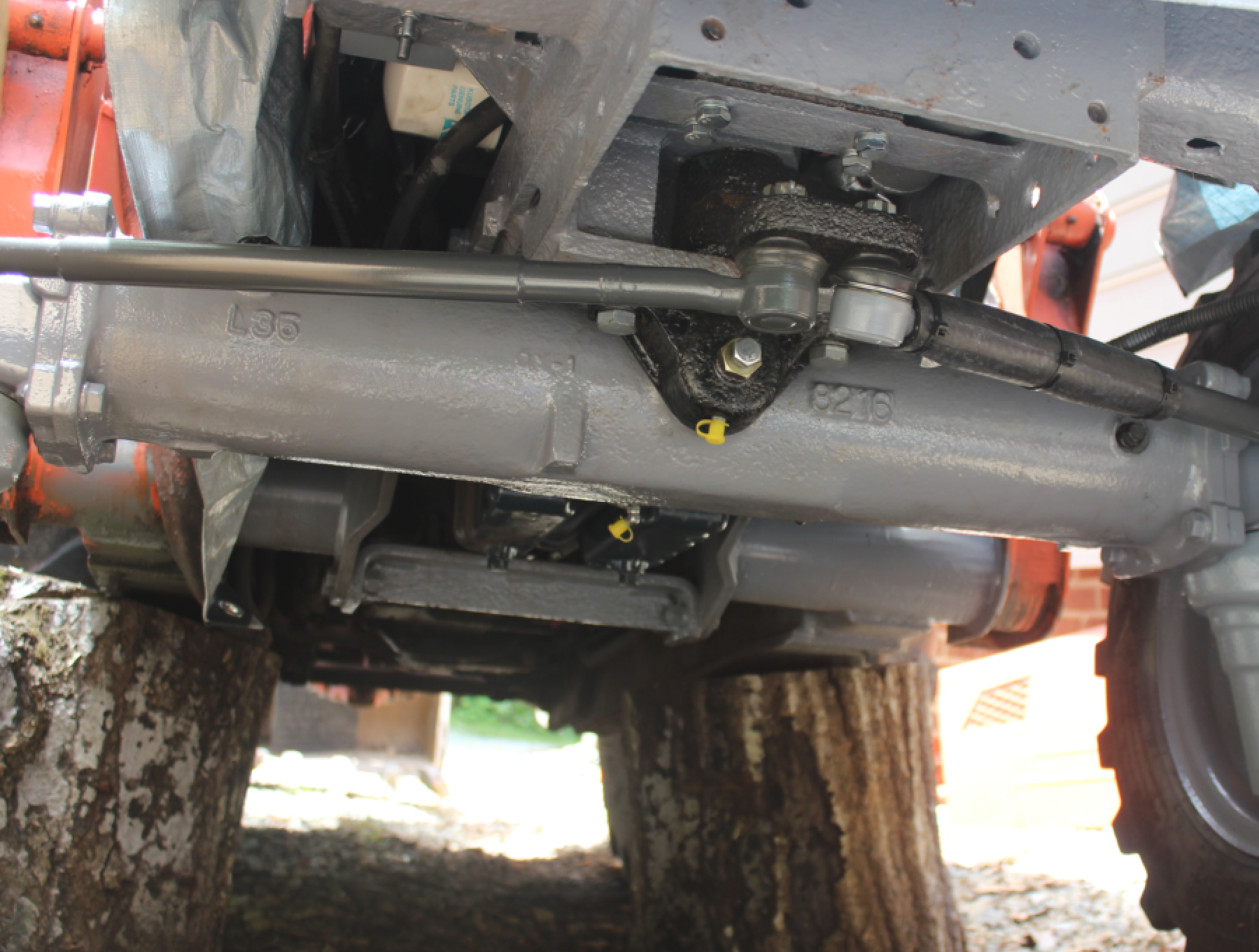

The axle is supported by both the front and rear bosses (parts 20 and 040) therefore you can't support the axle with jack stands and remove the front boss unless you had a way to lower and lift the axle just enough to do that. And then as mentioned the FWD shaft is certainly a factor.
After I removed the FWD shaft, I had a crane system attached to both sides of the axle to hold it up and lower it down gradually and slowly. That axle weighs a ton.
Removing the wheels makes it a lot easier and lots lighter.
When I started the L35 restoration, the bushings were all bad, rusty and the grease fittings gone.
I ended up cleaning the bosses and redrilling/tapping for a grease fitting.
Note the fancy stands I used to hold the tractor off the front wheels after using the bucket to lift the front wheels!
(Of course since my job was a restoration, I did remove the entire axle for cleaning and such.)
