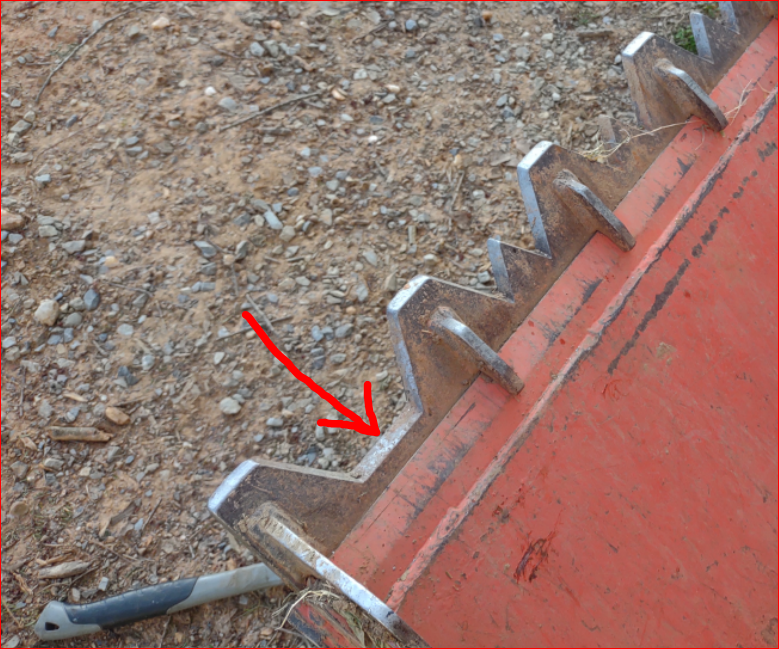

1st problem they would NOT bolt nicely over my piranha tooth bar - and o hell no I am not taking it off every time, way to lazy for that!

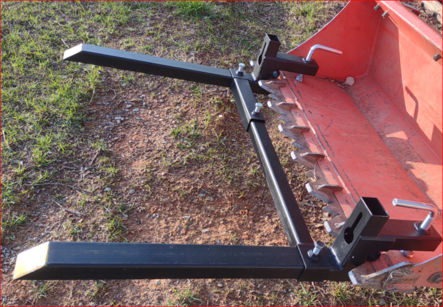

2nd - the cross member that comes with it - is very short, did I say short? Yeah like short as __ __ __ __
So - my youngest son is a welder - he cut off the cross bar and added a piece that was a good bit longer!!! That took care of problem #2!
On the original piranha tooth bar there is a "flat" spot at the two ends of the bucket - the clamps bolt in there rather nicely I might add!
With the added cross bar extension it seemed like it would work well.
Forks in place :
Working forks:
Are the super heavy duty? Naw ........ seem pretty tough however
Are they super long? Nope - not long
Can I pick up 500 pounds - nope not even close
Can I pick up 300+ pounds - maybe!
Can I do it all from the seat without me getting off the tractor? Ooooooo yeah

I would think the forks would fit between the spaces on the tooth bar, maybe just set quite as far deep for adjustment. Width of forks may not be important if you're just picking up material as you show.
