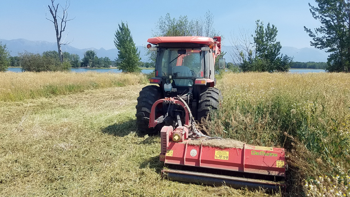

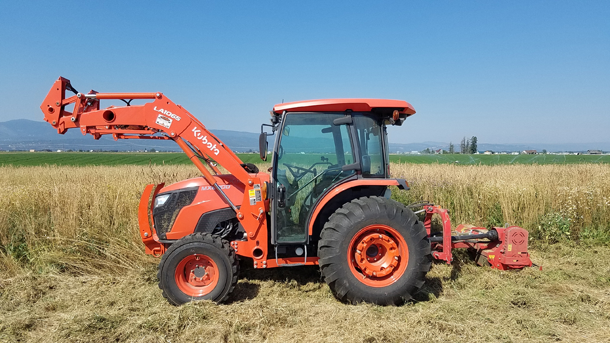

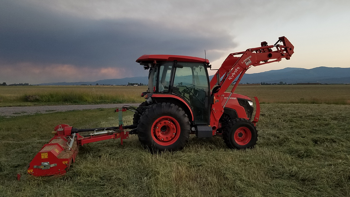

Last summer I ran the Del Morino Centurion Super 158 flail with the front loader attached minus the bucket which is something like 400lb. The Del Morino is an hydraulic offset flail and at 820lb there's a fair amount of weight out back so I wanted some weight up front. This spring I plan on making a suitcase weight mounting bracket similar to the one I bought for the M6060 since I now have over 1,000lb of weights that I can use on either tractor. It'll be nice not having to drive around with the loader arms up in the air.
I really enjoy cutting fields like the one shown below. I'm thinking of advertising my services this year with the MX and M running either the flail or Land Pride RCR1884. Eventually I'd like to get a bigger flail for the M.
