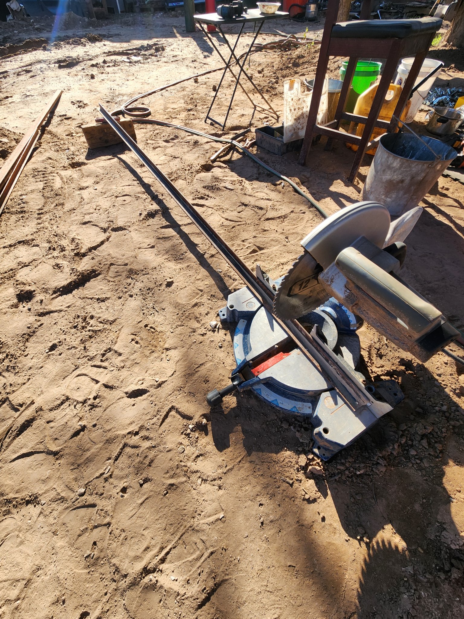

Start with your biggest problem

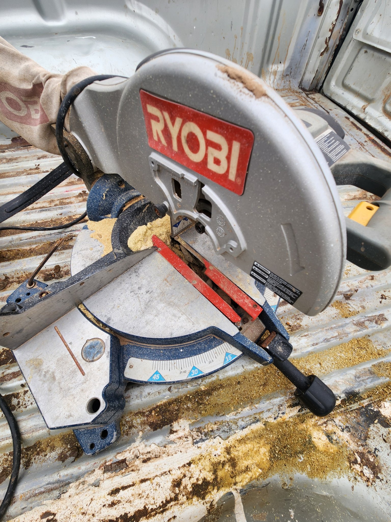

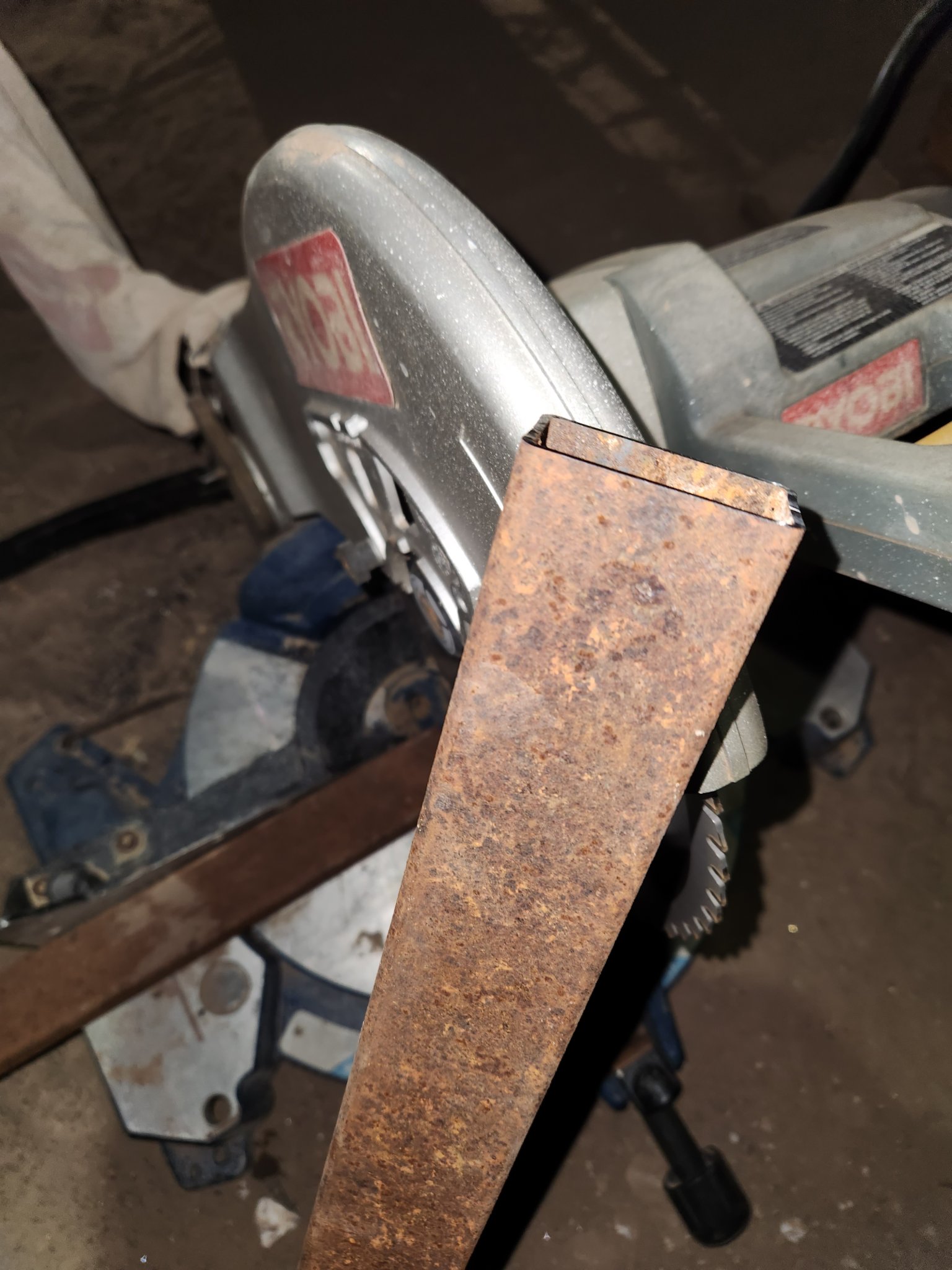

This is your wood cutting blade for your miter saw
Take this with you and get you a steel cutting blade
Goal: use miter saw to cut your steel way better than using a cut off disc on grinder

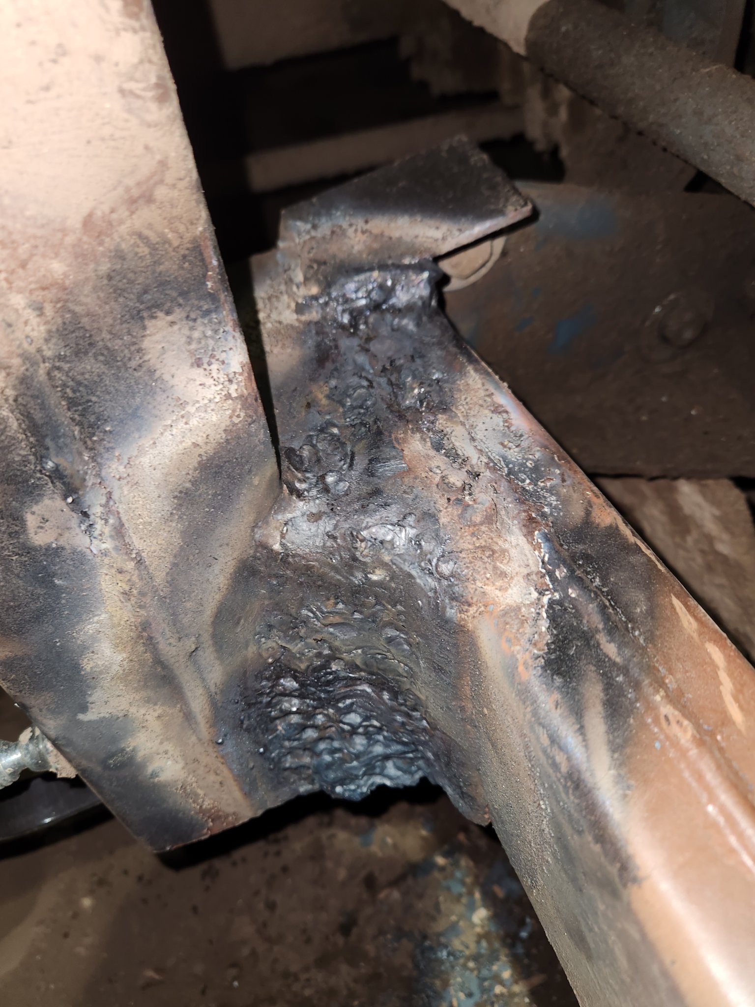

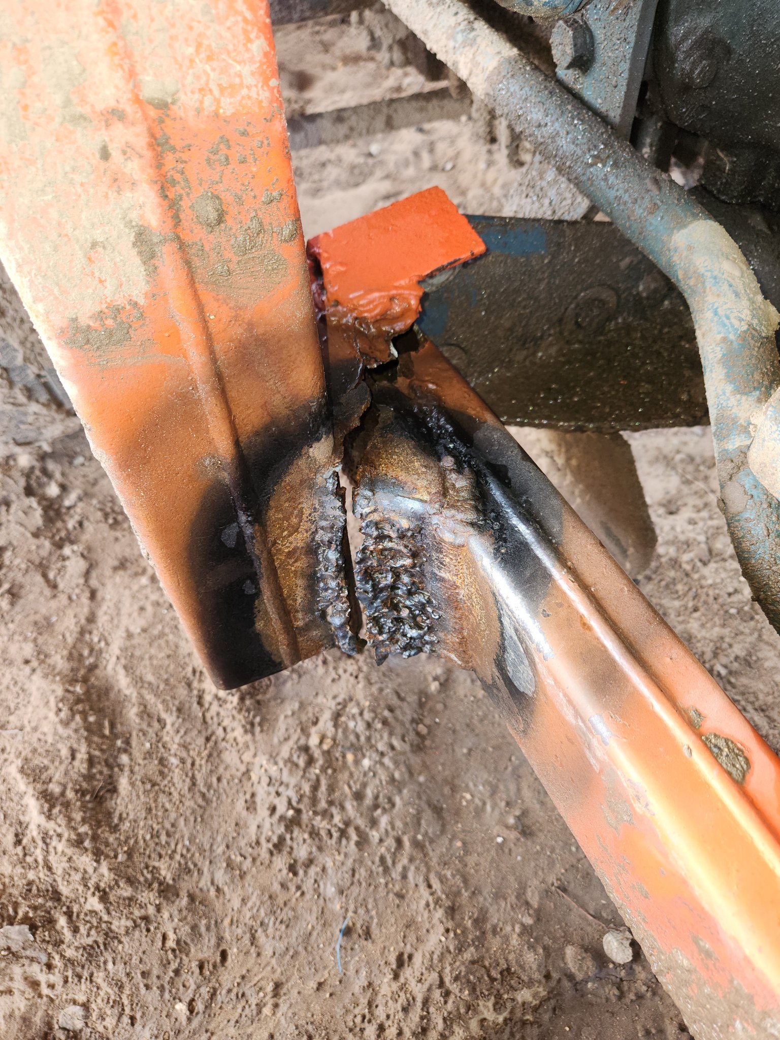

Your biggest problem is the big broken weld that hold your loader together
Plan: use miter saw to cut the 2 inch square tubing at 45 angles and weld on with big big flame
In the diagram you see 2 broken entity, and your 2 inch square tubing cut at 45 degree holding them together
Put your $65 metal cutting blade on your miter saw in the parking lot in case it didn't fit

Usually steel cutting blades are rated for lower rpm then a standard miter saw turns requiring a low speed saw like evolution makes. I have 3 cold cut saws and they cut good but are 1/2 the rpm of a wood cutting saw. Be careful of any recycled steel that has a hardness because it will destroy the blade instantly. I destroyed a blade trying to cut angle iron from a bedframe that was hardened.
L35
Jun 13, 2010
629
656
CT
When I first saw that saw blade I for sure thought it was going to become one with the tractor.

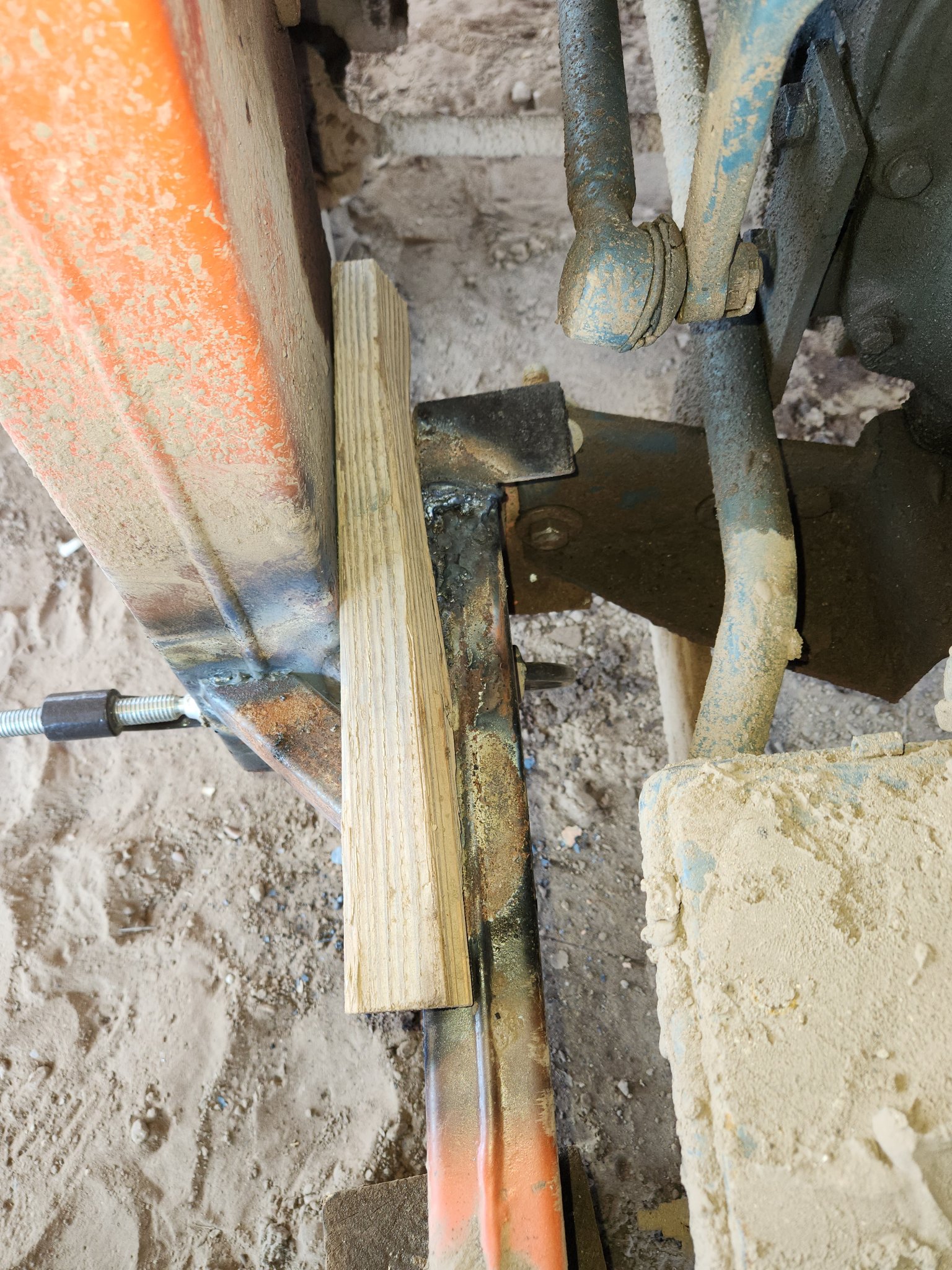

metal work
top part of big broken weld turn to molten
pump you ton of gas
measure your cut
cut it straight
twist miter 45 degree, cut your angles
square tubing fling across your shop
mock it up, grind down the ridge on the big steel support so your metal lay flat
tie your metal with household 14 gauge wire, then
weld the end well, then make another 6 inch support, weld that on bottom
weld both side square tube
left side weld nice, right side musta shift away from rail making worse weld

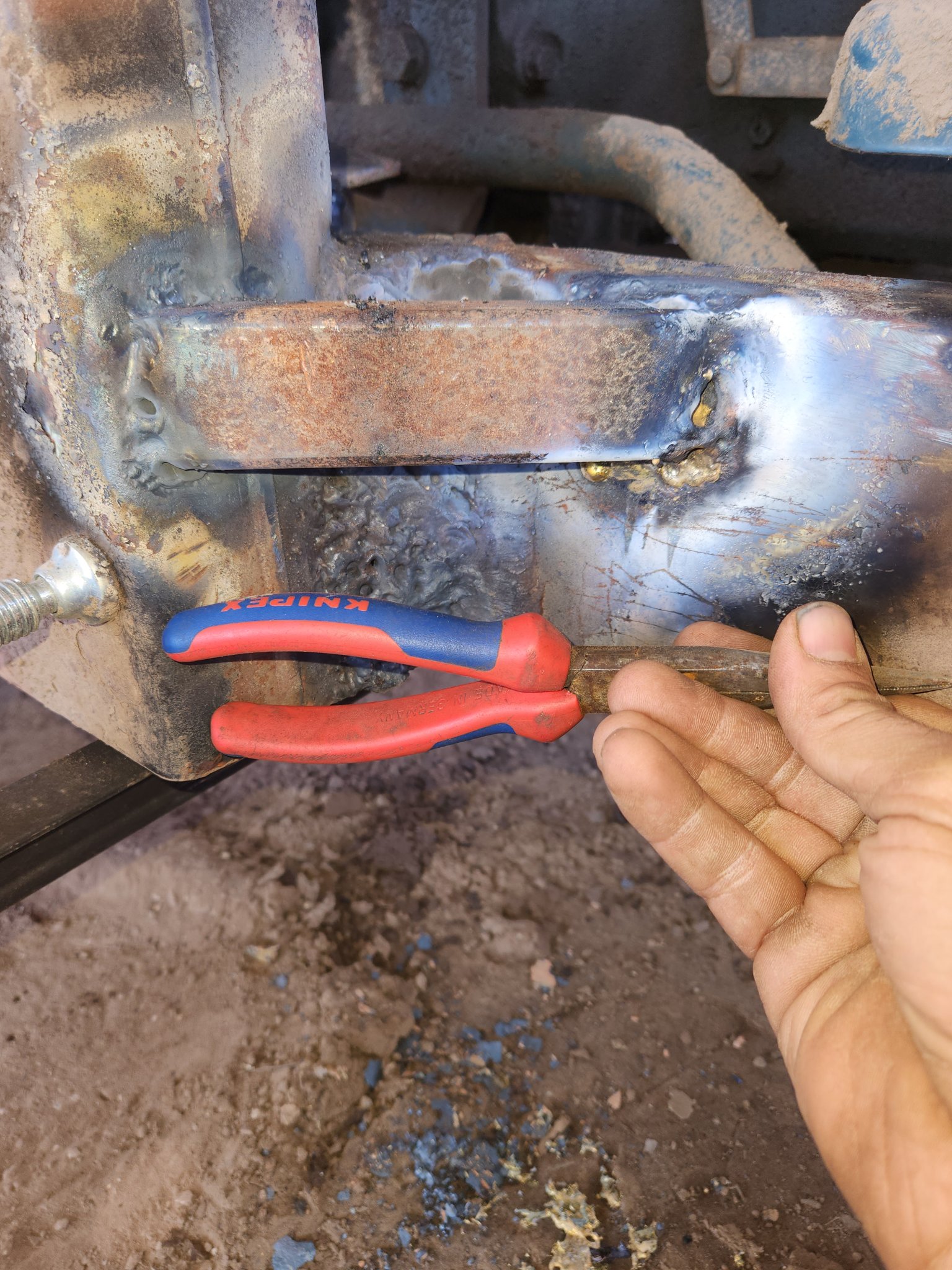

mistake: don't point the big flame on the square tubing, it will rip right through it
if the square tubing sitting flush on thick steel, and you point flame on thick steel, it will melt square tubing into the thick steel properly (left weld in previous picture)
you tried using the bronze as filler rod on the square tubing, it melt into liquid so easy, it hard to get it to flow into the thick steel
adjustment: use actual nail as filler rod, it doesn't turn to liquid as quick and can get successfully flow to your thick steel and encompass your square tubing
this trick with square tubing being cut at 45 degree, if it hold, will be very useful trick in your arsenal
plan: keep chipping away at the task in order of severity
start by using filler on your first square tubing and melt it with big support into your steel structures
then get your 2nd square tubing melted into the bottom for even more support
then: cut you a thick angle iron, about 2-3 inches, and put that 90 (where you showed that dinky bracket) that would hold together you 2 broken entity very strongly
that should be enough welding for that area hopefully
don't move too quickly, be comprehensive in your securing of your big broken steel intersection

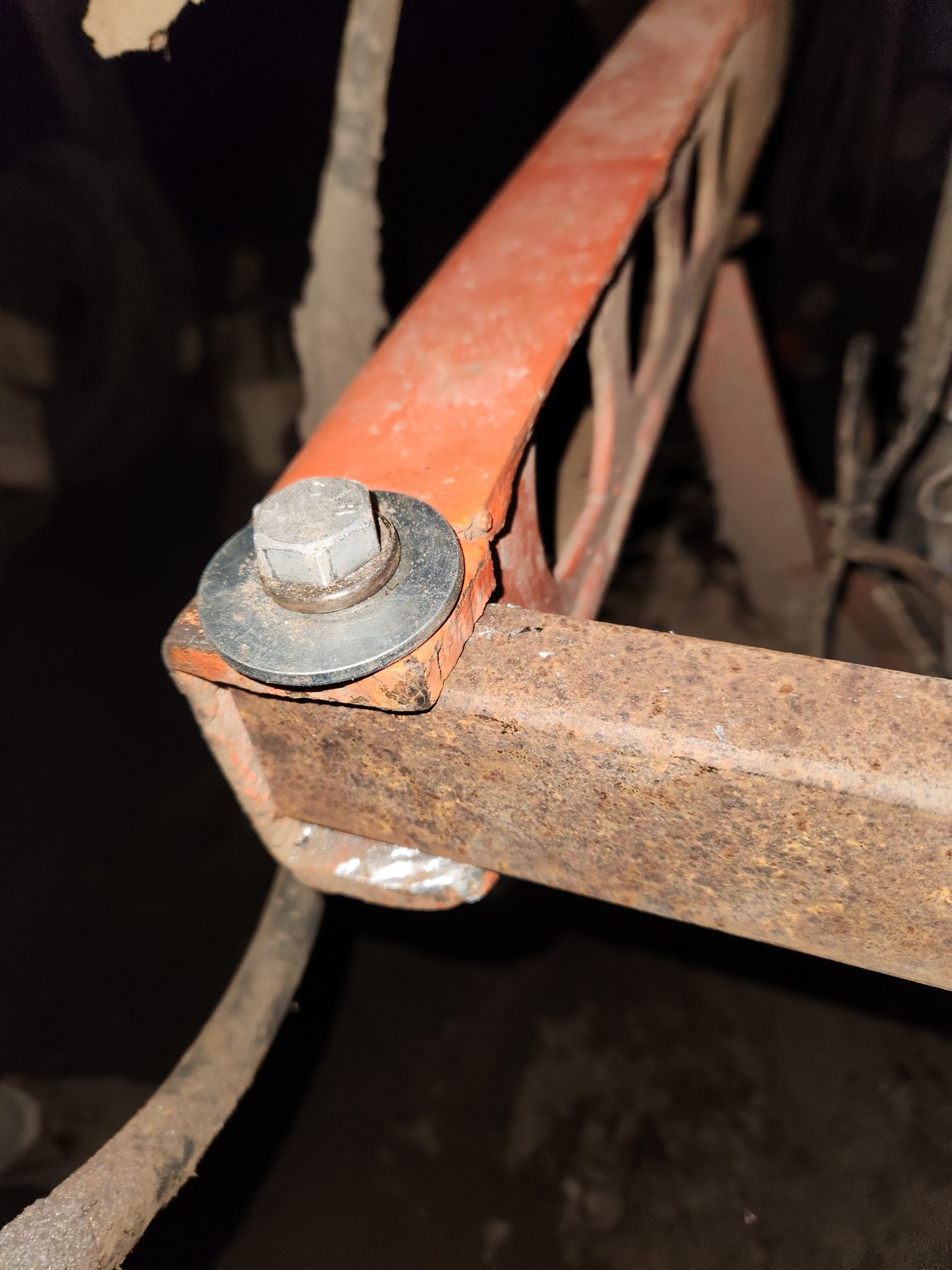

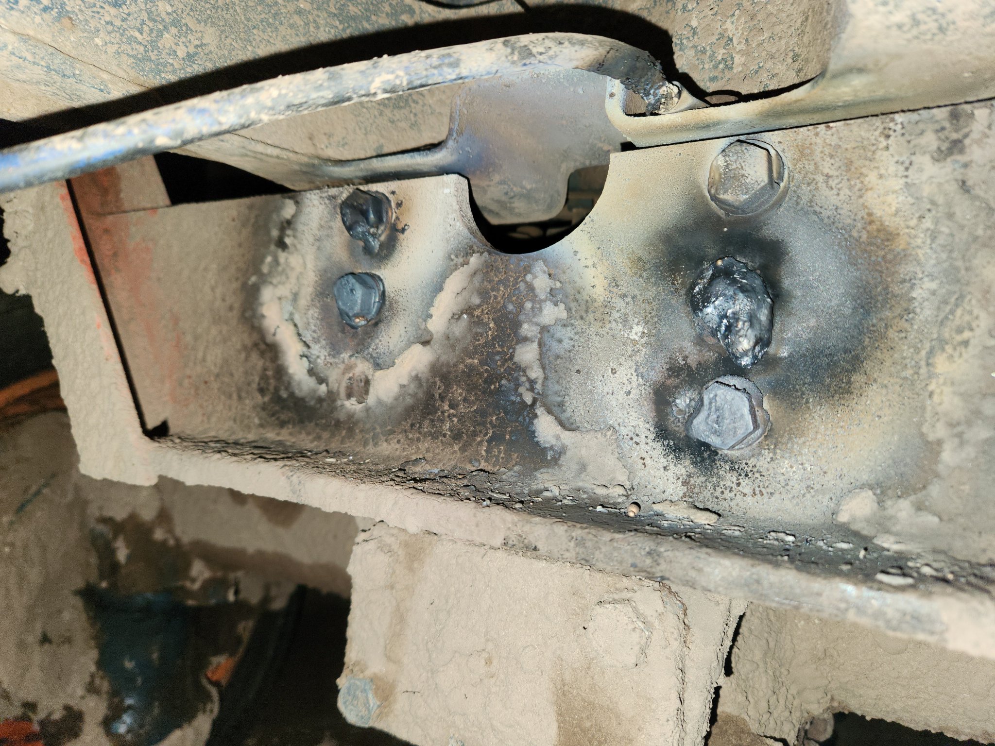

it keep busting the bolts that hold your loader to the tractor at the front axle, there are 4 bolts there out of 6, fasten them tight, then melt bronze on top of bolt onto the plate its securing, that way bolt cannot loosen
then if you get that far:
tackle on the busted fel valve that keep breaking, escalate your effort, get away from welding it, try putting holes in and using bolts to secure it in multiple place
that should be enough planning for now
front support that keep busting bolt
you can see 2 bolt bust out, and others are loose
they did have thread lock on them
hole form there because: no filler, pointing flame at square tubing
put you another square tubing right there

the upper support where you'll connect the two beams
clamp square tubing tight to the steel, and you got your thick random steel to use as filler
your random filler work great
little trick at the end: lower your oxygen, give it big acetylene flame slow leveling out your molten
there are better ways to keep a nut from backing out. Lock washer, nyloc nut, double nut, peening the threads slightly, etc. I doubt "breaking of the bolts" is caused by loosening, especially if you are only using 4 of the 6 that are supposed to be used. That is 66% of what was engineered. Also using the highest grade bolt available will minimize breakage. I know. I know, talking to a brick wall.
Chanceywd
Mar 26, 2021
731
675
central ny
Heating that bolt to braze it is ruining it's strength and it's torque from when originally tightened too.
Goes from a tight maybe grade 5 to a loose less then grade 2 ?
At least in my mind not something I would do when there is so many better ways to lock a nut as you say.

front support problem:
all the bolts were loose, 2 of them stripped, one you cannot get into the hole
dab it in diesel, hit with front facing poly wheel, hit with compress air, brush with solvent, hit with air
melt your bolt into its plate so it cannot come out

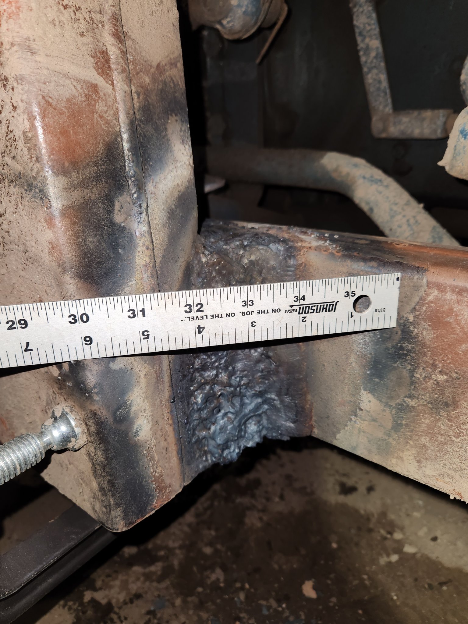

measurement about 27.5 inch
maybe: cut you a 2 inch square tube, put holes into square tube, put bolt that go completely through the rail and your square tube
take you awhile to melt your bolts onto the thick steel it hold
now: get a perfect measurement of the square tubing to connect the two rail
cut it a bit big, then you can grind down and make it fit super snug
then, drill you out big holes, put you big bolts hold your machine tight

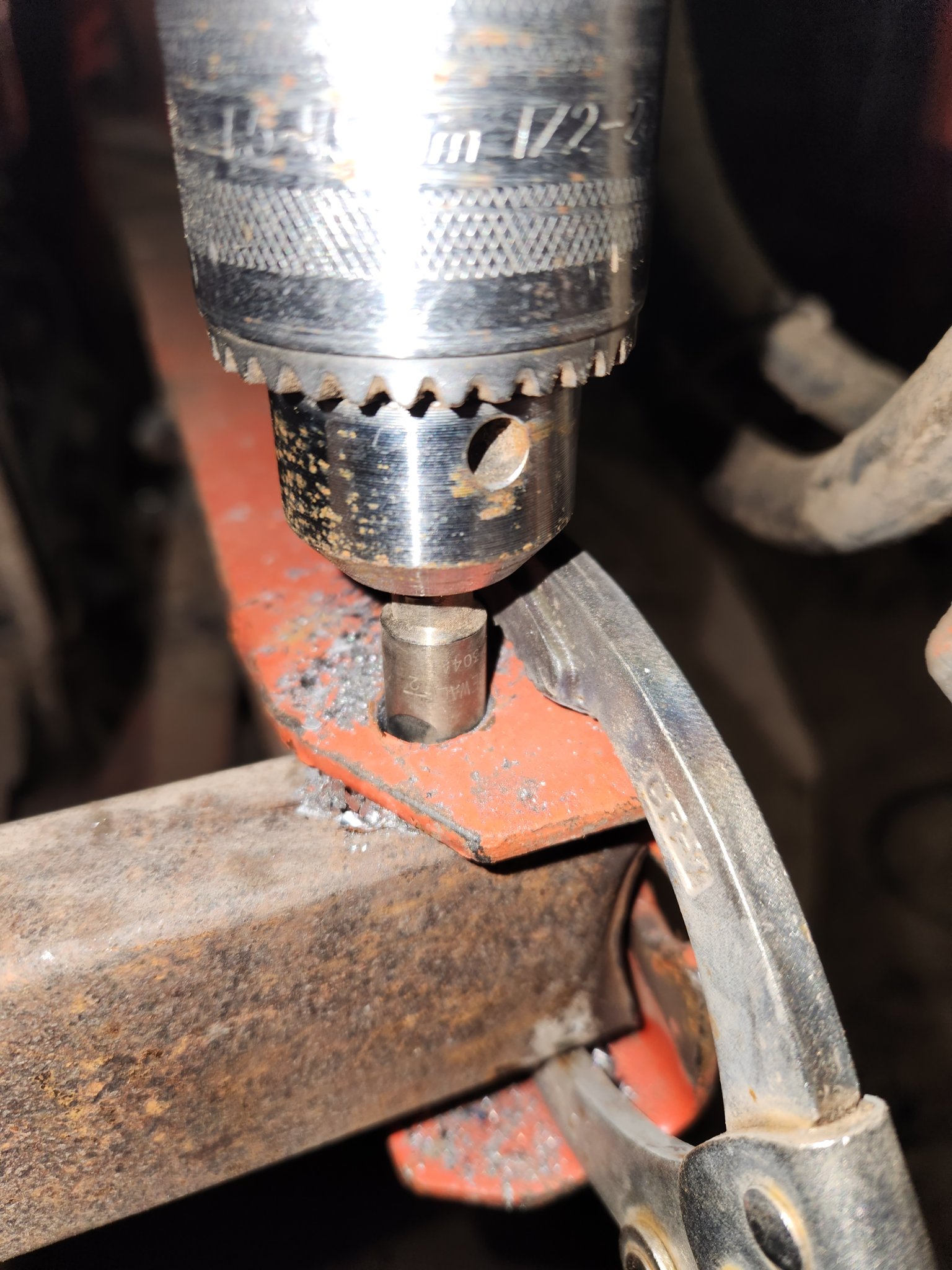

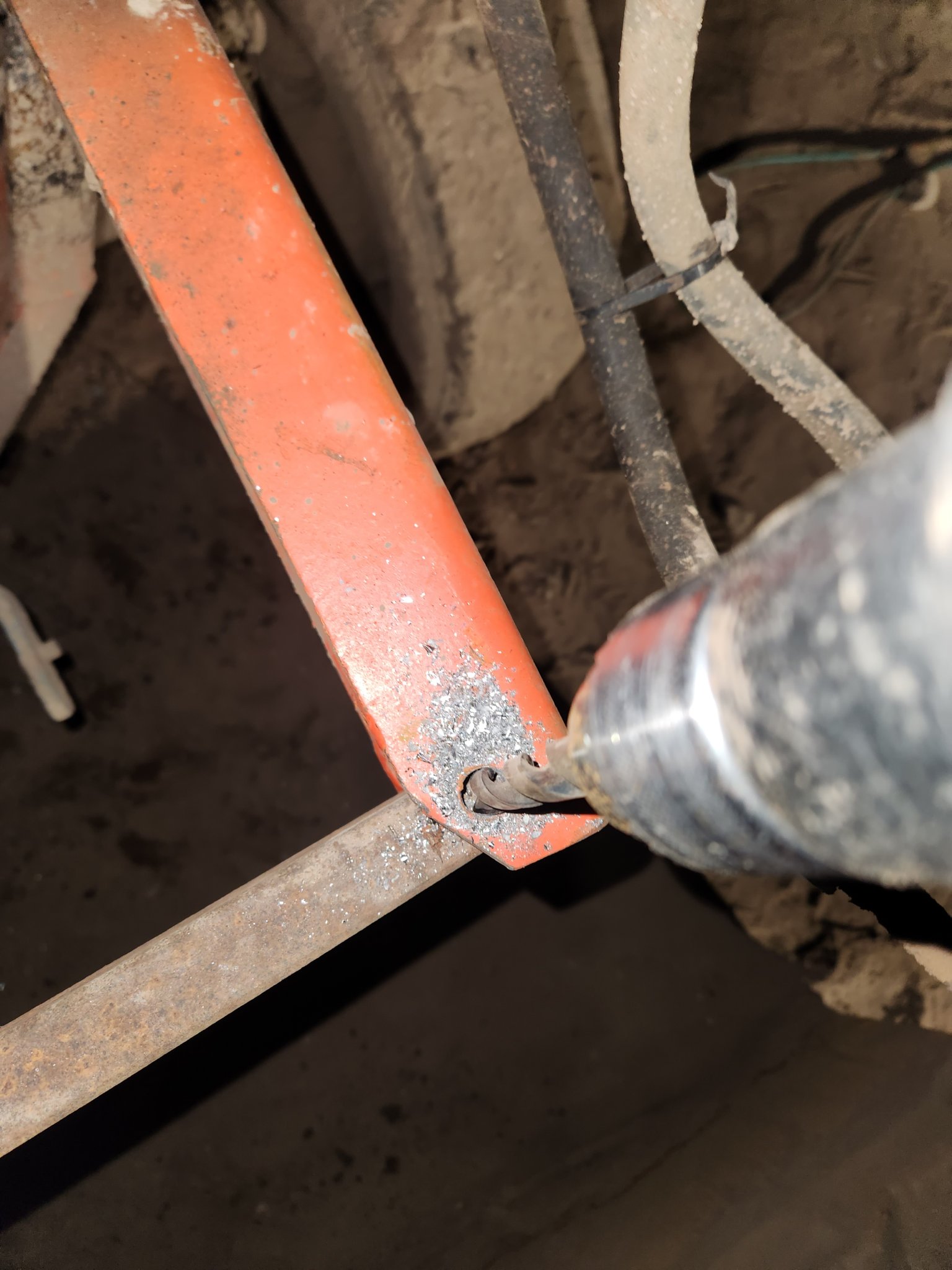

now: get you a good drill bit, drill you out holes, put you bolt tight, add spacer if needed
drill out your hole
get your big bolt in, glue on the thread
bolt glued tight
drill out 2nd hole, took awhile
clamp square tubing tight, drill more
put another nut on the inside, you couldnt find a good way to put solid spacer
