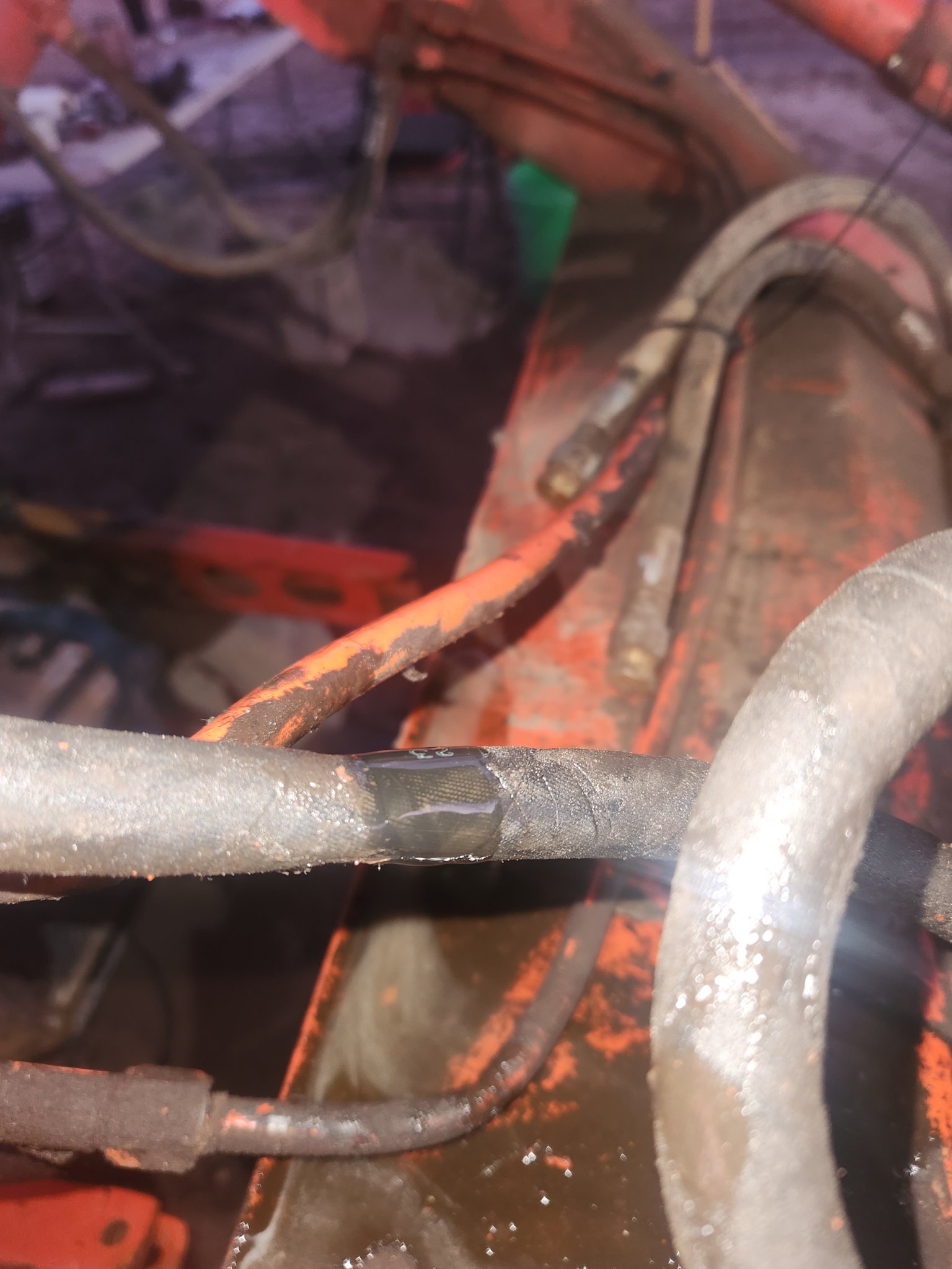

your busted cylinder even come apart because you bust that long rod that hold it together when you took it apart aggressively
you melt 2 household bracket hoping your fel valve stop coming apart
because your an idiot riding your robot with the exhaust hanging, putting all weight on manifold,
your magic trick bust and is causing fume to disturb your peace when riding your robot, conduct you magic
the $57 dollar rebuild kit for your cylinder, you are grateful it come with locking rod since you busted all yours trying to remove them

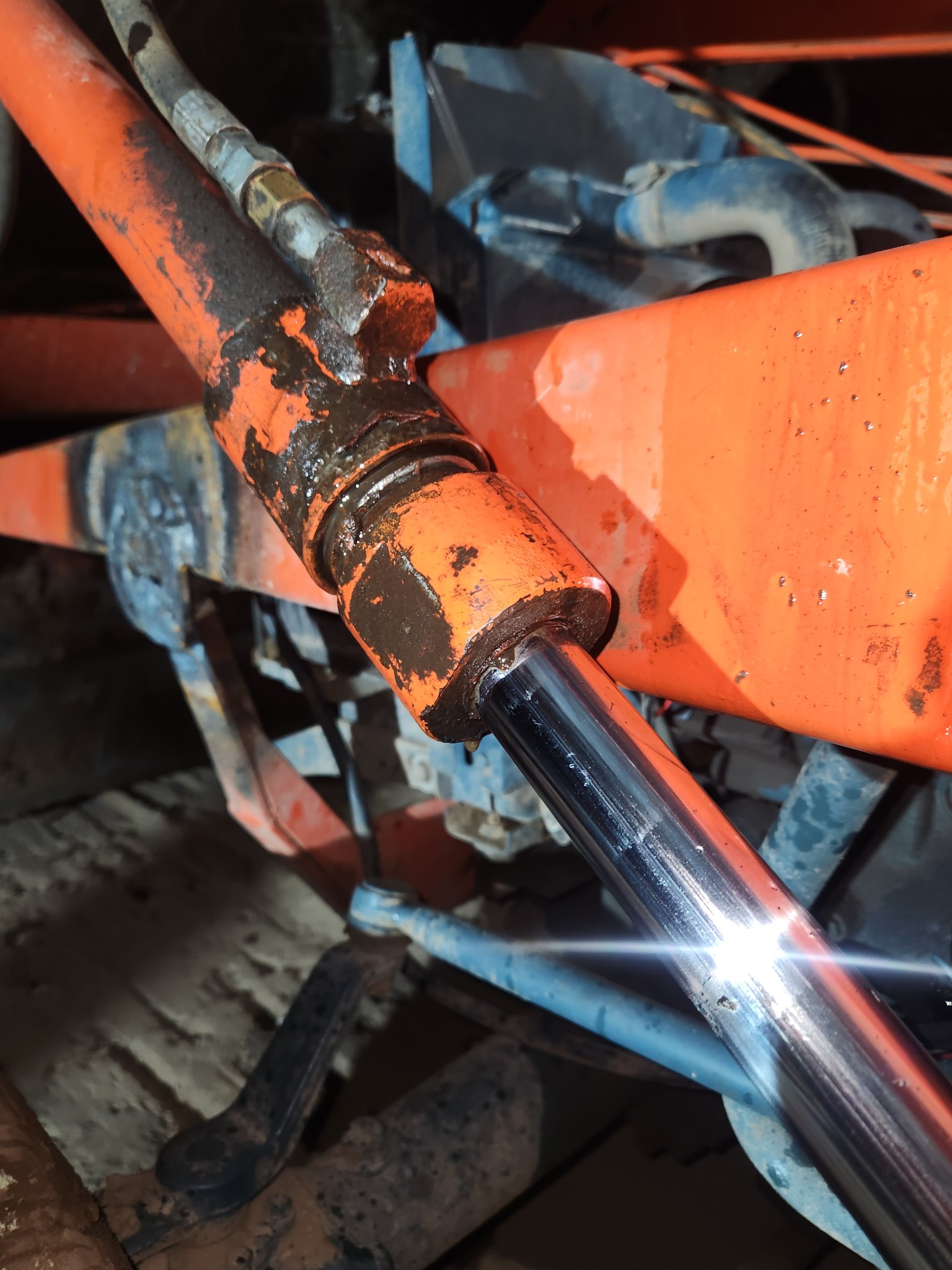

show you easy way to take apart your cylinder head:
put the pin in secure it to bucket, use you a big ol pipe wrench to take apart your cylinder head
you mighta put those packing seal backward but they went in way easier the way you see in photo
give it a shot, you used all your seals on that cylinder, you might need another kit for the next one

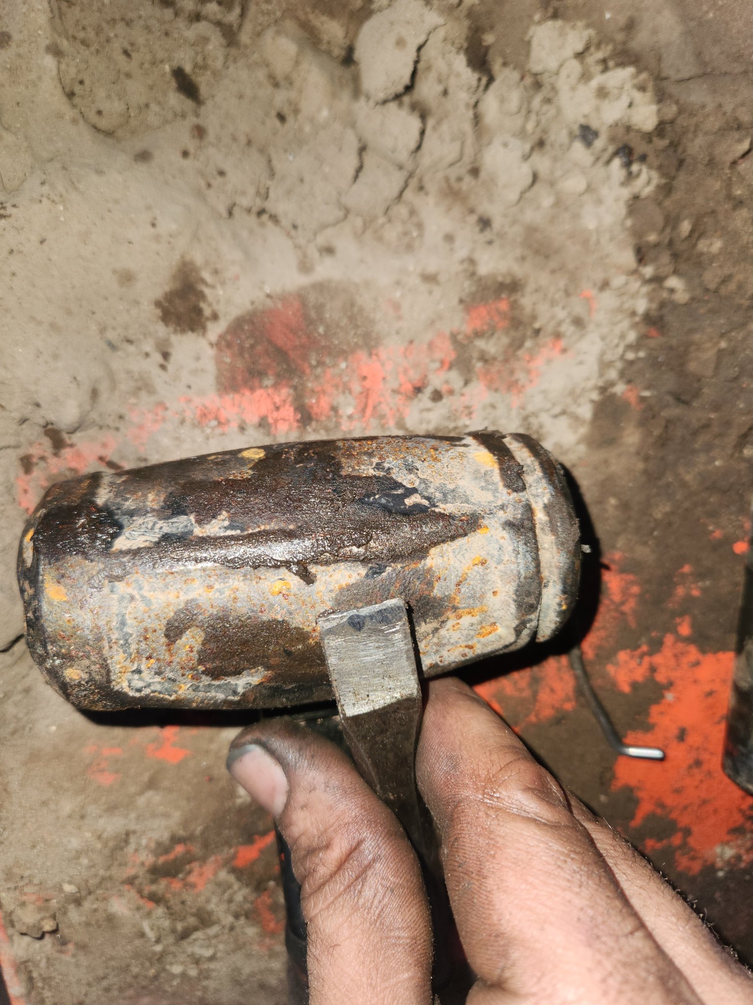

got your pin in mostly, then broke your pin, hopefully it hold
tool you need to get the pin in: sledgehammer and sharp chisel

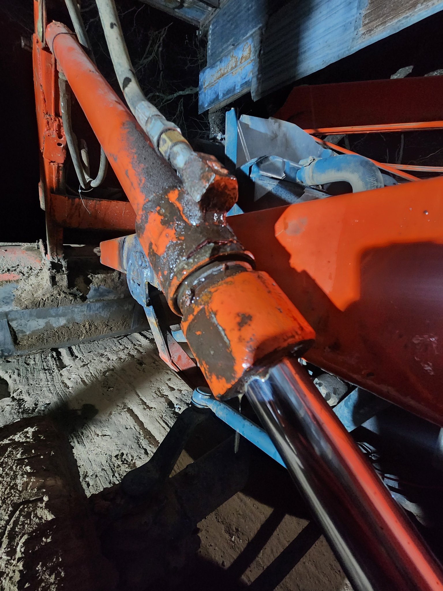

reinstall your cylinder all hardware
turn on your japan diesel, robot move bucket, bust you a hydraulic line
it musta got wedged and torn
woah, no leak from your rebuild cylinder
go shape some realm and see if the bucket stay put (probably not)
shape your realm, lug earth backward, boom
now your lift cylinder come apart since maybe your pin/rod couldnt hold, unbelieveable
your lift cylinder bust open, make you a big ol hydraulic mess

take the pin out, try to get something else in of similar thickness take place of your busted locking pin/rod
also you can seal your busted exhaust manifold while thinking of what what to order/do
so far you need at least one hydraulic hose, a rebuild kit for your other bucket cylinder, and maybe more locking rod/pin

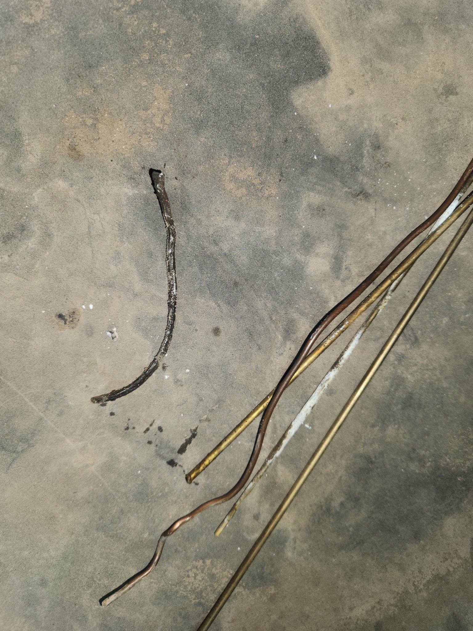

take out the old busted ring, go you through your scrap pile, decide to use a bronze welding rod
hammer in your bronze welding rod fit snug, lug around your realm for 1 hour,
woah, bronze welding rod fixed your busted open lift cylinder

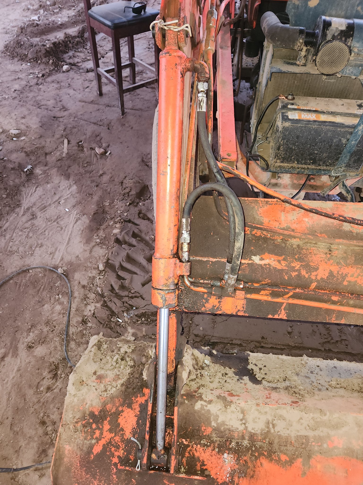

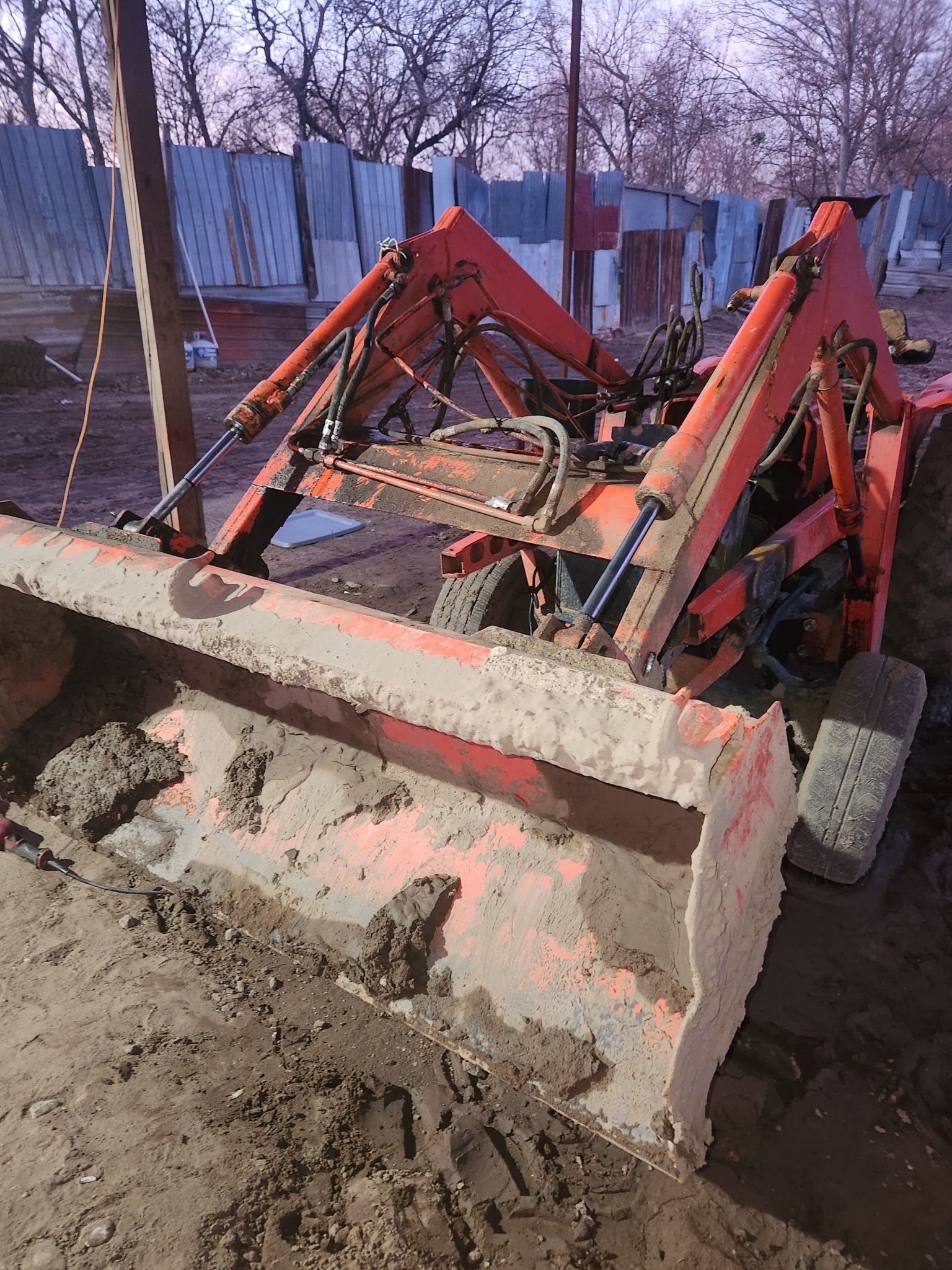

I have never thought that loader was the correct one for that tractor, but now I'm sure of it.
In the pic above that shows the bucket, I see two horizontal beams that just end in space in front of the radiator.
Aren't they supposed to be attached to something?
Maybe that lack of support is one of the many factors contributing to breakage?

seal you a cylinder, bust you a hydraulic line

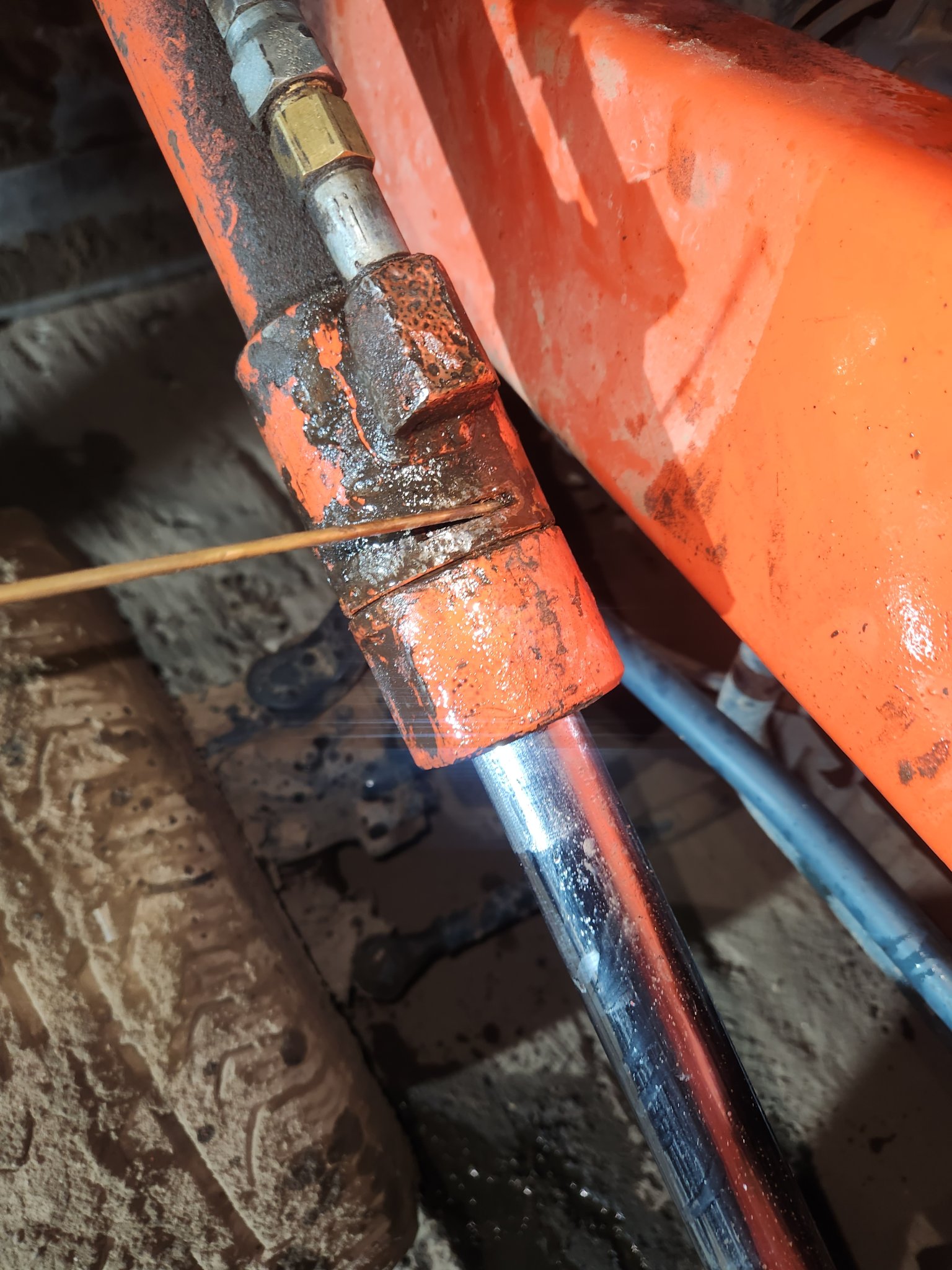

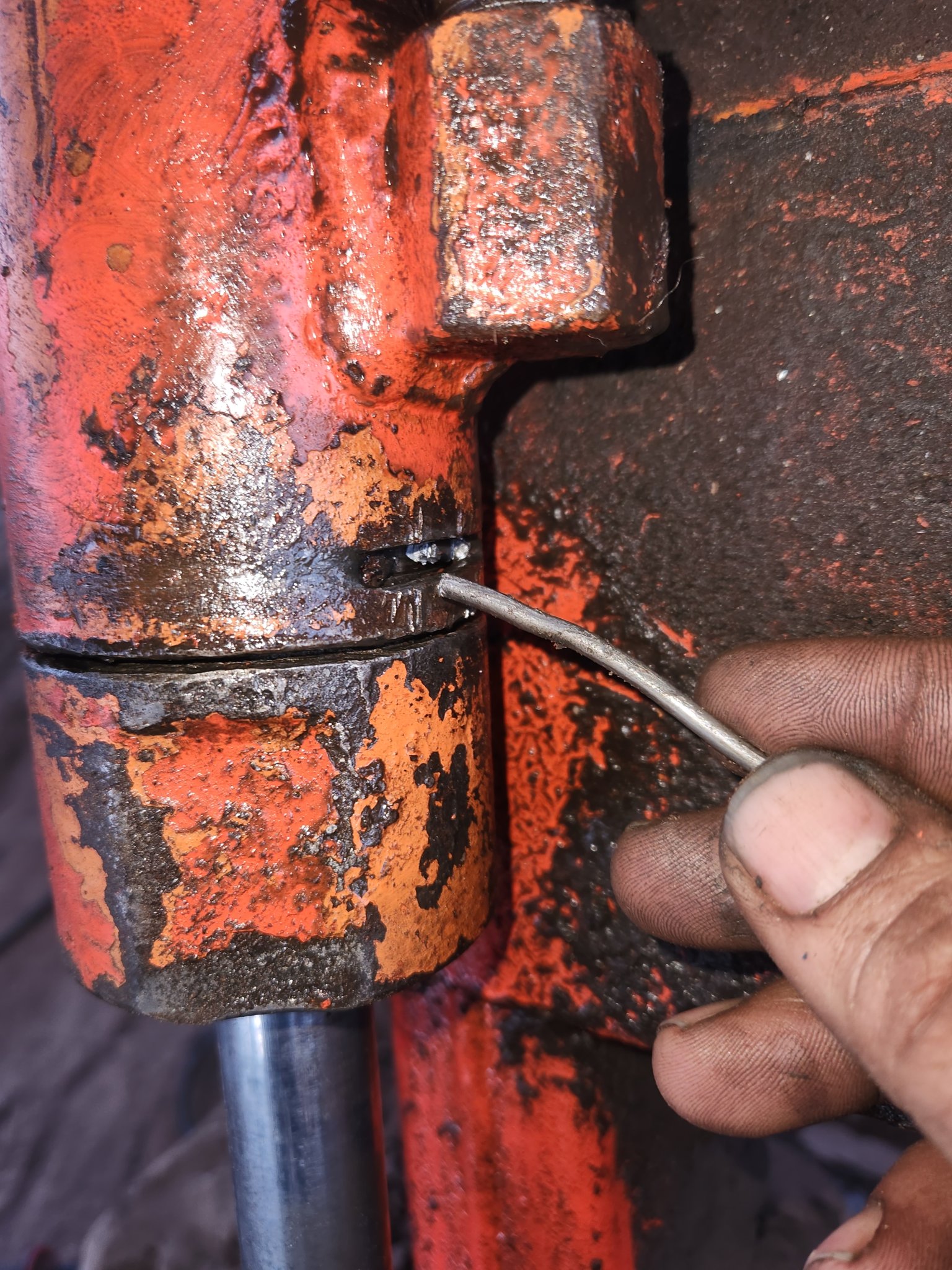

unbelieveable
You do NOT hammer the rod into place.
You insert the hook into the hole in the gland then turn the gland cap to wind and set it all the way around in the slot, locking the gland to the cylinder.

Seriously Wolf you'll need a couple puffs off joe's pipe to grasp the whole picture the way joe does.

I'm surprised he didn't sand and repaint the cylinder rod...
There is enough sand in the hydraulic oil to do the sanding over time. Then add another magical coat of leak stopping paint. Joe is world famous now for sharing his alternative block fixing techniques 😬.
Hugo Habicht
G1900
Jun 24, 2024
1,009
1,443
Ireland
At this stage I ask myself if Joe has actually more sand in the hydraulic oil or more hydraulic oil in the sand ...
And I'd really like to know what he is smoking ...

I just can't buy in to the taking the big ol pipe wrench to the surface of that inside piece that holds that stacked seal assembly making teeth marks on it. If it is steel it could score the cylinder bore. If aluminum just chewing the thing up needlessly and the potential for pieces to come off it and ruin the seals.
this is factory image of your loader, you can see they do have a beam connecting those 2 point
problem: if you put a beam there, you won't be able to open up your hood, it block it
maybe: forget the hood, do you a big ol magic trick putting a beam there, let it marinate
