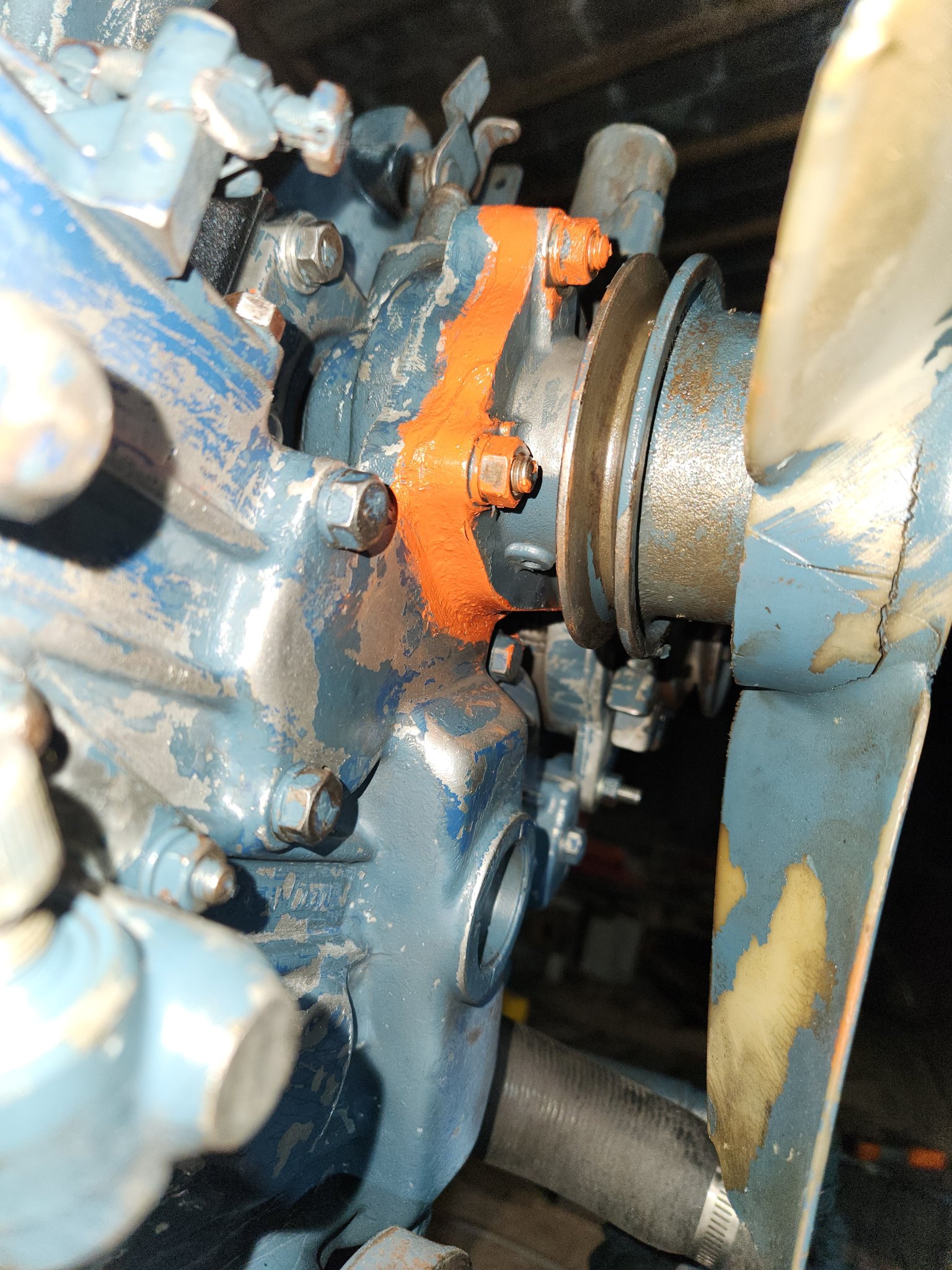

Parts fully clean, ready for reassembly
Now: imagine it come back together perfectly without leak
lay head gasket on block, lift heavy head and lay on it, get bolts in hand tight, on and on
Recycle new head gasket, don't forget little o ring bottom right
Head back on, glance at diagram, emulate perfectly
Fasten head, stud bolts top right and bottom left per diagram, perfect washer on all bolt

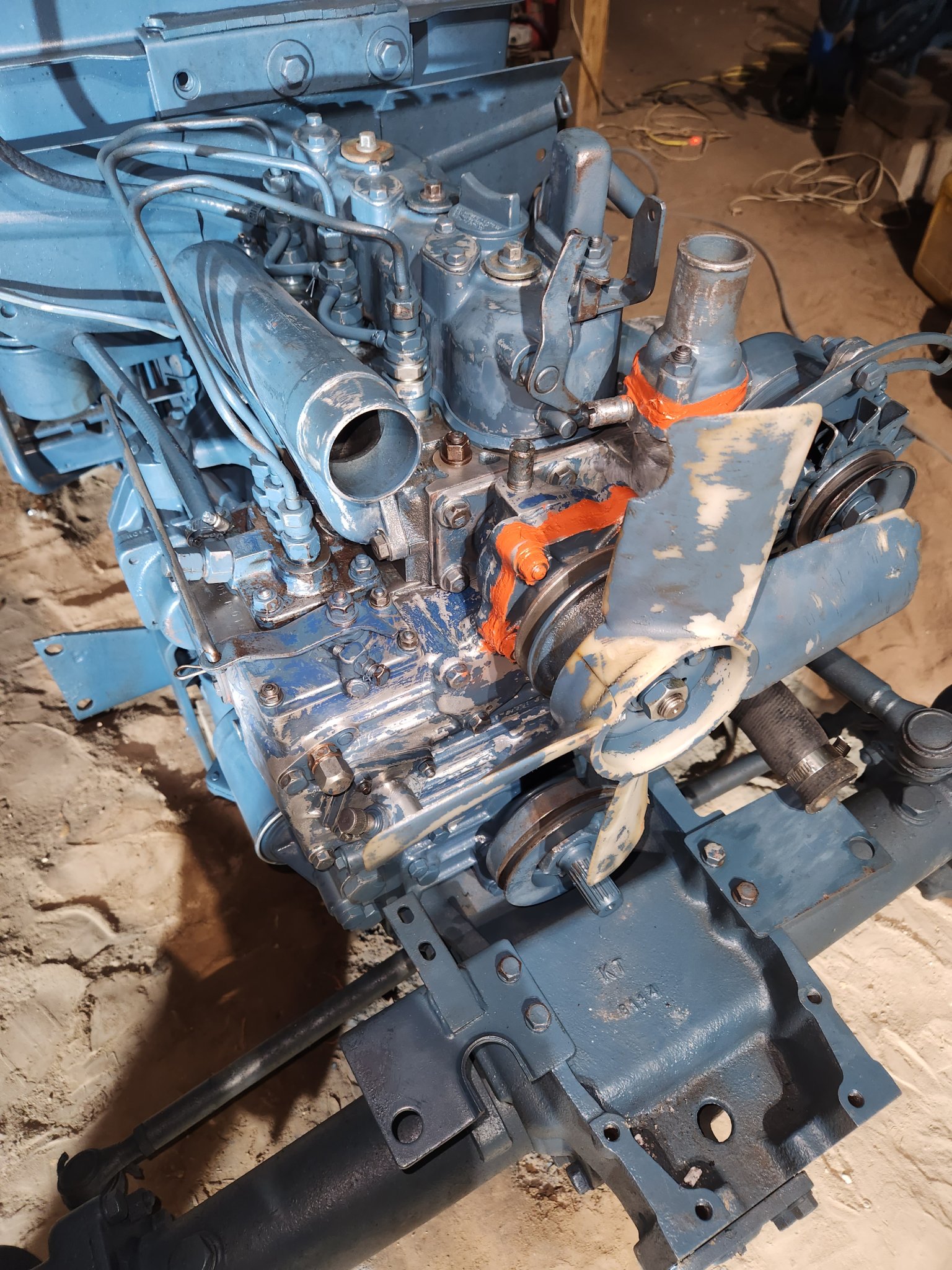

now: install phaser, do not forget any hardware, then exhaust, maybe use gasket maker seal it perfect,
finish installing all part in proper order up to radiator
had to dig deep into spare part bin to find all the bolt for intake manifold, long time since they have been in use
installed phaser, then cover, all proper hardware,
now: file exhaust manifold and install with the gasket (did not have leak last time, not using rtv since it is really high temp area), fasten diesel lines to injectors
then maybe: run it once not too long, looking for oil leaks and water leaks, before putting belt/alternator/up front parts...
no, cant run it because i would have surgically bind water pump and let cure,
Get up to that point, get engine ready for leak test, let cure overnight
Install alternator, diesel line, exhaust,
Ready to surgically couple gearcase to water pump
Clean both surface, apply on gearcase with right finger, focus around studs, put on clean gasket, again use finger to apply perfectly, then couple water pump, fasten, run finger across entire bead, wipe excess, surgical seal
let it cure overnight, engine fully ready for leak test
imagining that engine come back to life and all leak eliminated and perfect idle

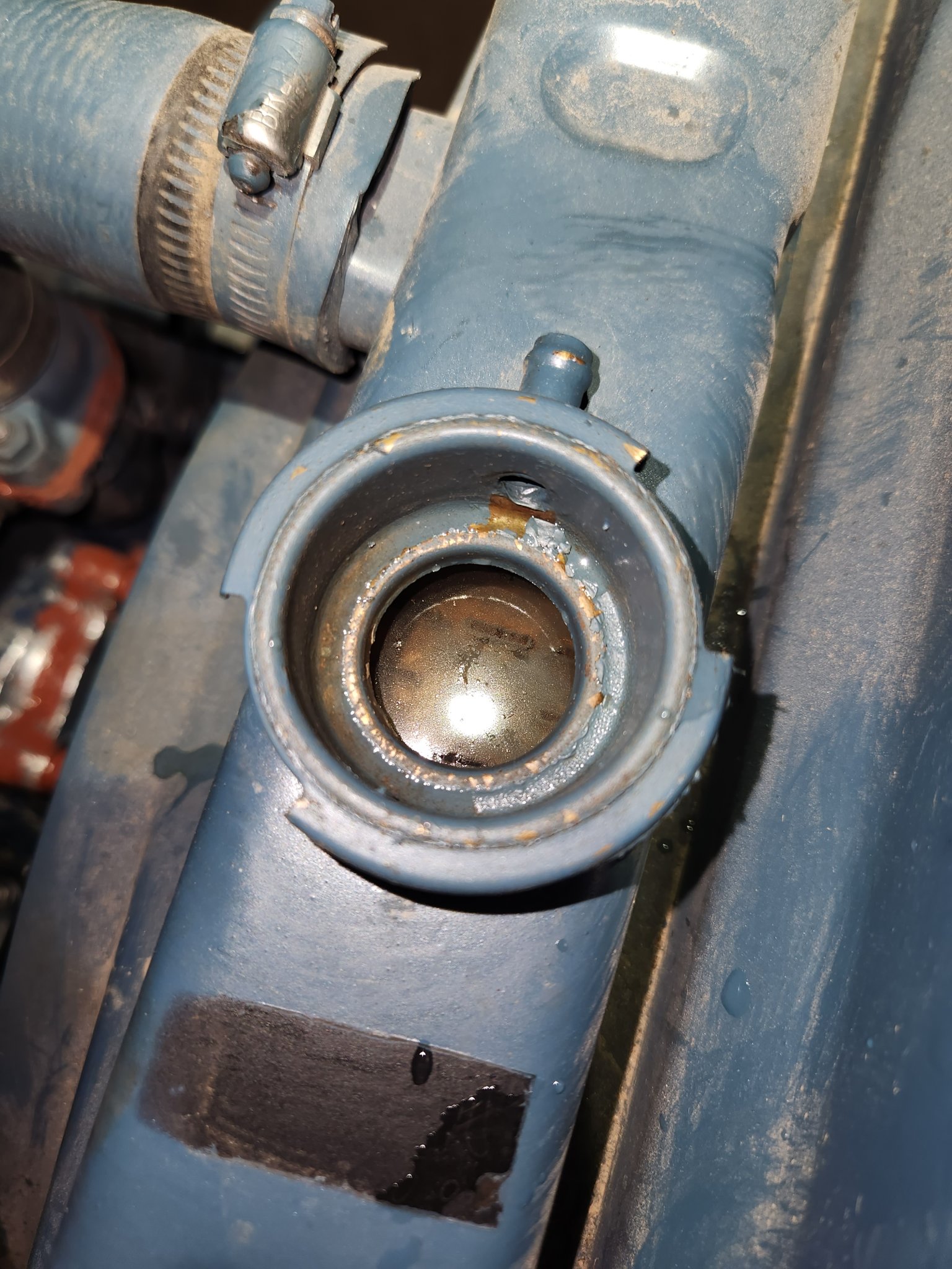

Start it, see if she leak
Put water in it, put top plug on not too tight,
Get it started, run it until water start to boil
Yes, in this clip, you witness COLD start
2 cheap almost dead batteries, gave it 2 minute glow plug
Start up on first compression
No leak except for TINY diesel leak under injection pump
water on it was from when I pour water into engine
In this clip, engine a bit warmer, going through with air looking for leak, no leak except injection pump
Also, lowest I got oil pressure without it shutting off, but it did in the end
There you have it, old thick japanese diesel engine, purring like cat, with no leak
(the rebuild of this diesel was brought to you by nature)

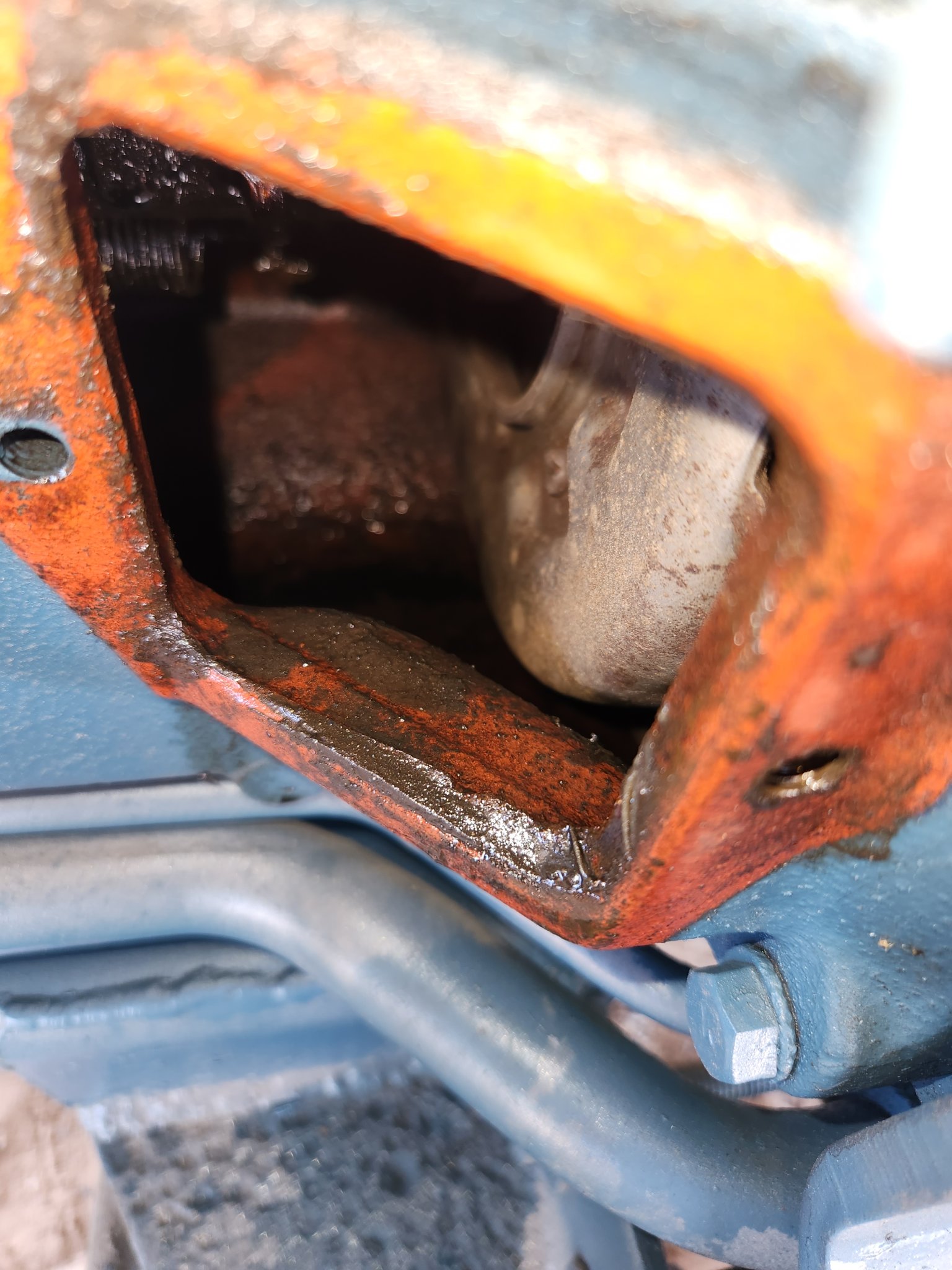

not end of world but huge mistake
we look inside cubby hole of bell housing, we see oil leak
Should have waited for the new japanese seal and not reused 44 year old seal
Its not as much work as you think: split tractor, take off flywheel/clutch/etc
That leak I leave it there for now, its good for that area to get lubed

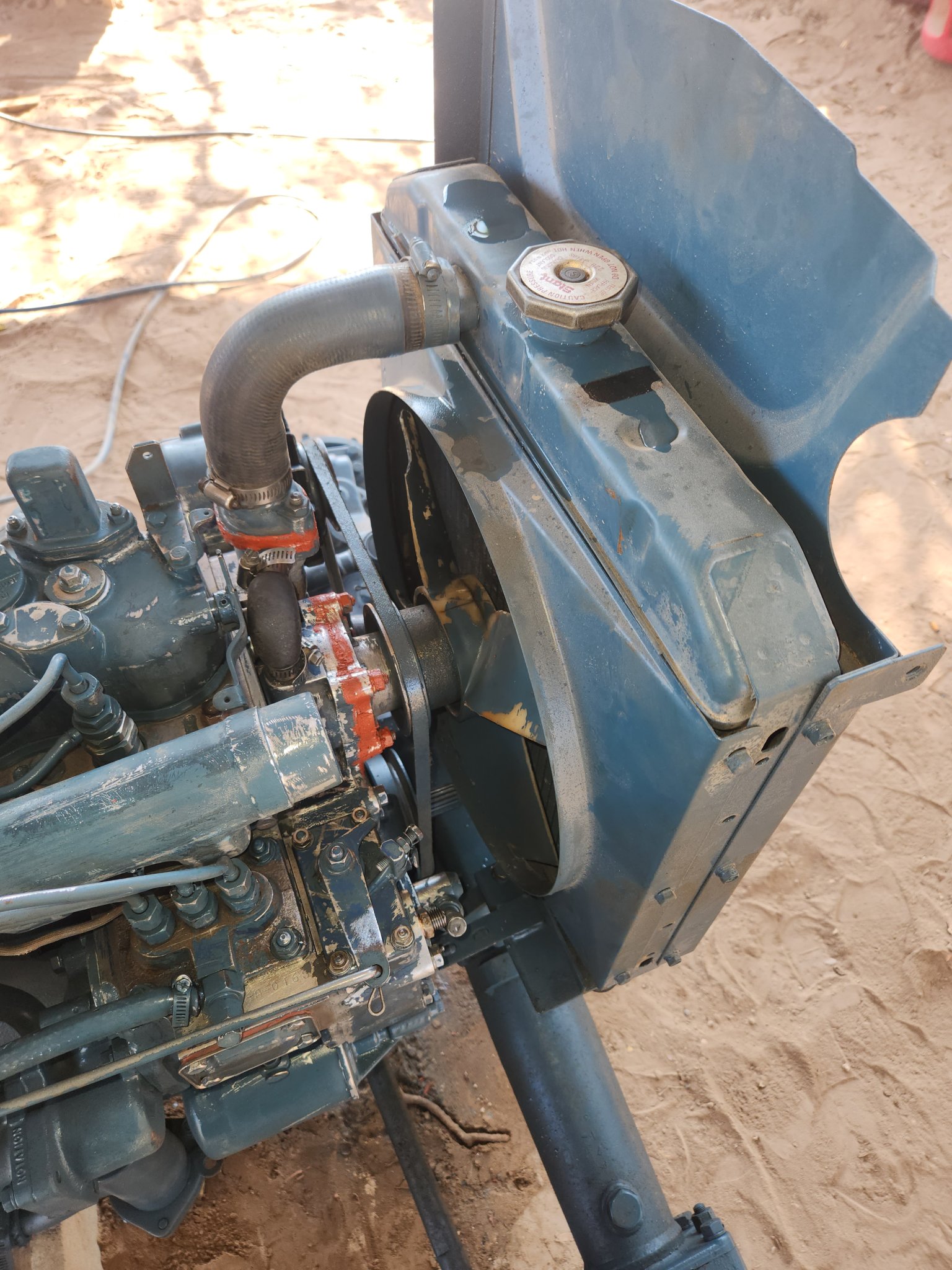

my instinct: stop being perfectionist, its good enough, finish assembly, put on radiator, put big amount water, run it long time like wolf suggesting, then come back and reassess next step...
yes yes I listen, grind down excess gasket maker, clean area, put together belt alternator radiator, fill with water, then do long test, no paint, no other decision until we get to that step
this adjustment: i keep backing out, it keep making better idle
Copper radiator thirsty, took two gallon water
Run for 45 minute, got idle oil pressure down to 38 psi
Action: run it as low throttle as possible without it shutting off, assess oil pressure fluxation, then intentionally shut her off, make small adjustment on that idle screw,
she start right back up no glow plug, first shot
idle getting better by itself, it went down to 30 psi, and saved it itself without my adjustment
maybe this is what they call engine breaking in
No more see saw
after this video, i got it down to stay at 38 psi, anything lower than that, she shut off after 1 or 2 minute
maybe this is as good as I can get her to idle?
Ran it so far 2-3 hour, zero puddle of any kind underneath, only tiny injection pump leak, and small main seal leak

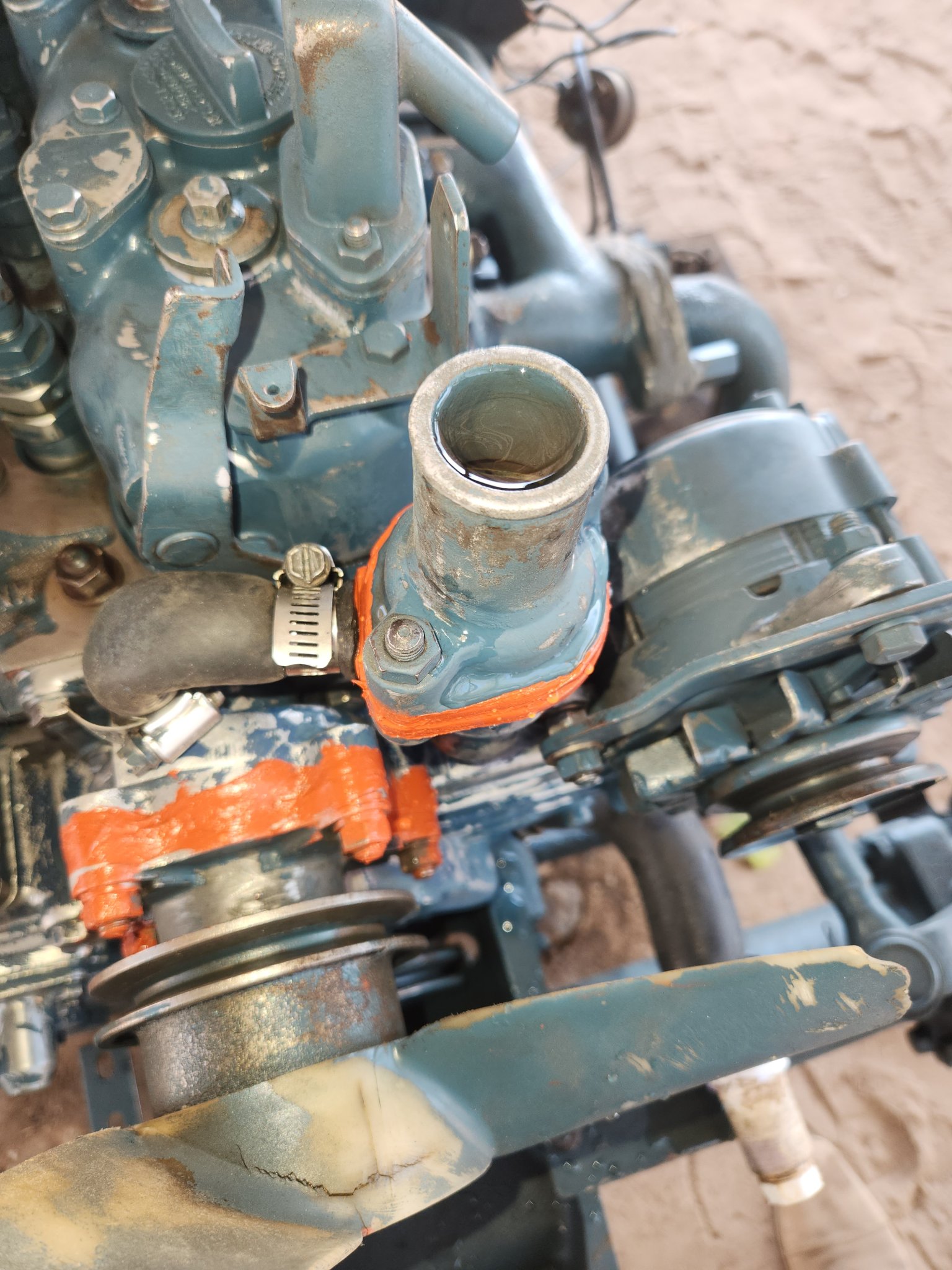

This thread is really became a DO NOT DO THIS thread!
I really think your trying to get the engine to fail.
Running it without the rest of the colling system in place and working is a fools folly!
Because your not circulating the water it's making hot spots and it will eventually fail somewhere!

the orange sealer gunk you are using certainly has its applications although I have to say I cannot remember when I used it last.
It's purpose is to fill tiny imperfections in the surface. If you think you have to use it apply a paper thin layer, not more. Remember: the same amount squeezed out on the outside in your pictures is also squeezed out on the inside. It clings to the engine by a very fine thread. If ripped away by fluid motion and deposited inside a cooling channel your engine is in big trouble.
Also (as said already) applying it outside is no good whatsoever for sealing leaks. Wipe off everything on the outside. If it is silicone material paint will not stick to it. You can also get it in grey or black colour.

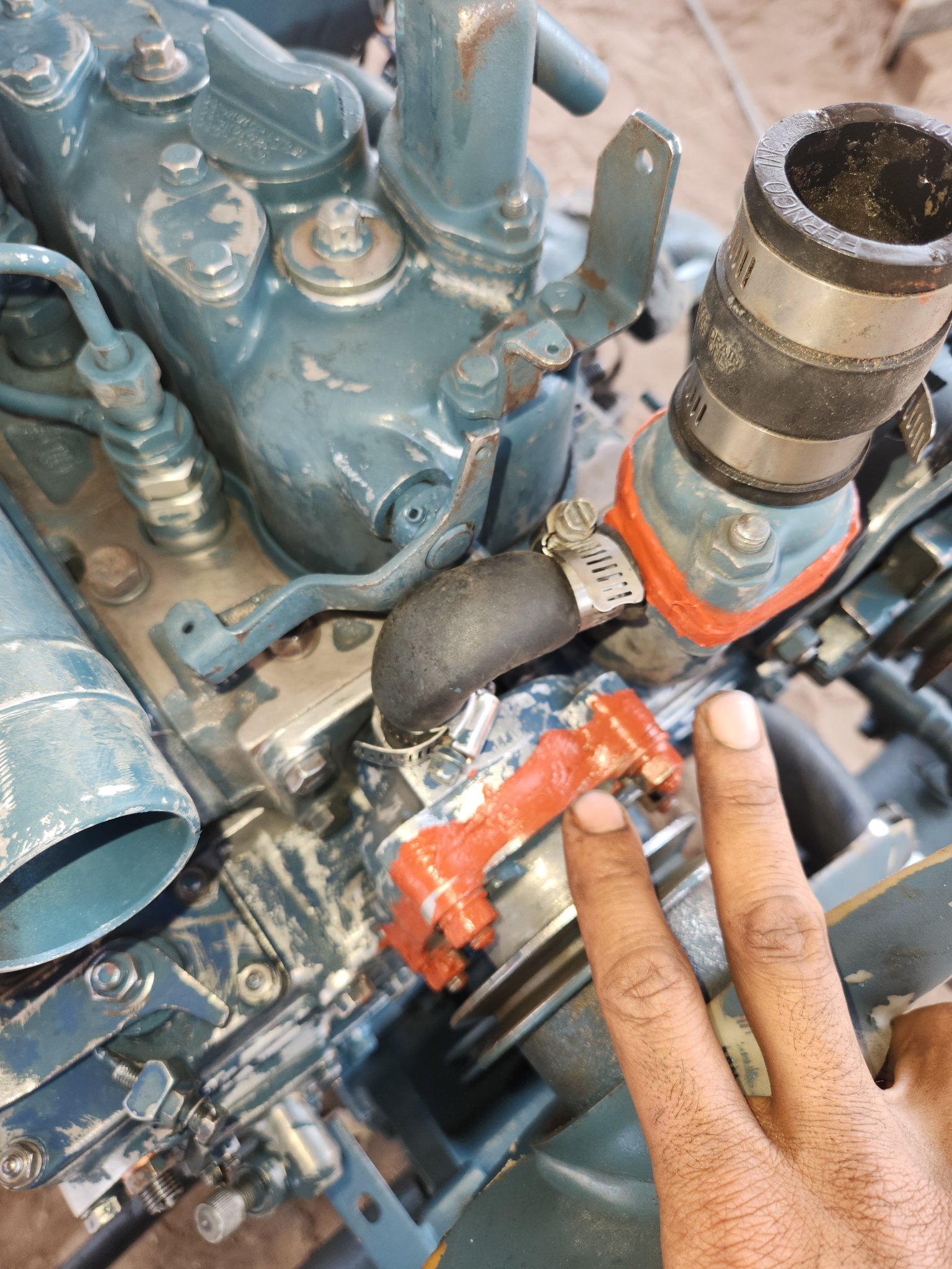

The whole project has been "its good enough " where was the part where you were a perfectionist? I missed it

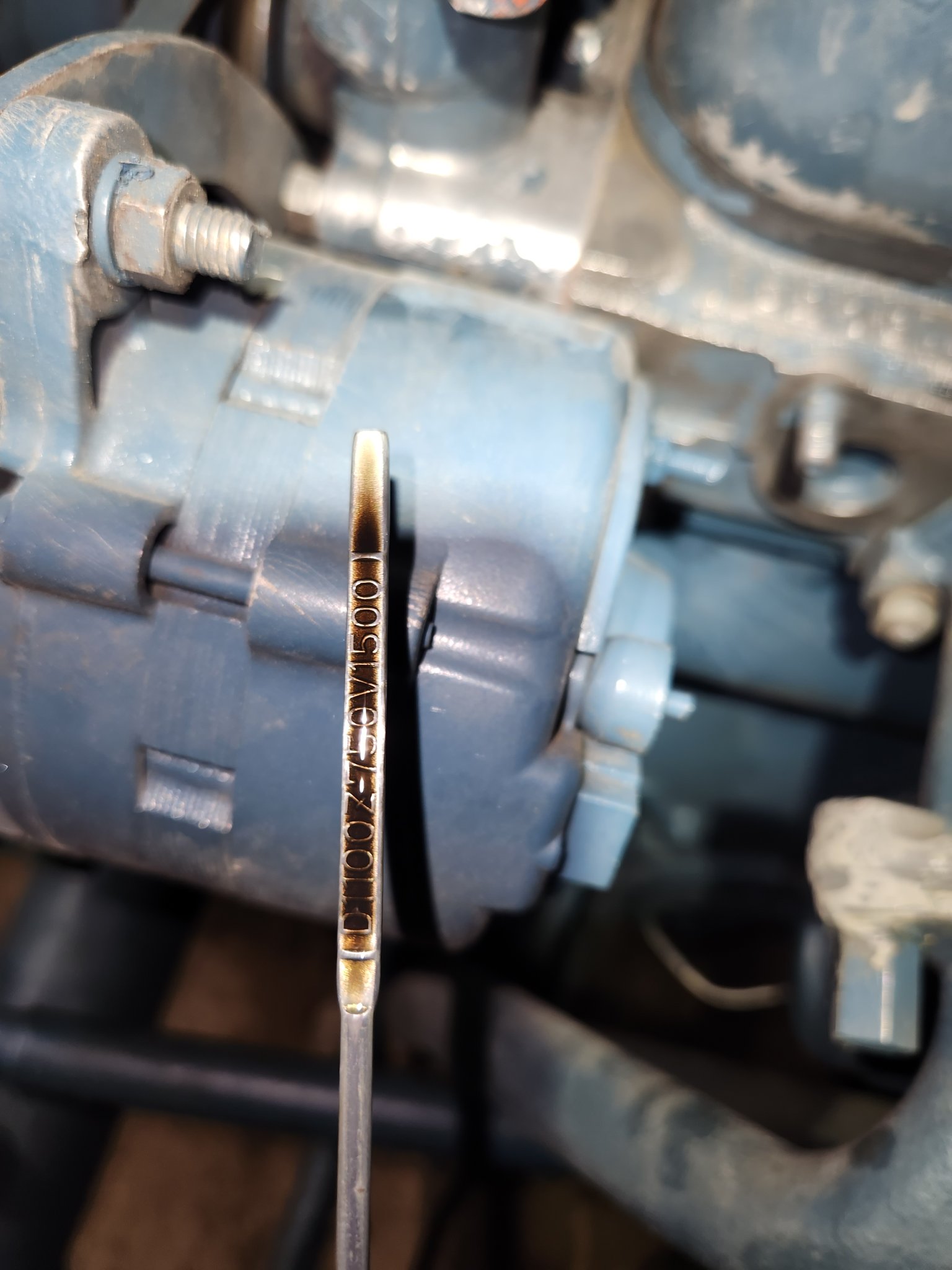

Video: this is current state, incrementally dropping throttle, showing you oil pressure, showing you the leak situation, or lack thereof
i guess 40 psi for an idling engine with 1.5 gallons of oil init is normal
maybe once in the working state, and more hot, idle oil pressure further down, i've noticed that on other machine
Engine ran for 5 hour today, break in period. Open coolant, look fine
After running engine 10-12 hours, oil still full
