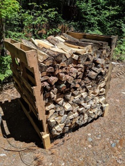

There is an old saying, firewood warms you 3x!! Cutting, splitting, hauling. Moving firewood is probably the most underestimated work. You split it, haul that to a drying spot, haul smaller loads to the burn area, etc. Having a tractor definitely helps out, still alot of handling each piece multiple times.
I thought about this, looked around and came up with a easy, very low cost solution. I built firewood racks out of used pallets and scrap wood. Each rack holds a face cord, it takes me 10 minutes to build one, and my only real material cost is deck screws (I always have scrap lumber around)
The great this about this is I can take the rack to the wood/splitter, fill it there, move it to a drying spot, then when I'm ready to use it move it to that spot (Sugar shack, fire ring...) Of course it helps to have fork attachments!

Solbergdave what do you think that rack weighs full of green firewood? I like the idea a lot, just don't know how full I could lift it with my b2650 FEL. Capacity 534kg.

I have boxes I built like that, and with my B2920 I can handle around 1/6th of a core of semi dry hardwood. That’s an actual cord measurement, not a face cord which can be whatever you want it to mean.

This chart lists my dry tamarack as weighing 3330 lbs./128 cu.ft. cord. So I'll be loading 1/3 cords max per lift given 534kg = 1137 lbs. I guess best I mount the backhoe on back for a good counterweight!
https://forestry.usu.edu/forest-products/wood-heating
As pallets are more like 40" not 48" wide, one of your racks full may be just about 1/3 cord.
I have some pallets to play with, definitely going to knock one together soon and I'll report back on the results.

So after I built the first one and started splitting some big chucks of wood, lifting them green, I was thinking....is the tractor going to lift this rack, the wood was heavy. So first one, at about 1/2 full plus I forked it up and lifted no problem, so I went for it. Not an issue. I have a MX5800 and the rack is 4x4 and I put 2 rows in it, one on each side, then fill the center with some random pieces that will fit. So pretty much a full face cord.
