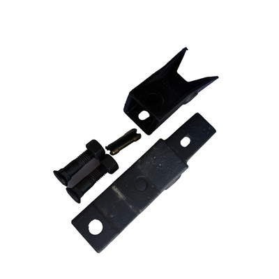

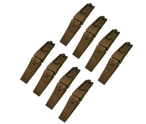

Someone point me in the right direction: what are the aftermarket "teeth" called for the FEL buckets? I have a project coming up, a small pond build in easy digging/no rock/soft spring dirt, and since I sold my Mini X U25 (thinking I was all done with moving dirt.....) but have a L3301 and a rear ripper, I'm in the market. Did a bit of searching, I'm using the wrong term I guess.
29,005
5,340
Here are 4 for bolt on teeth:

After watching several YouTube videos, and also spending time on EveryThingsAttachments and the Piranha sites, I've decided to stick with my original plan of just using the ripper first, then hit it with the stock blade. As much as I like spending money on attachments, with my soil conditions (no roots either) I think the stock blade will do fine, with the rippers help. I feel like I just made some money, having come very close to clicking the BUY button, but not! Doing it as soon as the 4' of snow now there melts will help a lot, I know from planting fence posts in the early spring V. late summer. Late last summer I hand dug a hole to partially bury a 500 gallon water tank, and I was amazed how easy it was, once ripped, easy enough to use a flat nosed shovel, no tapered/pointed one needed.
