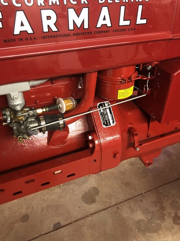

Working on making a custom choke rod. The original was in my opinion, an after thought. So I got some 1/4" zinc plated rod and started by Macgyvering a little press brake punch and die to bend a tight radius. Machined some guide slots in the die to keep things square. Formed it in the hydraulic press.
Yooper
3901 LA525
May 31, 2015
1,602
725
NE Wisconsin
Just eyeballing it as I went along, I managed to get it right on the first try. Figured I deserved a day like that! Also found a stainless ball knob in my collection that made for a nice touch on the end. And with that, this project has come to its conclusion. One of the most fun projects I have ever done! Will conclude with a walk around video and we'll take it for a ride.
