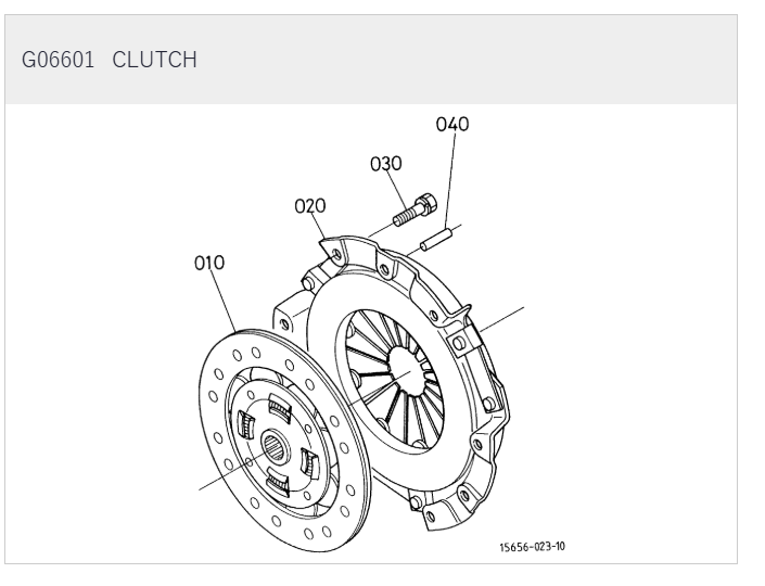

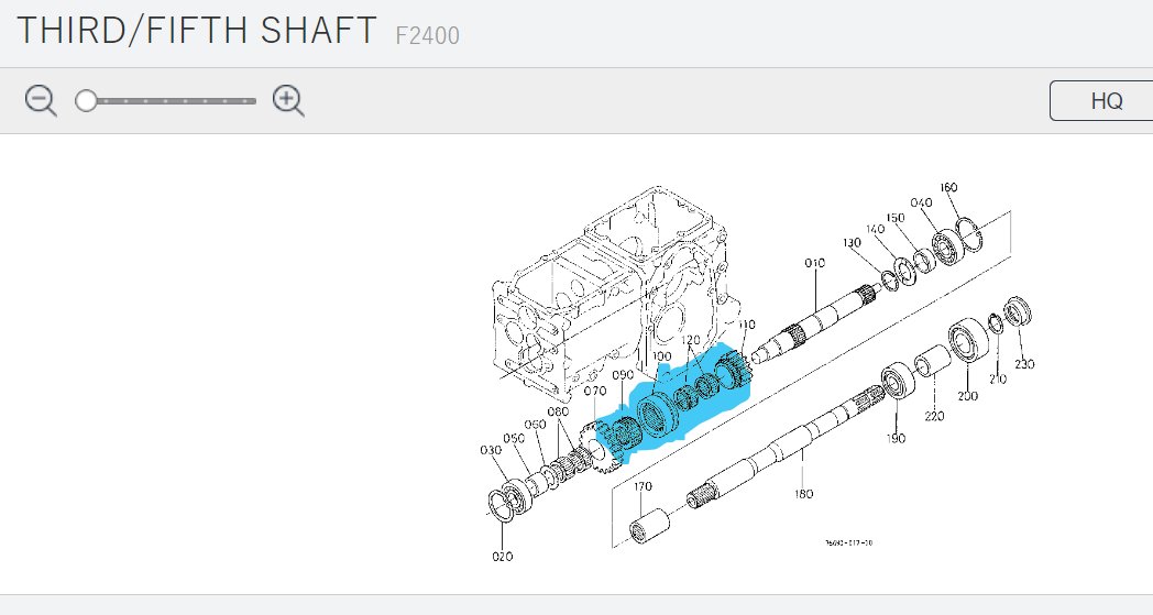

The F2400 doesn't have a PTO clutch.
It's a direct engagement PTO without even a one way clutch.
What need to be done to it depends on what is really going on.
If the PTO is slipping and the tractor movement slows too, then you have a problem with the main clutch, that is a cake walk to replace.
It's the same procedure as a B tractor.
If the PTO is popping out of gear it could be as simple as cleaning up adjusting the PTO engagement lever (not very likely)
To the more likely scenario that you'll need to dive into the PTO shaft shift collar and see if parts are damaged.

As always, your depth and breadth of knowledge in all things Kubota is incredible. Thank you for sharing this information.
