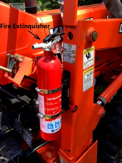

I saw that, too. Kind of a shame that he ran to his other excavator and the only extinguisher he had didn't work.
I don't have a favorite. Buy them and buy good mounts. Some of the mounts they ship with are pretty weak. How long it took him to get the nonworking extinguisher off was noticeable.
I use a mount like this one on my Ranger and Kubota. https://www.amazon.com/Release-Aluminum-Extinguisher-Adjustable-Wrangler/dp/B086351DBV/

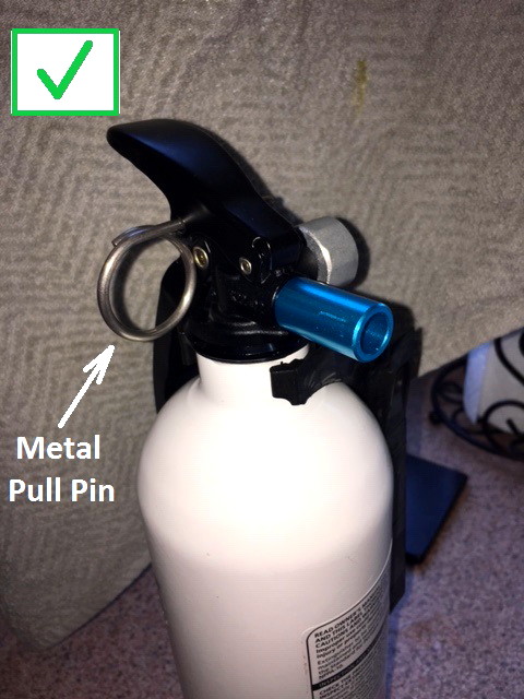

Had a similar experience only not as expensive a loss.
I keep an extinguisher in ALL vehicles and on all equipment (tractors, mowers, etc).
Was walking my Dachshund one afternoon and when I turned the corner to go behind my shop...I was horrified to see my Scag Zero Turn mower on FIRE! Apparently it started at the battery.
It wasn't yet completely engulfed so I turned my head and reached down to retrieve the extinguisher I had on it. I backed up a step and went to pull the safety pin.
The pin (plastic) broke off flush with the unit (no way to un-jam it) and squeezing the trigger would not break the remaining portion.
Tried to put the mower out with a garden hose....but by then the fire had spread to the fuel tanks. Had to watch it burn to the ground.
ALL extinguishers have METAL safety pins now. So yes, even if you have extinguishers on board....check them from time to time.

Avoid cheap extinguishers that have plastic valves, levers, and pins. Buy only METAL extinguishers.
