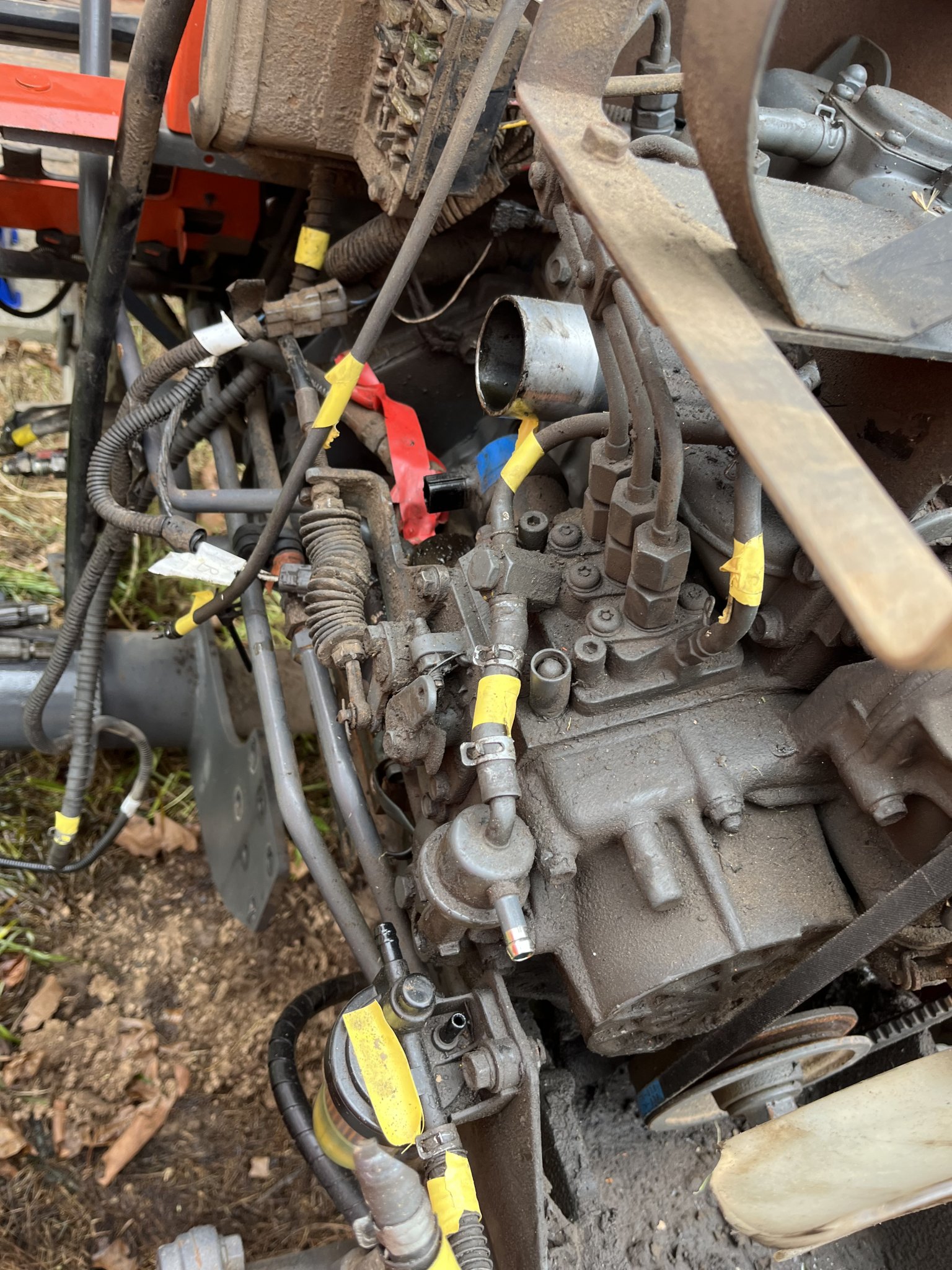

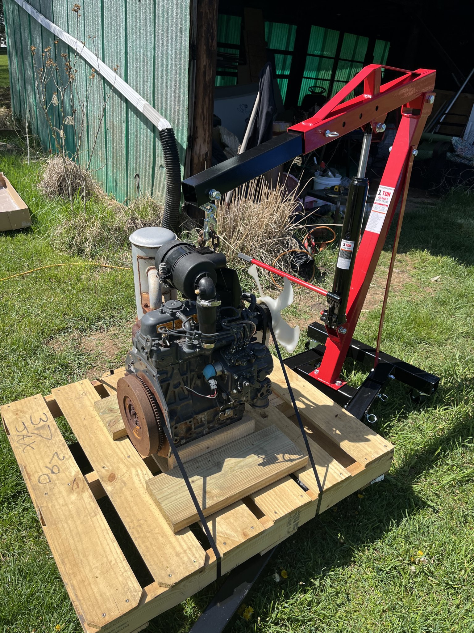

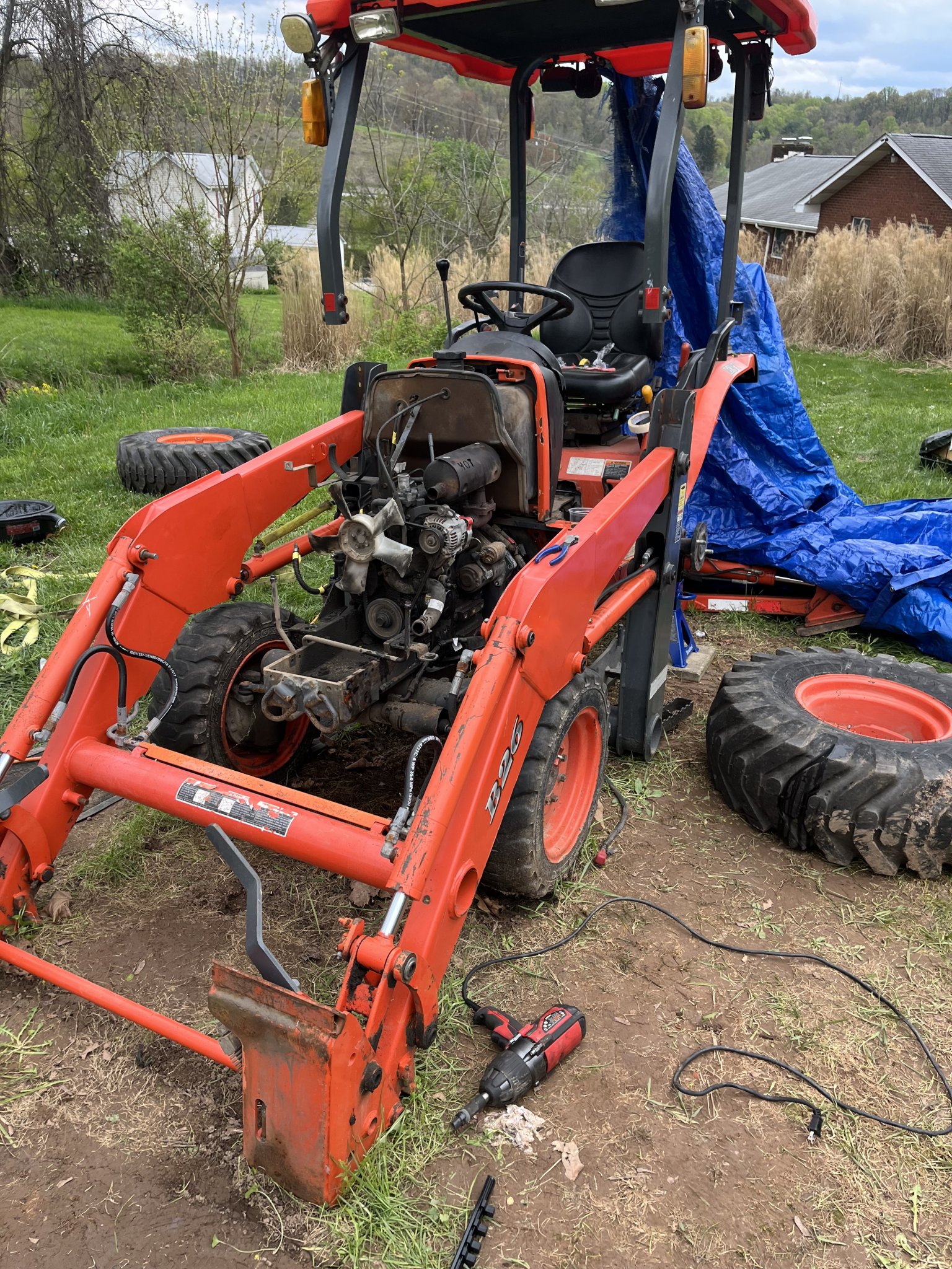

Update: b26 kubota d1105 engine replacement. So I have been dismantling my tractor to put a new used engine in. Here are some pictures on the progress.
Clint_J
B26
Mar 17, 2024
Pennsylvania
If anyone has any comments or ideas let me know… first time trying to do something like this so any input is always appreciated.
