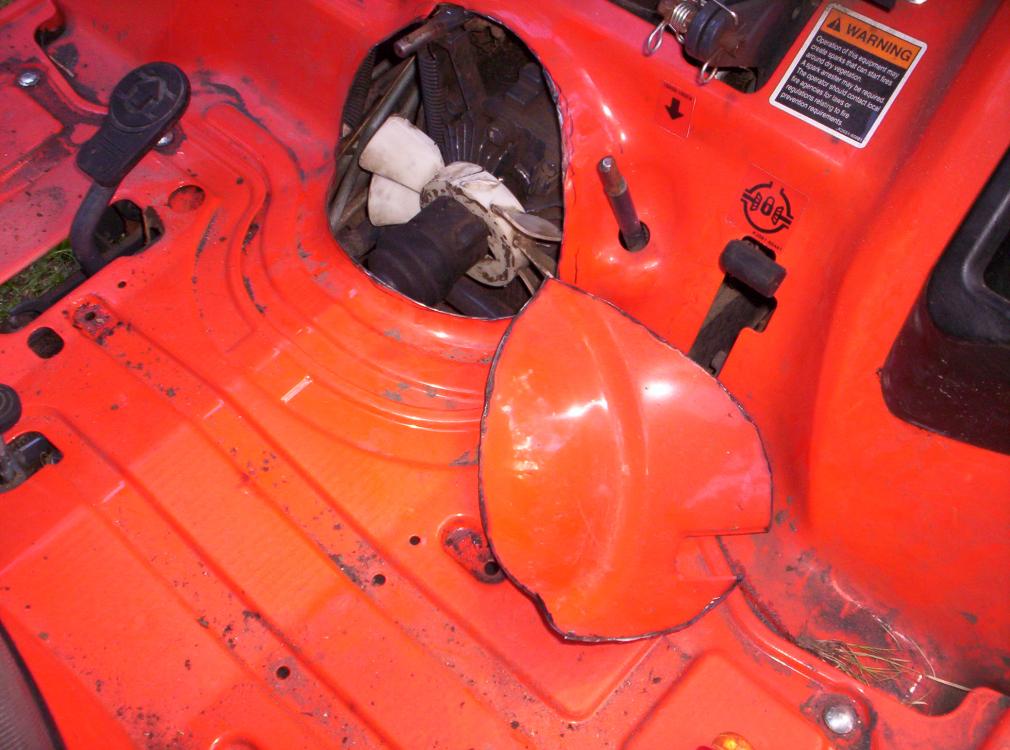

OK men here is the easy way to replace the HST fan on the new BX2680. And a word of caution if you own the new bx 80 series tractors don't ever do more than cut grass until you get a BXpanded cover for the bottom of this tractor. Her bottom is bare and you will destroy the HST fan and possible fuel filters, wiring, fuel hoses as well as the HST filter all hanging down low to get bumped and bashed by sticks and rocks. Here we go its a two hour job at the most. Remove the front hub bolted to the engine, remove the cv joint bolted to the hub then pull rubber boot off cv joint and remove the snap ring holding it in. Now the shaft will slide forward all you want. Go to the back I removed the snap ring and pulled out the shaft nothing to it. There is four balls in the cv joint so watch for and catch them as they come out. Here is the only trouble, the bolt that clamps the collar to the rear HST shaft. I drilled a 2 inch hole with hole saw between the two knobs right under the seat to access the cut out in the HST on top to remove this problem bolt. Pulled the hub of the cv joint off the shaft with broken fan, bolted on the new fan and put it all back just like I removed it. The 2 inch hole is the key to success with out disassembling half the tractor. I will pass on that one. Now I will make a neat little metal cover and pop rivet it over my new access hole. Problem solved.

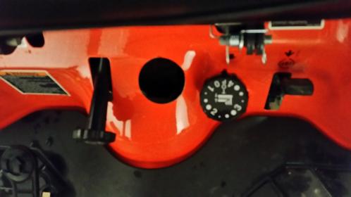

There will be snap in plugs (plastic or metal) to pop into the hole you cut. If the hole is in metal then you should paint the edge to keep it from rusting. Plugs can be gotten at NAPA or hardware stores

And if you get a black nylon plug you would think it was a factory job just like it should have been. Yea I know that would cost Kubota dealers thousands of bucks a year replacing this 7 dollar plastic fan. I had my new BX a total of 5 days before I destroyed the fan with a green stick about the size of a pencil. I can promise you this was engineered to fail and get in your pocket for 500 or more bucks to replace this fan. This is a stout little tractor but it does sit close to the ground and needs a full belly pan to protect it. I will call it my fault for not looking under it before doing some brush hog work. When I saw that HST filter hanging down low I was shocked into reality, that filter will get punctured sooner or later. Will get a pic posted of my access hole. If you measure correctly a 1 inch hole is all that's needed to access that troublesome bolt on the HST shaft collar. I drilled a bigger hole just to make sure I had room to work at a angle if needed. It was a straight shot and about three inches down to the collar bolt. I put the bolt back in with a magnet on a stick.

I would like to see where you put the plugs too. I haven't hurt my fan... but I know it's just a matter of time. I'd like to drill/plug before I ever have to do the job.

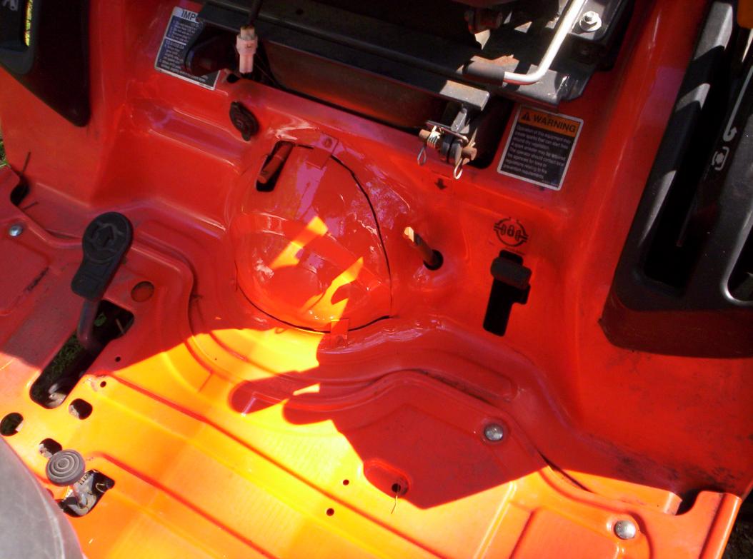

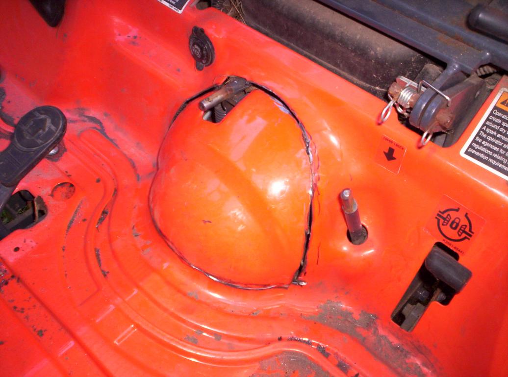

I did something similar, cutting an access opening as pictured. After removing the coupling bolt, I was able to slide the driveshaft forward enough to access the fan bolts. I used a 1/2bolt (3/4 inch head) to hold the coupling in place to do this. I cut the old fan and removed it. I cut the new fan as shown, installed and bolted it in place. I epoxyed the fan cut (JB weld) and also epoxyed a small strip of the old fan over the cut. A hundred hours of landscaping and pasture mowing later to test the epoxy - everything is great. If I break another fan it will only take 1/2 hour to replace now.

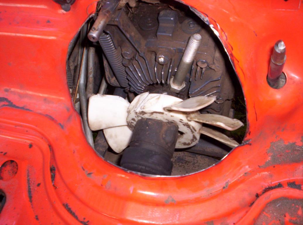

Here is the 2 inch hole right over the bolt. There is no way I would tear this tractor apart instead of cutting this hole. Quick and simple. On a side note the cv joints have a spring inside and will compress with a pry bar until it stops. It will not damage them to compress them. My ten year old nephew removes the cv joints they are self explanatory when you take them apart and will only go back one way. One spring and four SS balls that work as bearings about the size of marbles. Grease will hold the balls in place while you slide the CV joint back together. Taking the shaft out keeps you from cutting the fan blade. The fan bolts right on the back of the rear CV joint. Pull it, it ant rocket science. I will replace these all day long for 200 cash

Some of these posts show a two piece connector at the motor end. Mine does not have this. Shaft runs from fan to back of engine and is impossible to get out without moving engine forward a few inches.
Absolutely cut hole in hump in floor board. Uses a 2” hole saw and it saves a tremendous amount of work. Probably don’t need to go this big but make a common size hole so you can find a plug for it.
The engine is only 4 nuts...take hood and sides off, take off 4 nuts, lift engine up and forward some. Just watch cooling fan. I didn’t remove anything else to move engine.
I replaced to shaft boots so you have to break down the cv joints. Nothing was hard just small space and working on your back. I used the bucket to pick up front and put it on car ramps.
Cleaned cv joints, used new grease, and put it all back together with new fan.

RGK66 what a killer idea. Since mine has been missing fan blades all year I will wait till it is too cold to work then do this mod in the Barn. I think I will add a 1 inch band lip with tac welded nuts on the tractorside for quick on off. THanks as I was really not wanting to do this repair. Now I can buy two fan blades and be ready.

However, if you did cut the hump out or use a hole saw to expedite things, why wouldn't you just tack weld the plate back in place, then use a paintable sealant? Then, no plug to rot or brackets to come loose?

Either way I have to replace the fan. I am going slightly different from the others. Since I have time I am going to cut out the hump and make it into a cover like a differential plate. I have no problem cutting the fan then gluing it back together.
