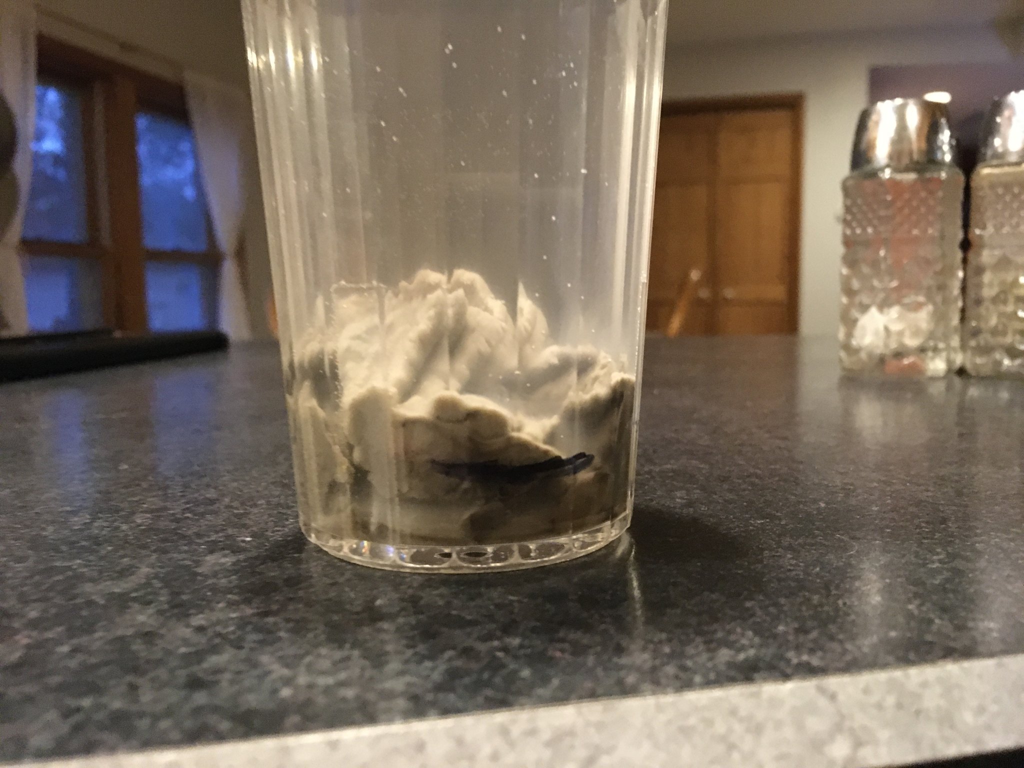

Update on my wildlife watering hole and sodium bentonite experiment .
The three photos are what happens to the 3/8 bentonite chips in a water glass and what happens when they get hydrated with water. Its hard for me to qualify a number as to how much swelling these chips achieved. I have read anywhere from 10 to 18 times by volume depending on surrounding soil types and other factors.
