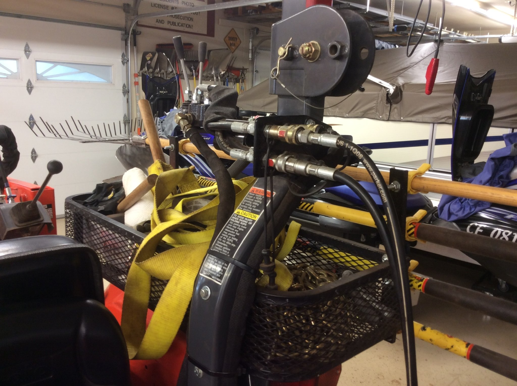

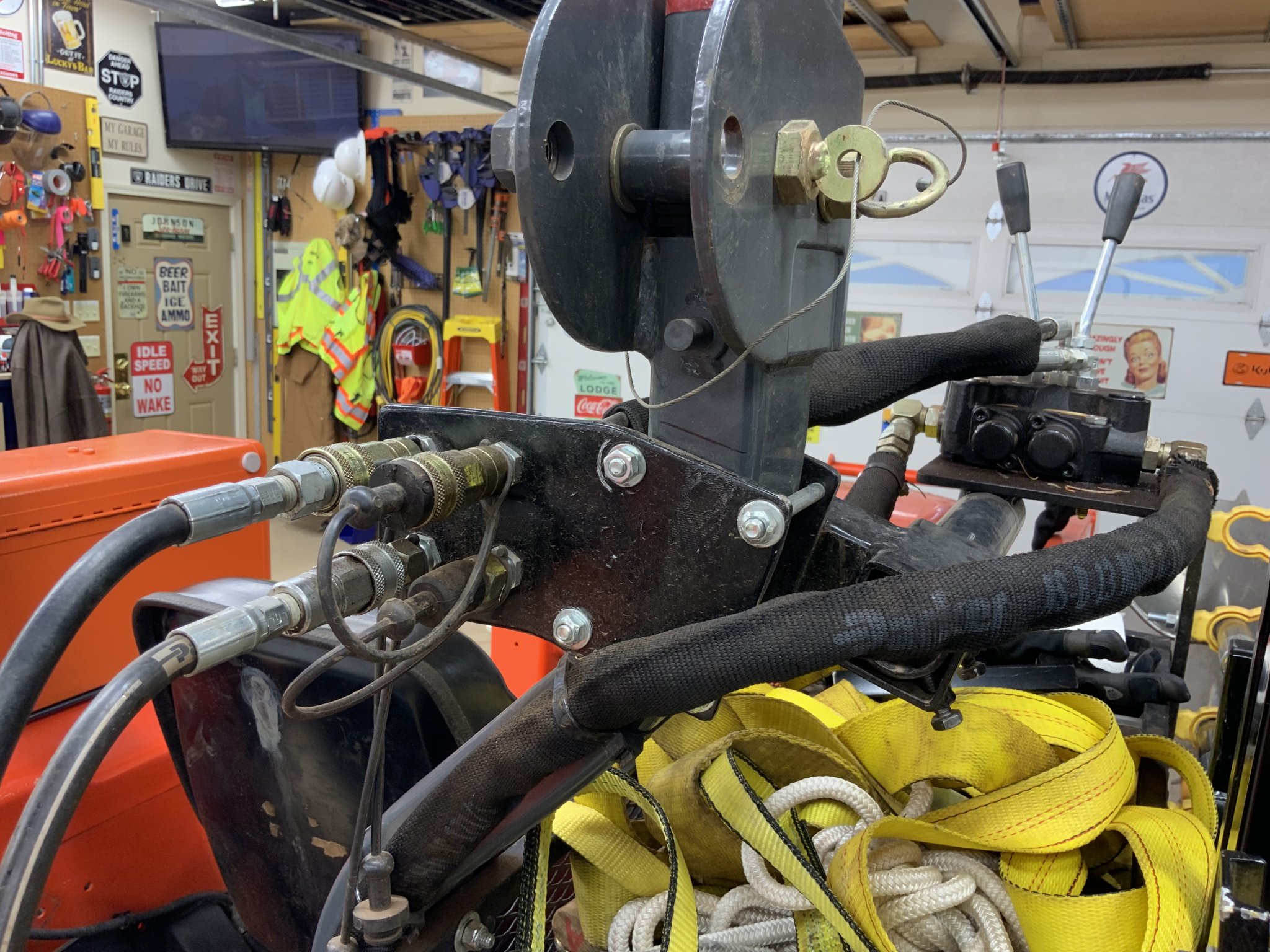

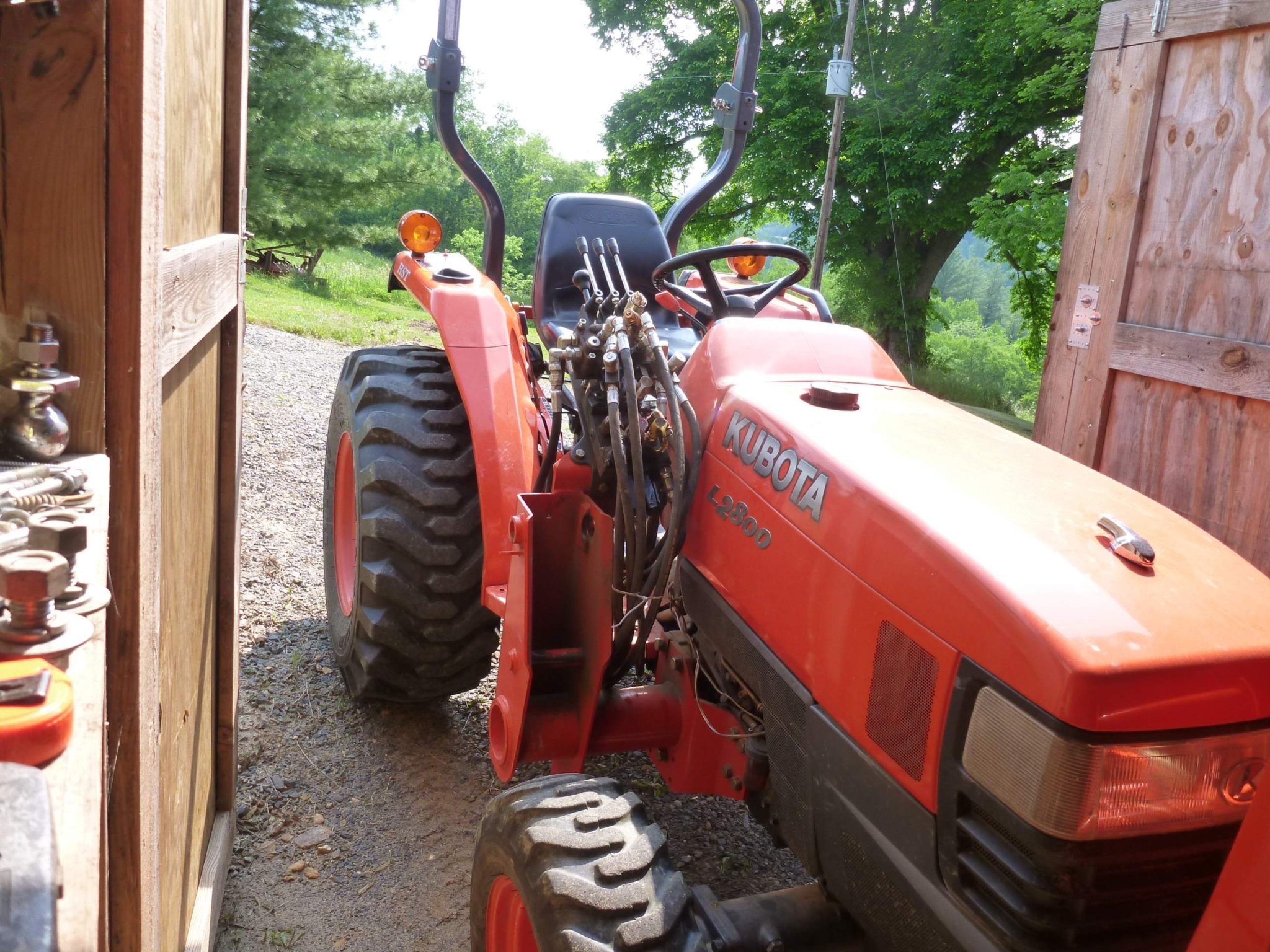

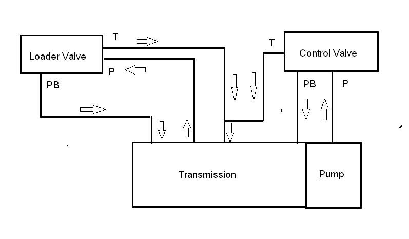

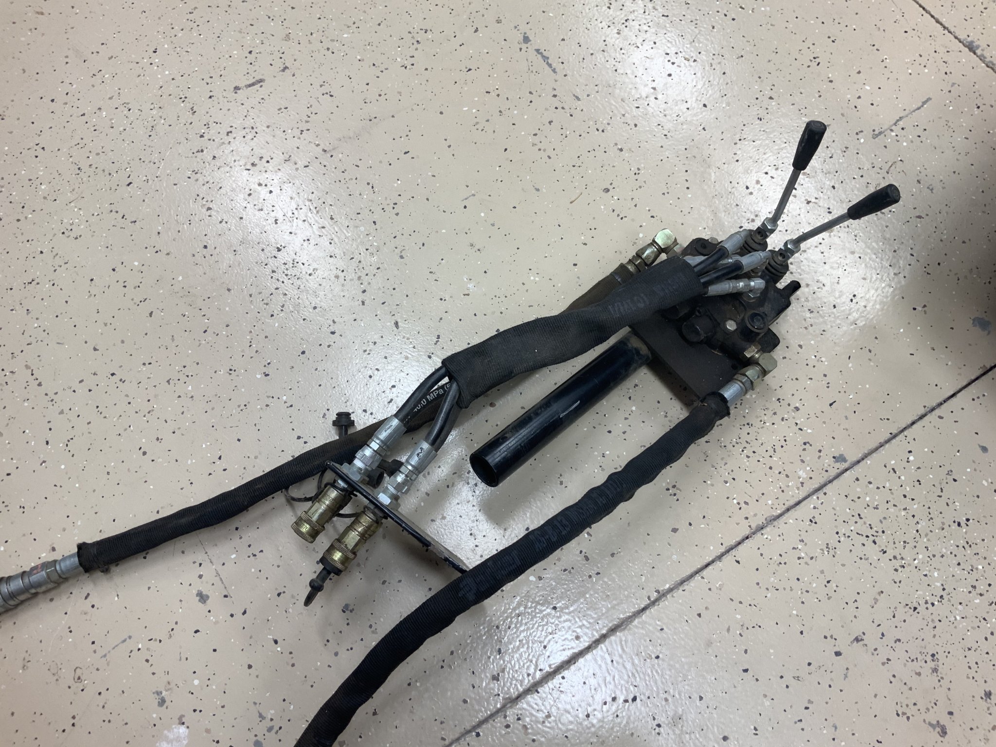

So I wanted hydraulics for 3 point hitch Top and tilt hydraulics but also a grapple. I installed a 3 spool valve and mounded it above my FEL. I did that since I could reuse a couple of hoses. If you don't know by now, hydraulic valves are plumbed in series, one after another. I removed the high pressure out of the FEL (called the "Power Beyond") and attached to to the new 3 spool, power beyond port (high pressure out...) this line is used to power the 3 point hitch (or backhoe).
I bought a hydraulic hose to go from the old FEL High pressure out (called Power Beyond port) and connected it to the IN port of the new valve (just a loop to the new valve). Only thing left was to connect the "T" port (which is a return to the tank - it's a low pressure 500 psi-ish line) which I ended up connecting to the return line of the FEL (about 3 or 4" inches away). The return to tank is the only line you can "T" like that.
This is the cheapest way to hook things up... I added a couple of needle valves to slow down the speed of the top ans tilt hydraulics so I can feather the controls.
This is what it looks like without the FEL attached... it is a "bird's nest" but it's in an out of the way location. At least in my opinion.
You can follow the same instructions and place the 3 spool any where you like, you just have to get longer hoses to make the connections....
