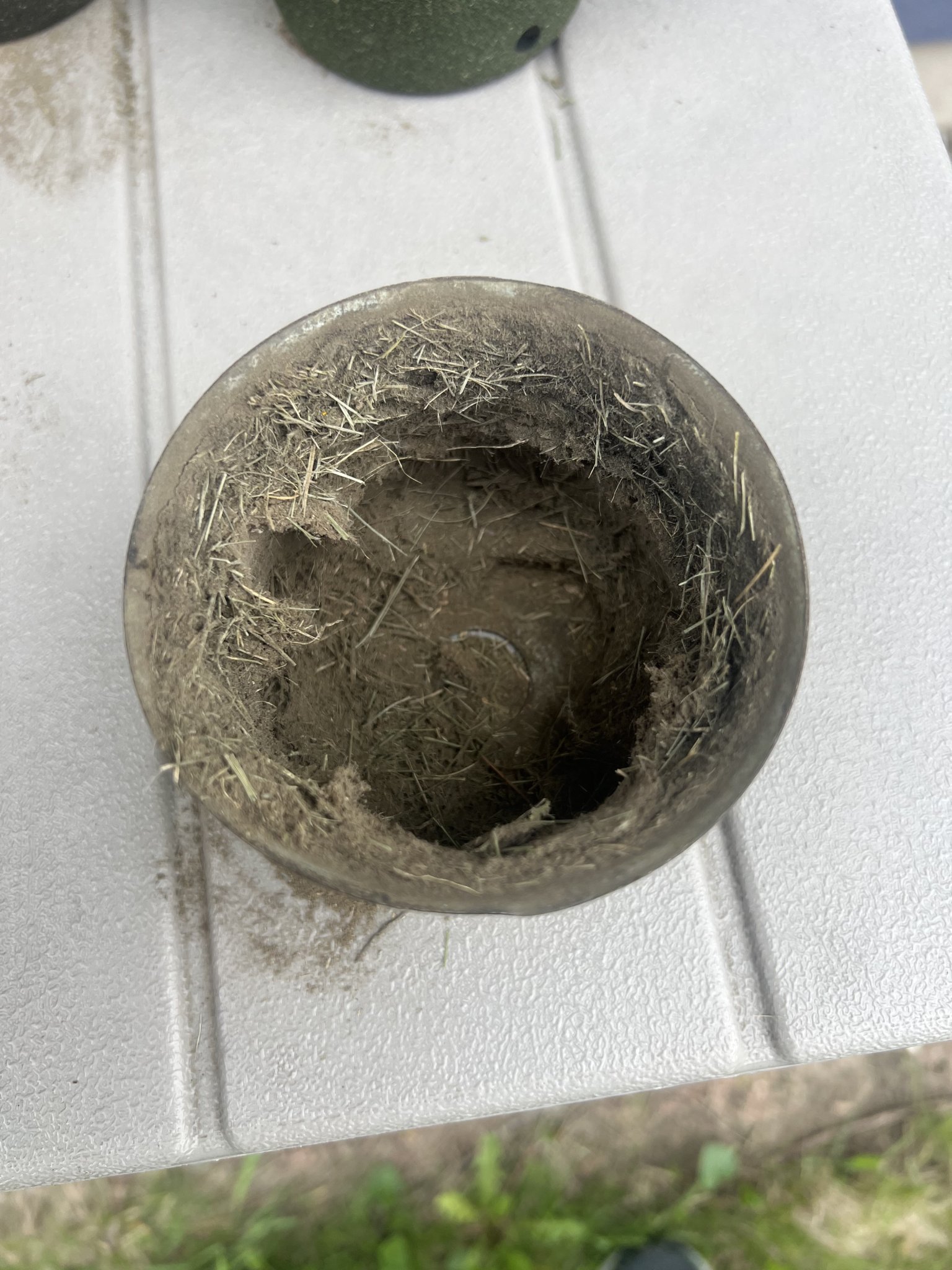

Hello Everyone,
It seems my dust covers for the mower spindles get filled with dust and grass. Is this normal?
Looks like you are over greasing a bit and the spindle vents to the dust cover, filling it. Then grass sticks to it. Otherwise completely normal.

Yep, normal.
