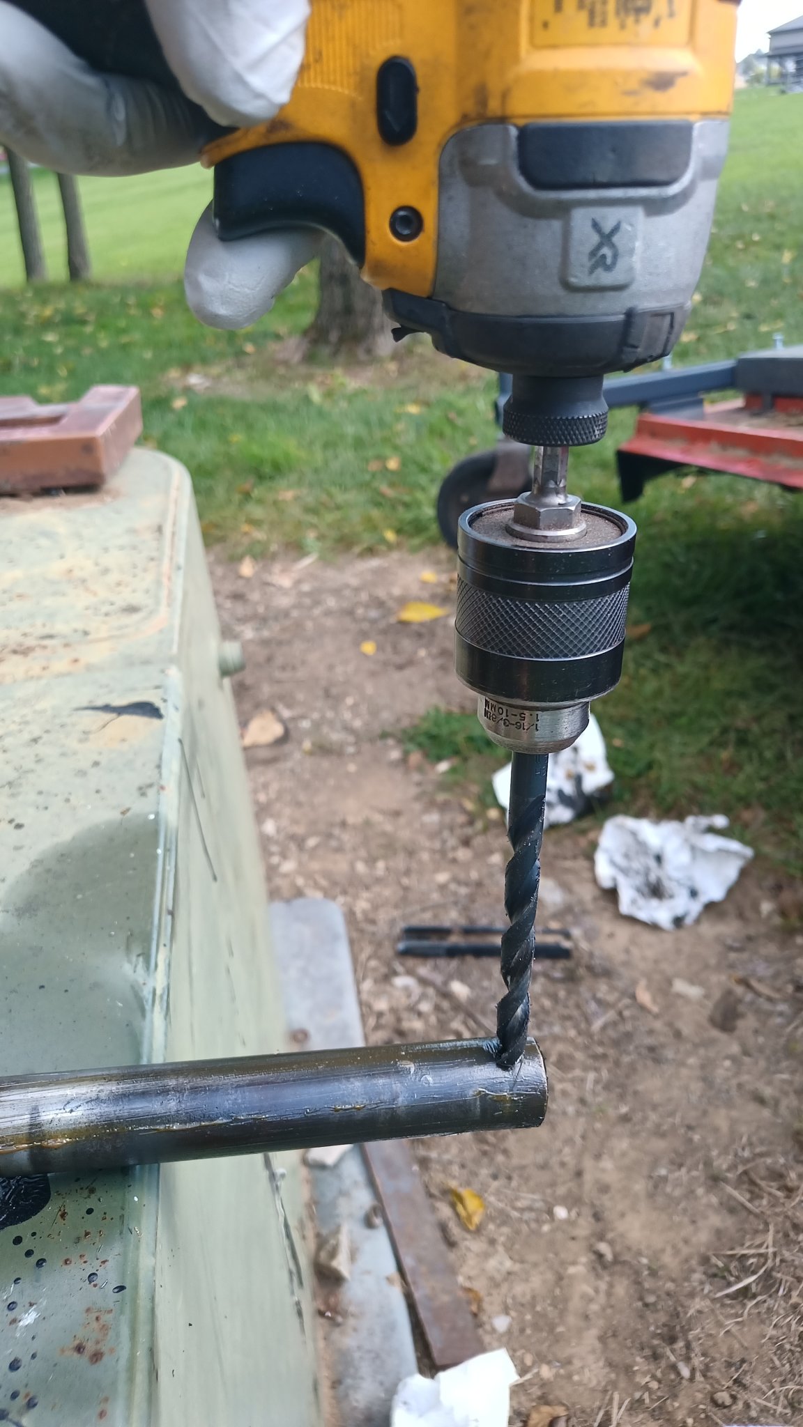

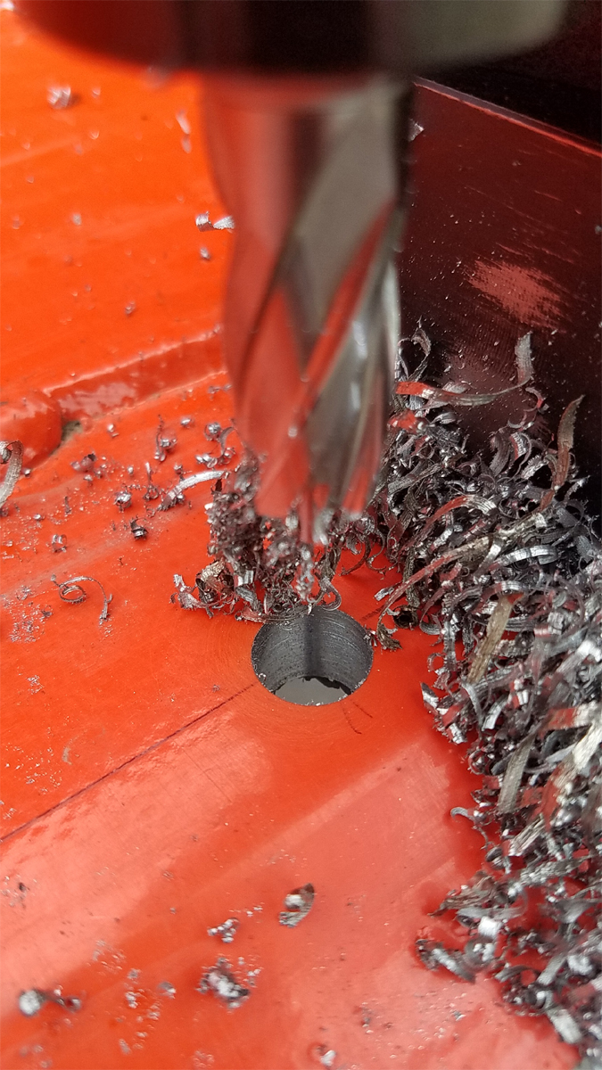

It may have been mentioned before, but just in case.............
My 1/4" DeWalt with a Quick-Connect impact chuck is often my go-to tool for hand drilling when it looks like a situation where the bit will catch. Today I was in a hurry and grabbed a Milwaukee M18 that was sitting nearby and went to work. For about 2 seconds. No go. The quickie job was enlarging the holes for the linchpins on the tops of the stems for the gauge wheels on the one RFM. It was one of those situations where the existing holes were way too large for a proper pilot.
The impact simply hammers away as though it is driving a drywall screw. No twisting of the wrist. It also works great with holesaws.
Oh, and it wasn't really surgery and the wheels didn't have Covid. The gloves were because everything was full of grease :)

Nope. Can hold drill in one hand and piece in the other. The impact hammers instead of twisting. To drill these holes I just laid them on a nearby transformer.
Should also note that so far I haven't chipped or broke any bits using the impact.

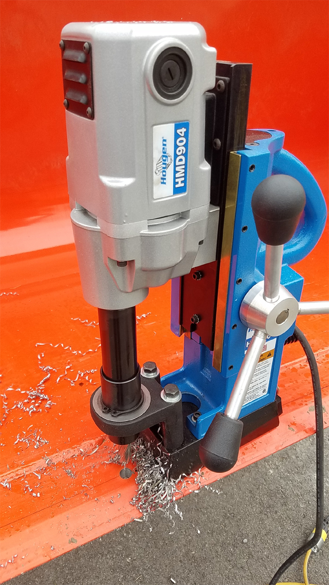

................. I try to use the Hougen mag drill whenever possible ...................................

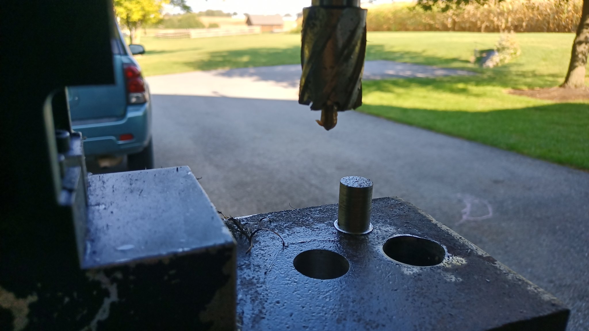

Great tool. We had some real deal Hougen tools at work, and they were quite pricey. My mag drill is the "Oriental Version" of the Hougen. It uses the Weldon shank annular cutters and came with a 3-jaw chuck that has a Weldon end to work with the mag drill. A recent small project required a 1" diameter hole in a 1" thick plate. It took less than 1/2 a minute to drill. Here's a pic with the plug it spit out:

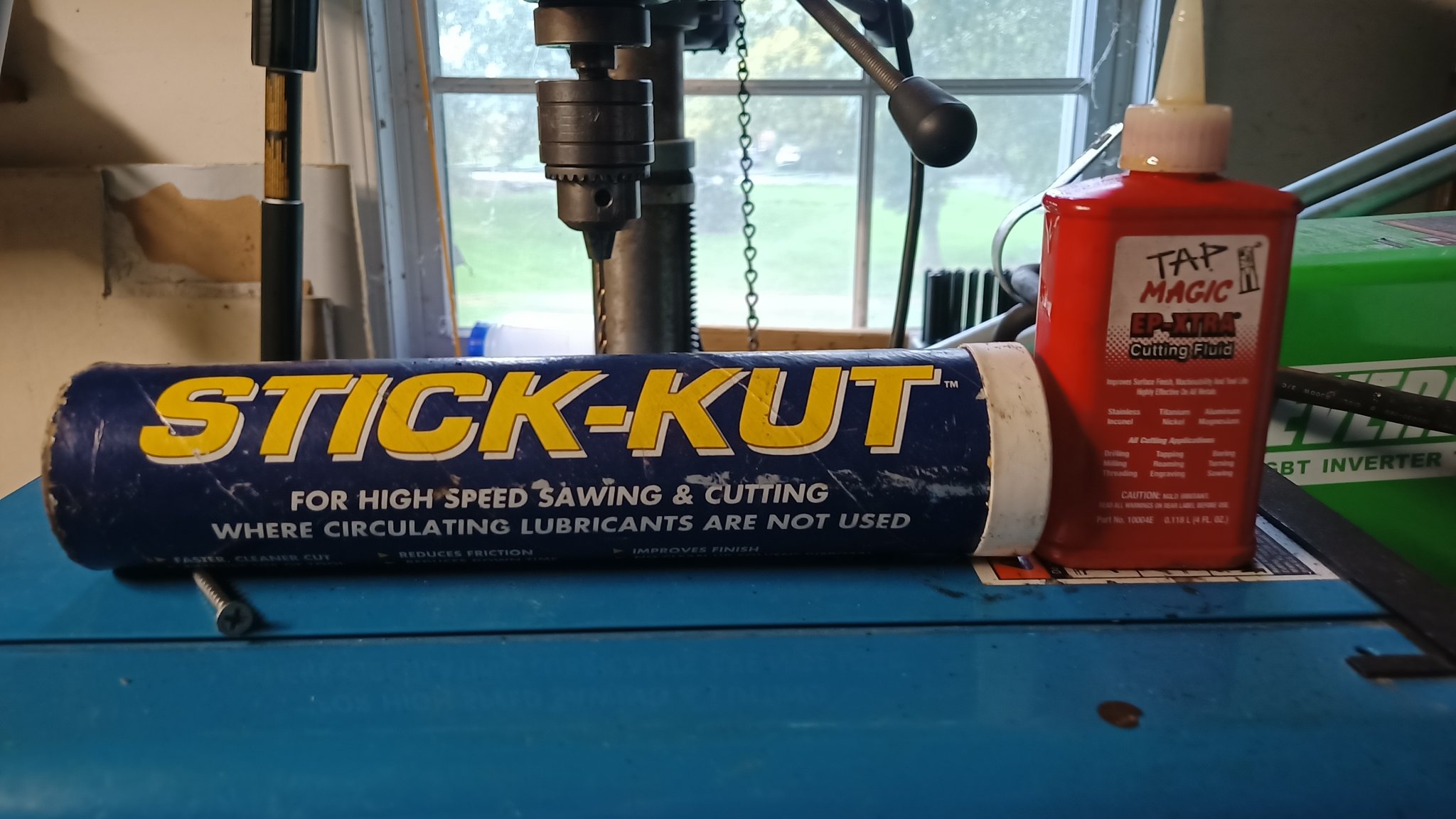

Never knew Madge could help :) Generally, it's Tap Magic for small stuff and Stick Kut for large bits, annular cutters and hole saws. Years ago when using a 7/8" hole saw on a thick piece of steel I used a slow stream of water from a garden hose with a battery drill.

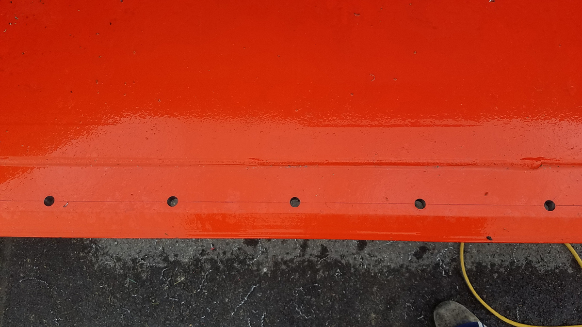

I should have bought a mag drill decades ago but finally got one around two years ago, maybe three. When it was time to drill 11 holes in the M6060 bucket to bolt on the factory cutting edge that I took off the MX6000 bucket, it took me longer to mark out and center punch the holes than to actually cut them. That would be a brutal job with a hand drill and good luck keeping the holes perpendicular to the surface of the bucket edge. The plate I had to drill through was at least 5/8" thick and I think the bolts were 5/8" too or maybe 9/16".
I also bought a standard drill chuck that Hougen sells so that I can run their cutters or regular drill bits. The only downside to the Hougen cutterrs is the limited sizing. That's why a standard chuck is a good addition.
