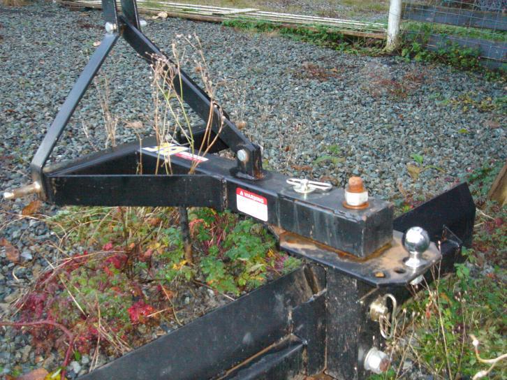

The best solution is to not buy when you've got a tool that can already do the job. Just as I was about to buy I realised that I might be able to use my blade implement, but without the blade itself, if the ball bolt fit through the holes. Seems it does.
Haven't tried to hook up the trailer yet, but it should work:
Still have to sort out the weight distribution issue though.

I'm not sure about that one 5thhorseman, its a cheap idea but your tractor has to pick up the weight of the plow plus the weight of the trailer and its load. It might work great moving empty trailers around. Plus I dont know how well the bolt will hold up that the moldboard is attatched to.

It does work, not the greatest, but does have some advantages.
I usesd it on 3 different trailers, all with very light tonge weights. The weight is the biggest concern, the next is speed.
Pro - with the trailer 3-4 ft behind the tractor, it is easier to put the tong exactly where you want without moving laterally.
Con - With the trailer that far behind the tractor, if you are moving quickly, or across rouph terrian, it can start rocking.
I have since upgraded to a drawbar on a quick hitch, I welded a tab so that the drawbar wont roll too far. The drawbar is preatty cheap, and much easier to carry around. I leave it on nearly all summer. I still have the ball on my rear blade, keep the blade on all winter, so when i need to move my trailers for snow, dont have to keep swapping.

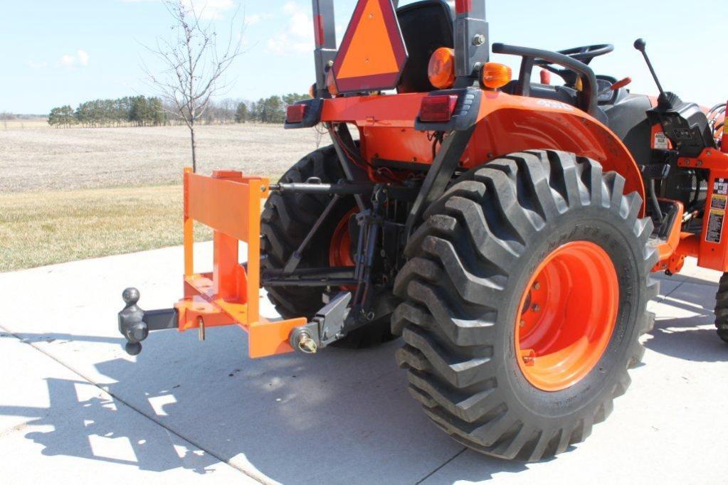

I purchased this from OMNI Mfg. also. I had a plate added that holds 40 pound weights also. although you can get without. Robustly built and I like that it extends away from the tractor a bit. It lets me work trailers into tighter spots.
