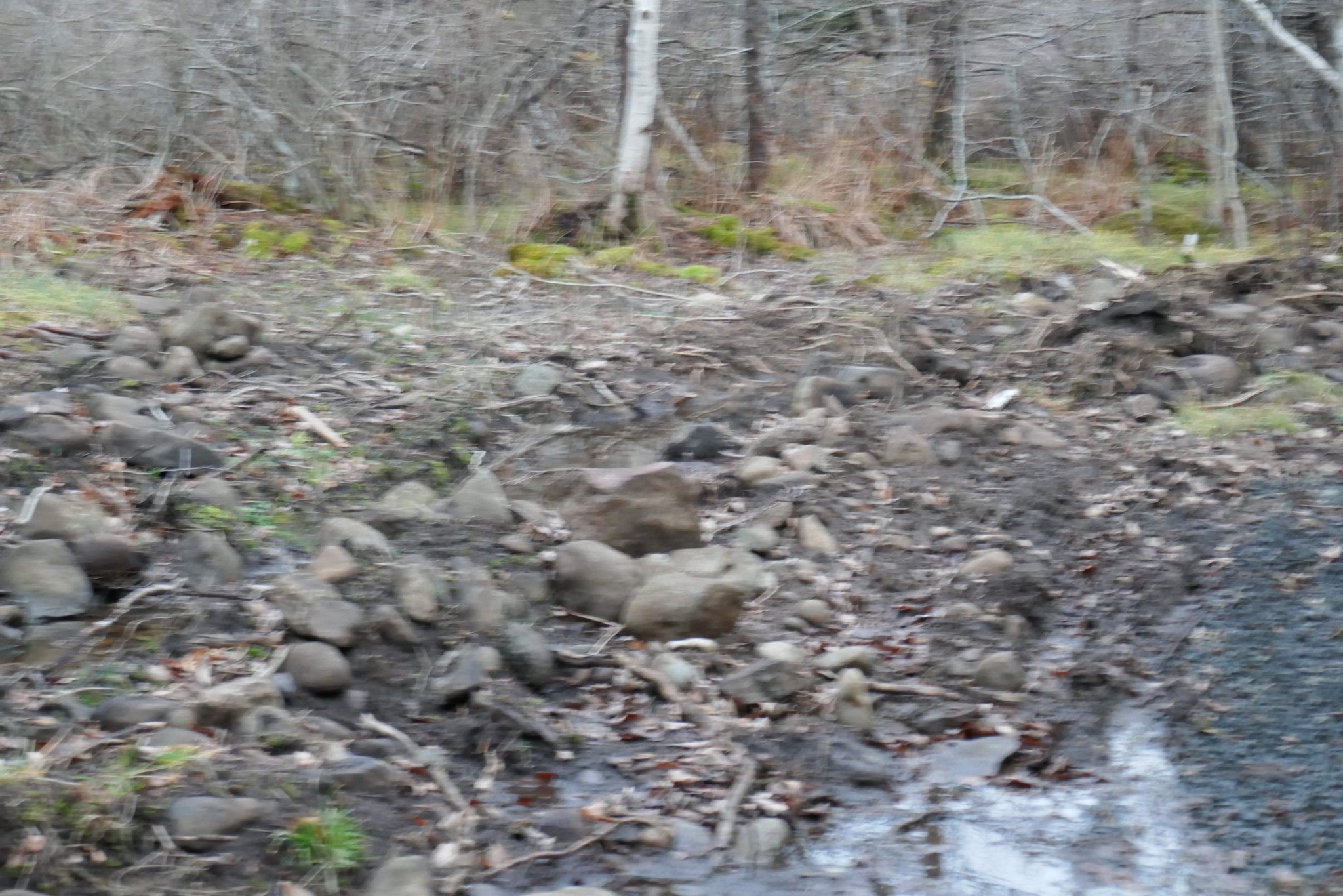

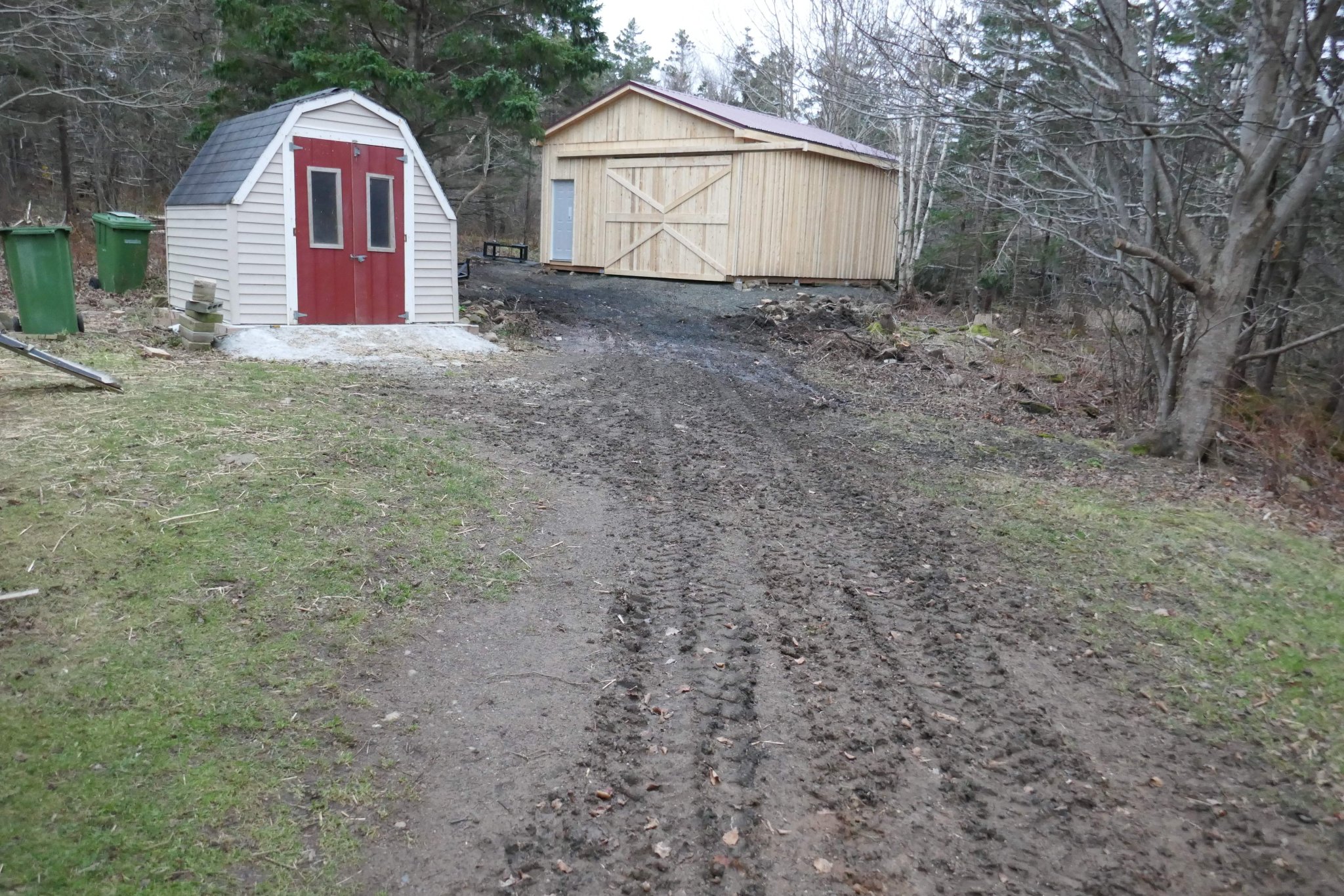

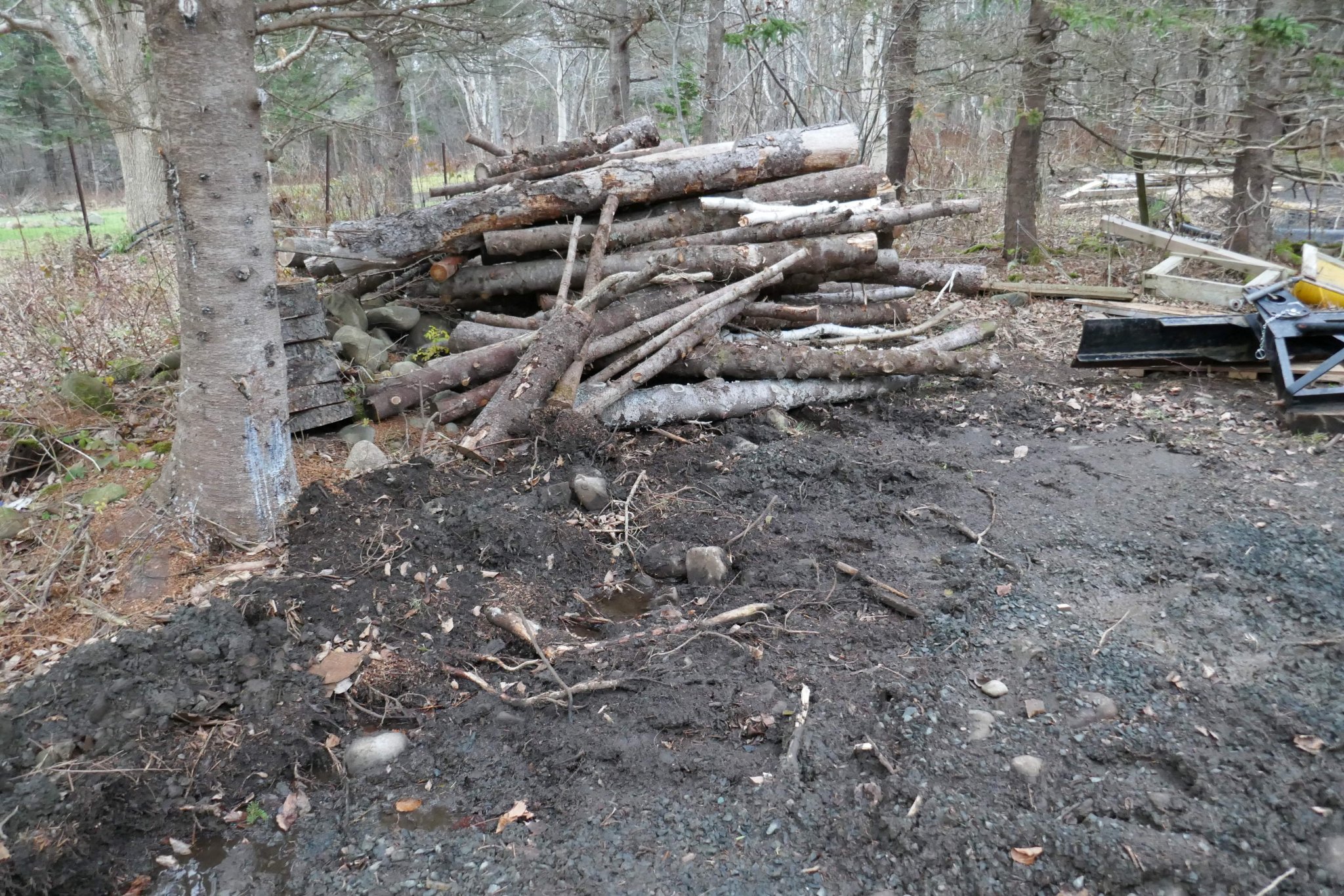

Very hard to get a picture that shows anything of value the wet goes up to the back side of the tractor shed the area where I planned to process firewood and the curtain ditch on the highside of the tractor shed (really hard to see)

A curtain ditch the length of that driveway will do wonders. Depending on the length, I'd probably include multiple Y's in it to run a line across (under) the driveway to daylight.

Basically in agreement with @Mark_BX25D, If I were solving this problem I'd be digging in some sort of drain system on the uphill side of the 'path' (between the small shed & larger one); Additionally, at the base of the approach to the large shed, perhaps an underground drain from L to R. It could even be necessary to extend/install drainage on the L side of the large shed, at the edge of the landing/woods junction, to keep the landing dry & intact.
Good luck, should be an interesting project! Would be nice to see the 'progress' pics here! (y)
