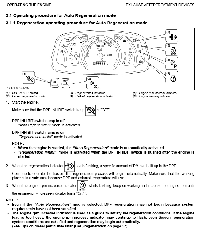

Things don't work as spelled out in the Owners Manual. Both Regen and Rpm lights are flashing, no beeping set rpm at approx. 2200 and after 30 minute still not working!!

Is it calling for a forced parked regen?
8,395
4,253
Make sure the DF regeneration inhibit button is not illuminated. If it is press the button to turn it off.
Now did the RPM light go out @2200 RPM? If not you need to increase RPM until it goes out. My L3901 won't regen @ 2200.
Once the RPM light goes out the DPF regen will continue to flash until the engine gets hot enough to actually regen. When that happens the regen light will stay on solid and the regen is in progress. Maintain those conditions until the regen light goes out signaling the regeneration is complete. Then and only then you can reduce RPM.

It's all laid out in the owner's manual. In addition to the post above, read the last note bullet in bold at bottom which is in the DPF section of the owner's manual.

Ok went through every step again after seeing a post with another item that I hadn't tried as of yet!! Eureka it works!! WIGGLE THE STEERING WHEEL,,, Regen light comes on, Beeps twice, RPM increases, on it's own to 2200 rpm and 18 minutes later it's done!! What a F*&^ing JOKE!!!
