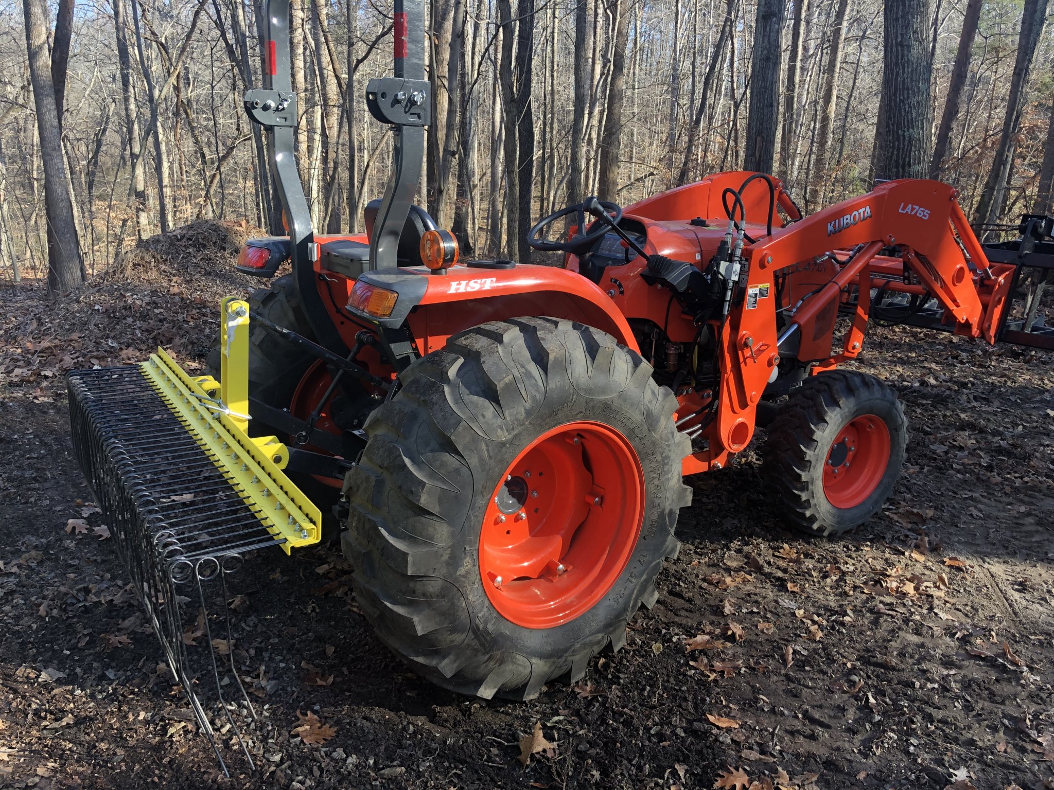

I don’t have a landscape rake. I have a pine needle rake. This is the one I have: https://www.palletforks.com/3-point...raw-needle-rake-for-cat-1-3-point/191322.html
I use it about once a year to do some leaf raking (not pine needles).It’s light, relatively cheap, NOT a heavy duty implement. For what it’s doing, it doesn’t need to be. It will move dry leaves reasonably well without tearing up grass or regrading gravel road/path. So far as leaves, the pic with the tractor is a wood lot/shed area that had about 2” of dry leaves on top of about 3” of wet leaves. Leaving them there results in a layer of incredibly slick black mud after a few years. Just cleared 4” of that sloppy mud off last year so raked the leaves off this year. Took two passes to get the 5” combo wet/dry leaf cover off to the point it is in the pic. Not golf course perfect but not going to degrade to a mud layer either.
My brother has an identical one for pine needles. I tried his on pine needles in grass before buying mine. Worked very well on long leaf pine needles for the 10 minutes I played with it; better than it works on oak leaves. If you want to get pine needles out of grass, it’s a reasonable method. Might move some small sticks but not very reliably.
