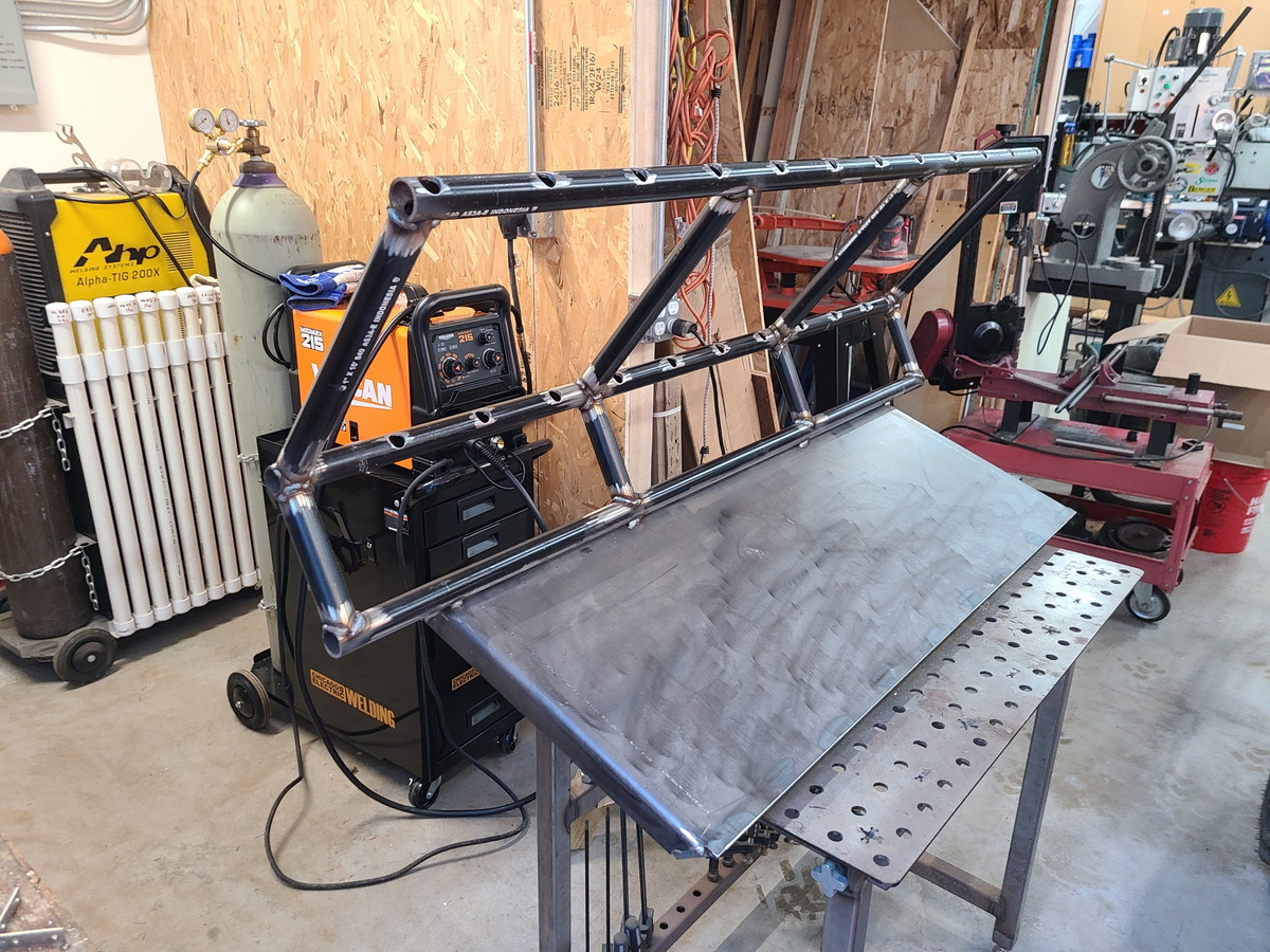

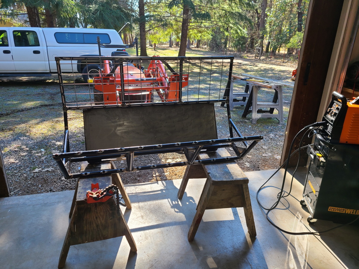

We have loads of leaves and pine needles. I had been using clamp-on debris forks but they didn't work that that great. The tines were too big to penetrate the debris piles well.
I fabricated this one using a SSQA back plate, 3/4" & 1" black pipe, 3/4" x 36" concrete form stakes for the tines and some 4ga. livestock fencing. The tines bolt in so they can be replaced. Tines are spaced 5" on center.
No drawings or sketches, just cut and notched pipe and fitted to what looked right.
Just finished up loading 24cy of leaves and needles. Works great!

Beautiful craftsmanship! Nice attention to detail, especially with the fish mouthing of the pipe. You have a jig for that?

Can you see the tines well enough? Can you cut the solid adapter plate to improve the sight lines if needed?
Nicely designed and built implement
Thank you Yooper! I did the notching on my heavy duty drill press with XY table using annular cutters.
Yes I can see the outside tines. Really nice to be able to see the angle in relation to the ground unlike using the standard bucket with clamp-on debris forks.

Nice job! Are the tines held in with anything or just slipped in the holes in the tubes?
