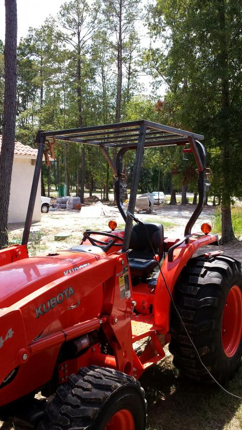

Built my canopy myself. It is stronger and cheaper than the ones you buy. I used 11/4" square tubing for the up rights and 1" tubing for the top support. I made so that I could remove the front up rights when I remove the loader. It was a one day project. I don't put an amount on my time building these kind of projects cause they're just plan fun to do.

Nice work! Did you put a cover over the top as well?
