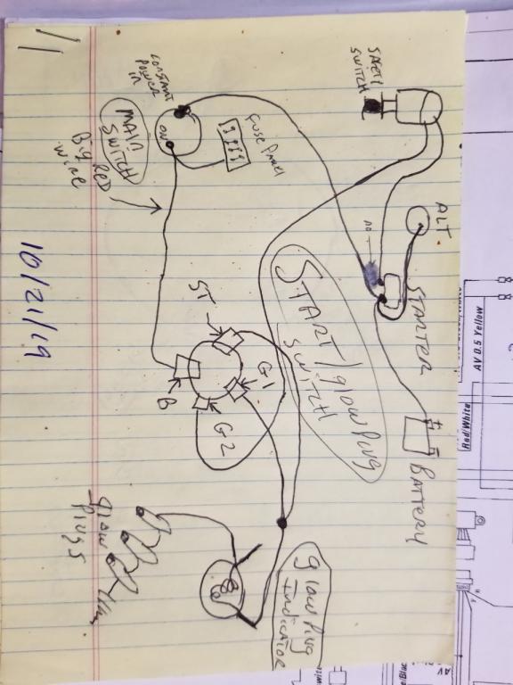

Here's a "home sketch" of the glow plug (and wiring fix) I just remedied last week :)
