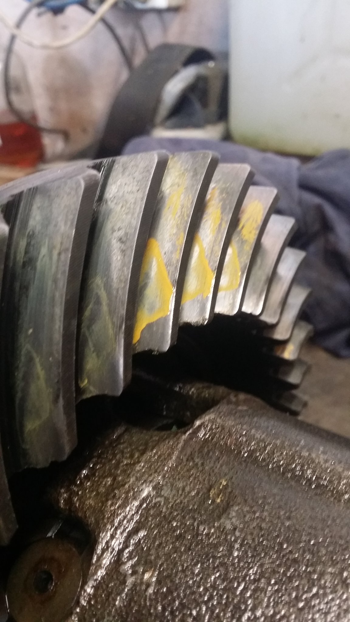

Hi Guys, This is not about my 4500DT this time but same principal. I have a 1997 Mitsubishi Canter 6 tonne tipper and I have replaced the pinion and carrier bearings in the diff.
I needed to add a 2 thou shim on the pinion because the preload was too tight (these have a non crush sleeve type spacer). Before I put new bearings on the pinion I honed out the old ones so I could easily slip them on and off to try out different shim thicknesses. The spacer/shim is between the pinion head and bearing, so it difficult to take the new one off each time to try shims.
The original contact pattern was terrible, drive side near the toe and triangular or some of them dome shape (sunset as they say) I didn't have the correct size shim for under the pinion head so I cut one down to fit the shaft.
It was about 10 thou, about I/2 the original shim( 20 thou) under the pinion. This didn't seem to make much difference where the drive side contact pattern is.
I thought maybe just putting in the new bearings would get the pattern a lot closer to original ( original shim now put in).
These are pictures I have of my contact pattern. The coast side looks ok but I assume the drive side is too deep and close to the toe. I adjusted the backlash between the min/max specs at 8 thou to 12-14 thou.
there is a slight difference of the pattern coming in from the toe (two lots of drive pictures) but it is triangular and I am assuming is too deep in the tooth, and too near the toe. therefore from all the patterns I see on the internet I must, increase the pinion depth (lessen the shim thickness). Is there anyone who can help with an educated guess as to what shim size I should try. I dont want to keep taking this bearing on a number of times and off as its easy to damage.
Final comments, this pinion and ring gear still has meat on it, but it could be worn unevenly and giving me a bad tooth contact. Bearing preloads are correct on pinion and carrier, and backlash I adjusted a few times. Runout is just within spec of the manual at 4 thou. I put pressure on the ring gear as I turned the pinion.
Thanks, any advice will be helpful.

A long, long time ago, I used to do Chrysler/Dodge/Jeep axles as a dealer tech.
I was never particularly fond of using that patterning paste. It always seemed to be like "Black Magic/Voodoo" sort of thing to me.
In my opinion, there is no substitute for setting them up as close to the middle of the specs as you can get, by using the proper measuring tools.
Using the "factory tools" method, I almost never had a "comeback" (BTW those not familiar with the auto industry "comeback" is a 4 letter word....at least it used to be)
I will let others with more experience/authority comment on how to read that paste.
But if I was guessing, and I am......
I agree your coast side "looks" pretty good
I think your drive side is a little off and I would say to shim it near the bottom of the specs (i.e. thinner).
I have also heard that using different "brand names" of bearings to check the "set up" introduces more problems as the specs are slightly different. I can't speak to that, because I always used factory stuff, but its something to be aware of.

Thank you, appreciate your input. The pinion bearings are the same brand that came out (Koyo). Who knows who may have changed before I owned the truck. The carrier bearings are a different brand but the specs are supposed to be the same. Old bearings were NSK and the new ones are Koyo. But I run a contact pattern with the old NSK before I changed them, so I dont think the Koyos are the problem. Look forward to others you know may help. Thanks again, I always appreciate peoples time to give advice. P.S. I didnt run an original pattern prior to pulling it apart as carrier bolts had come loose. How I dont know, maybe someone didnt put red loctite on them. I had the truck for six years before that happened. Fortunately there didn't seem to be any damage to the teeth.

As long as you have reasonable preload on the carrier and pinion bearings, and some backlash,
it's pretty much "it is what it is" and doesn't really have any indication of proper function.
The "only" negative for such a differential setup is it "MAY" be noisy.
There are three driving conditions which may be noisy.
You might end up with one, two, all, or none.
1. Load - feeding the vehicle some throttle.
2. Float - steady accelerator pedal, maintaining a set speed on a flat road.
3. Coast - foot removed from accelerator pedal, using engine braking to gradually slow vehicle speed.
As you are aware, changing the shim on the pinion gear head (under the bearing, and the bearing is pressed in place) is difficult at best. Removing the bearing for changing the shim usually damages the bearing, and then replacing the bearing with another new bearing "theoretically" changes the setup pattern. So now you are in an unending situation where you cannot win.
So as long as you have reasonable pinion shaft bearing preload, and reasonable rotating torque for the pinion gear (with only the pinion gear and pinion bearings installed in the housing)
and reasonable carrier bearing preload, and some reasonable backlash, you will be good to go.
The wheels will go round and round and the vehicle will be usable.
Noisy? perhaps... However, 75W-140 gear lubricant will be your friend in that case

I would tend to agree with the above. It is essential to establish proper backlash and preload FIRST. That way you know you have acceptable pinion depth.
In some cases (especially with worn/used) gears it simply isn't possible to get that 'perfect' gear pattern. Personally, I want to see the drive side pattern as good as you can get it and not worry quite as much about the Coast Side.
OP states he has KOYO bearings to use (there is nothing better). So no worries there. From the patterns shown I'd like to see the drive side pattern come out of the toe a bit, but it isn't badly centered from the top land to the root.
You can see on this Dana 44 I set up... the drive side pattern is nicely centered and consistent in shape. The coast side much less so, but this gear set runs well and is not noisy.
I don't think the OP's set will achieve the same pattern, nor would it be necessary if not starting with a new gear set.
In short, you can 'chase' patterns until you are blue in the face. With used gears....I would pay more attention to proper backlash and preload.

Thank you all, most appreciated to getsome advice.
The only change I made, are the bearings and I did need to put a 1.92 thou shim (.05mm metric we use here) on the spacer sleeve. I did this because one of the old bearings felt it was binding as i tried to set the pinion preload. So I bought new ones and the preload was definately too tight when I installed them and started to tighten up the pinion nut. With the small shim put in where the spacer sits, the preload tangential torque went nicely to spec.
Thanks again for advice from everyone, I will put the diff in and give it a run.
I’ve done several rear end rebuilds and I’ve found that if the original pattern is good, you can simply replace all the bearings with quality replacements ( Koyo, Timken, BCA, Federal, MRC) and reuse the original shim packs (Don’t mix them up!) and be within a thousandths of where you need to be. I recently did a Dana 60 where I had to ad .001 to the pinion preload stack and that was it. Since you had a crappy pattern to begin with, you’ll have to add/remove pinion depth shims to see if you can improve the drive pattern. Check with gear manufacturers instructions too as some brands naturally have what appears to be a crappy pattern but is designed that way. Bad pattern can not only be noisy, but can also accelerate wear. Also get your backlash into spec before checking pattern. .014 seems high, usually .005-008 is what I’ve seen for most gear sets I’ve done.
-pinion preload set by shims on the front/rear pinion bearing spacer. Check with ring carrier removed.
-backlash set by shims or adjusters on side carrier bearings.
-pinion depth set by shims under rear pinion bearing.
Wrong preload kills bearings for sure
Yes you may destroy the rear pinion bearing by removing it, but percentage wise, it’s a small cost compared to the cost of the whole job. I’ve had good luck getting quality NOS bearings on fleabay, usually $20-$25 for Timkens.
Good luck

Yes I have read about everyone hating crush sleeves. This beast has a solid collar and a 20 thou spacer as well as the collar. All I needed was to add a 1.9 thou shim to get the correct bearing preload.
Good luck
Thanks, this is a pretty large diff on a small tip truck, backlash specs for this are between .0079- .011 thou.
The maximum or replacement limit is 20 thou.
