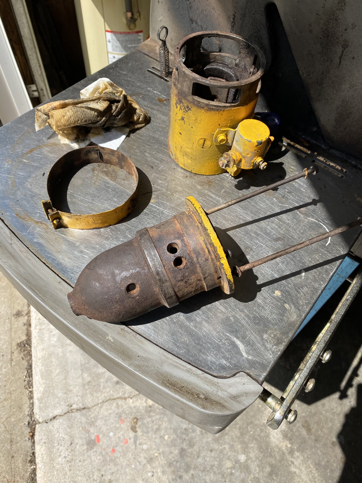

Disassembled:
8,428
4,089
Cleaned up nose cone, commutator cover band and outside of stator (?) cover with brake cleaner.
I will get some contact cleaner tomorrow to do inside of stator, after getting the majority with towels.
The nose cone has two mounting holes. Only supposed to be one?!?! I didn’t mark the starter’s orientation to the bell housing because it can only go in one way...or so I thought.
We did have 2 MM’s, and this starter was hanging on one of our silo room walls.

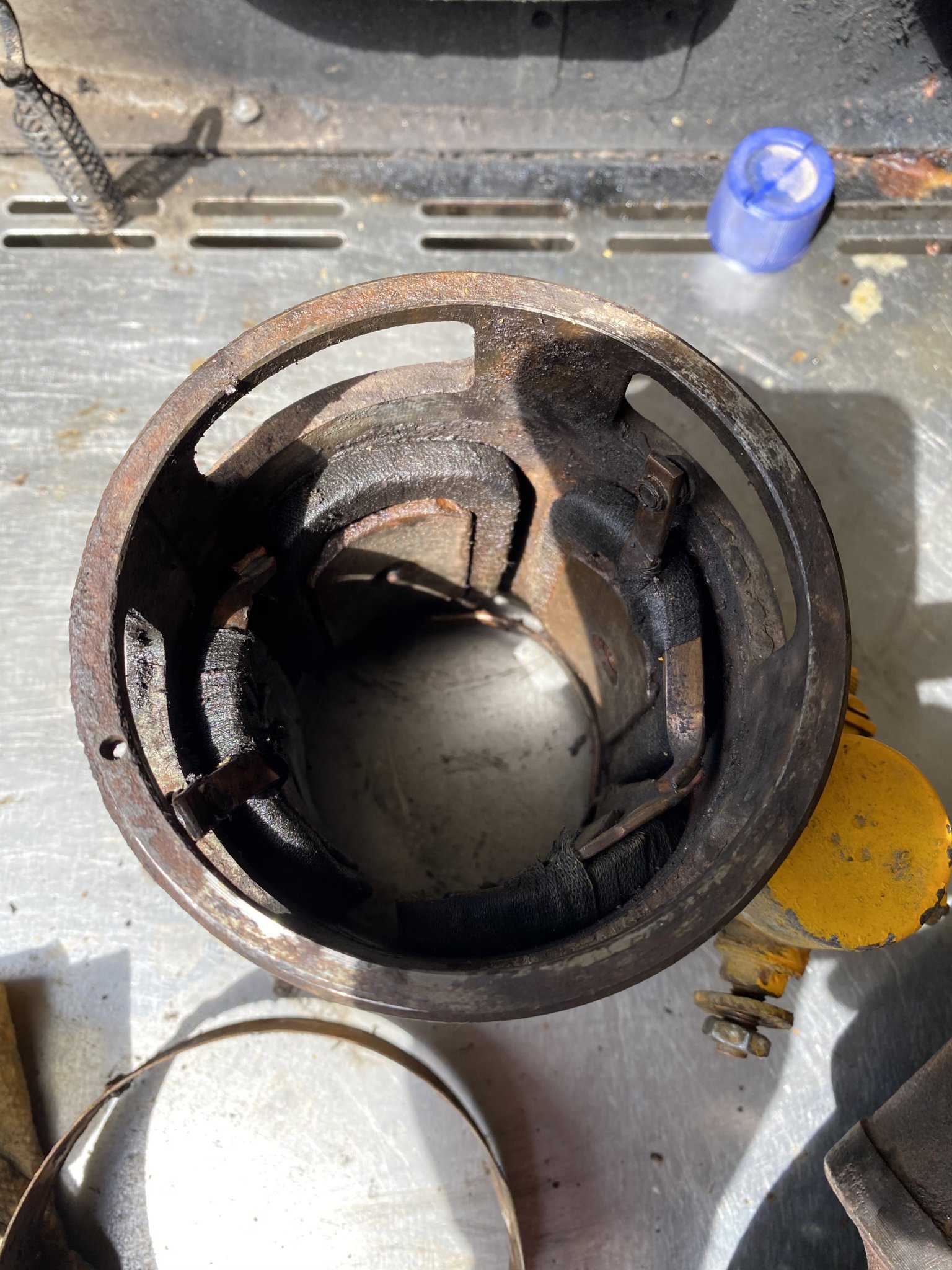

Inside looks okay to me.
I had to blow a bunch of PB Blaster in the cone area to free the starter.
Maybe the oily residue is from that?

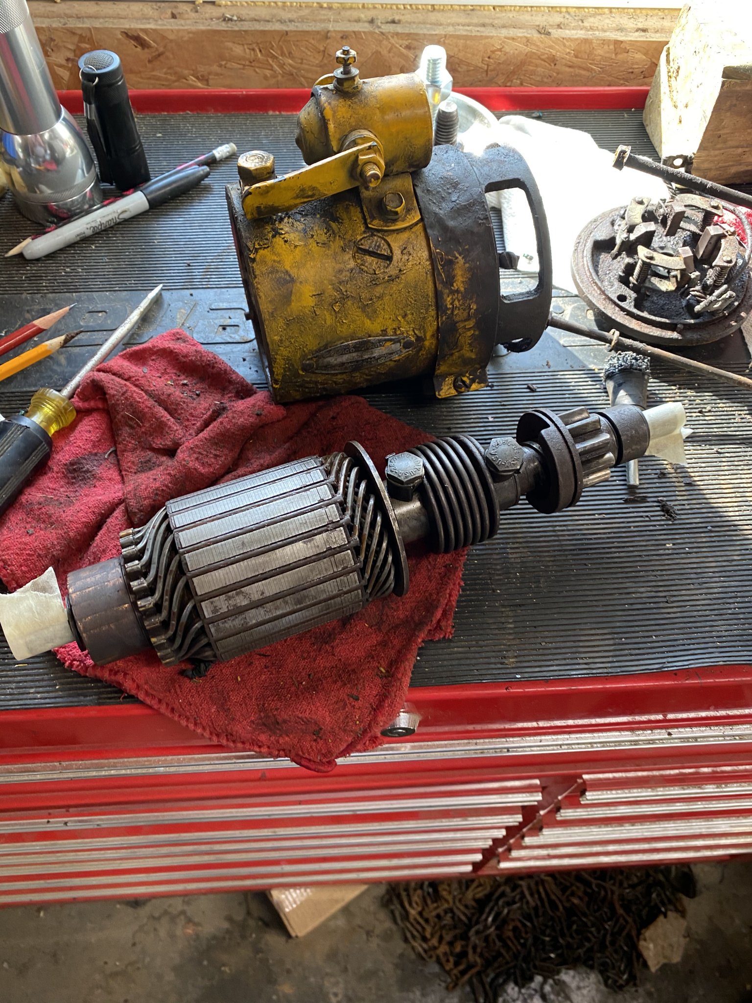

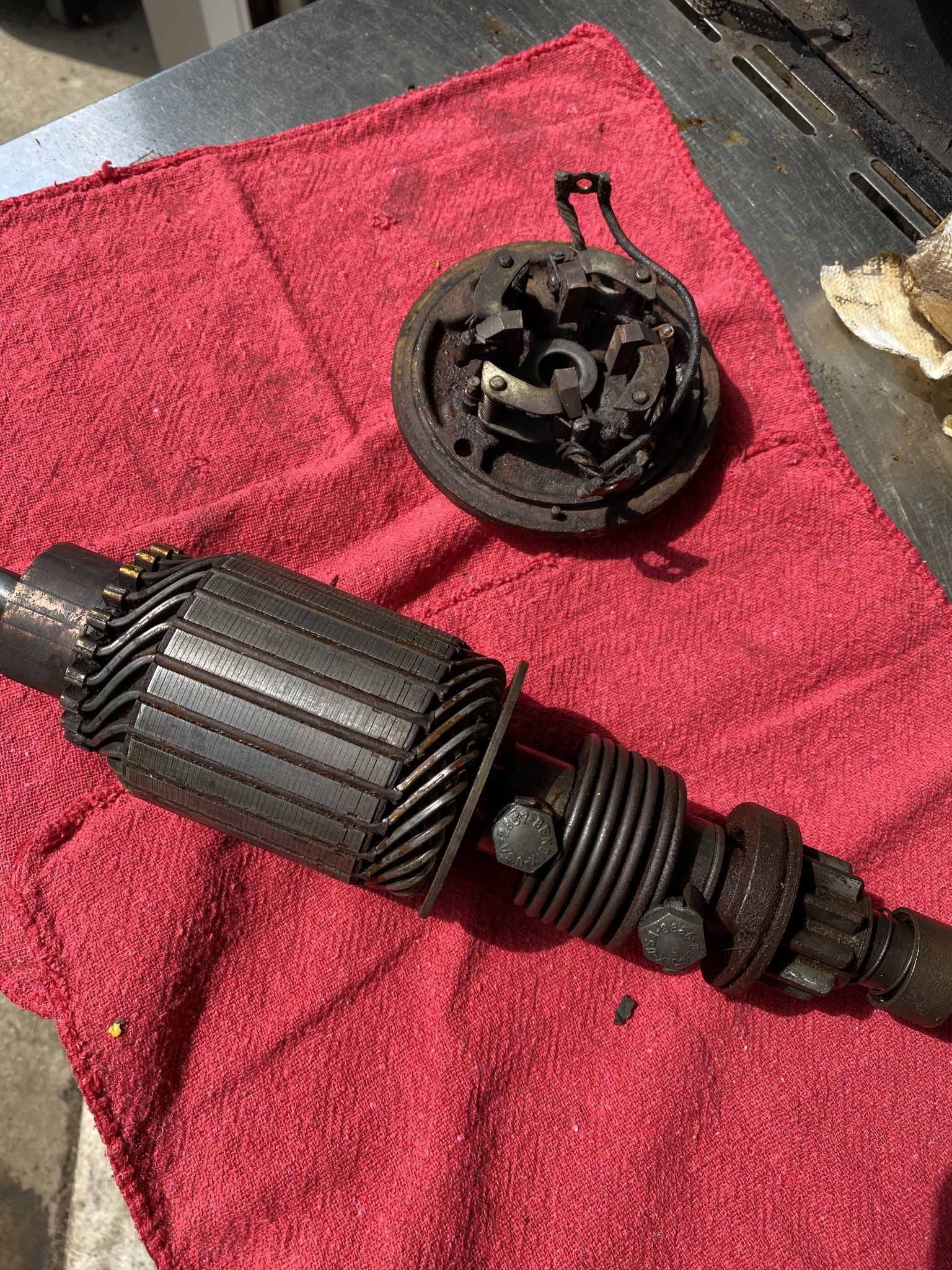

The guts of it, rotor and brush assembly.
Birddogger and Lil Foot pointed out I need to be careful cleaning the commutator at left side rotor shaft.
The brushes look good to me, but honestly not sure what I’m looking at.

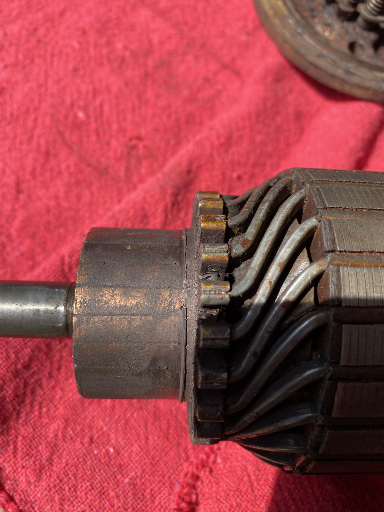

Commutator:

This Bendix bolt was loose. Might have been the problem?
Otherwise, the starter worked well on 12 volts. The flywheel is a little boogered up, but not sure if it’s associated with this episode.

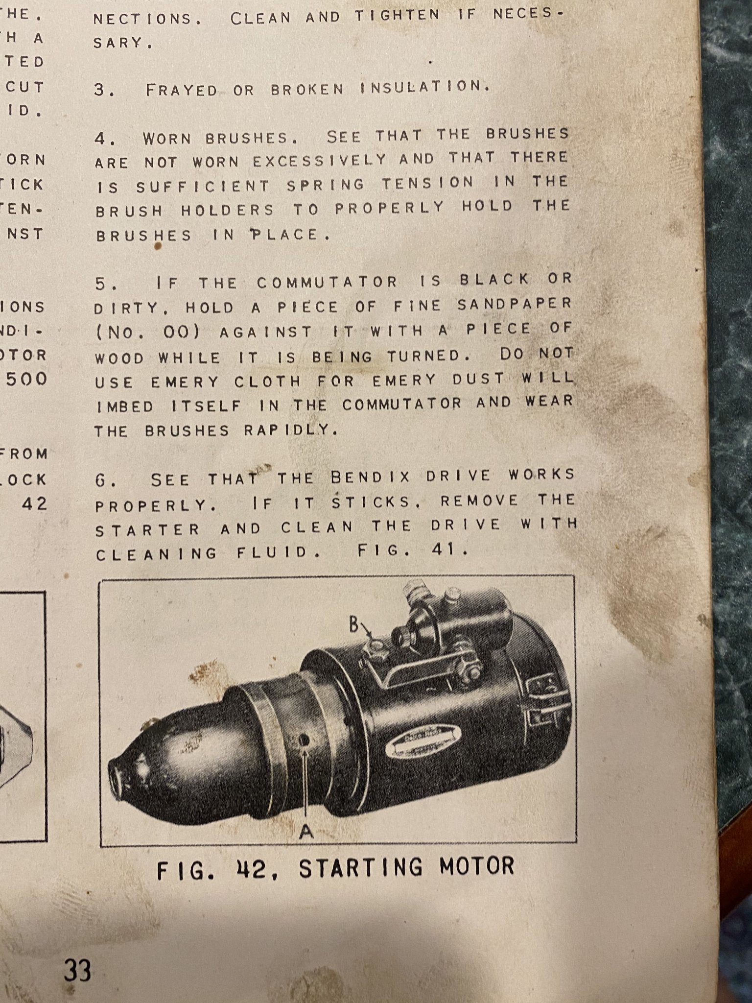

The commutator surface needs to be cleaned if possible. It appears that it is covered with carbon dust from the brush contact, but it may be more of arc flash burns.
Your manual should have a good explanation of how to clean it up. I recall using emory cloth (not sandpaper) to remove the surface contamination but other posts say to machine it so I won’t comment on how you “should” clean it.
8,428
4,089
Russell - thanks. The manual does talk about No. 00 sandpaper. I’ve seen use only aluminum oxide paper, not emery cloth, etc., but turning is the best.
I’ll wash it down with contact cleaner tomorrow and see where we go.

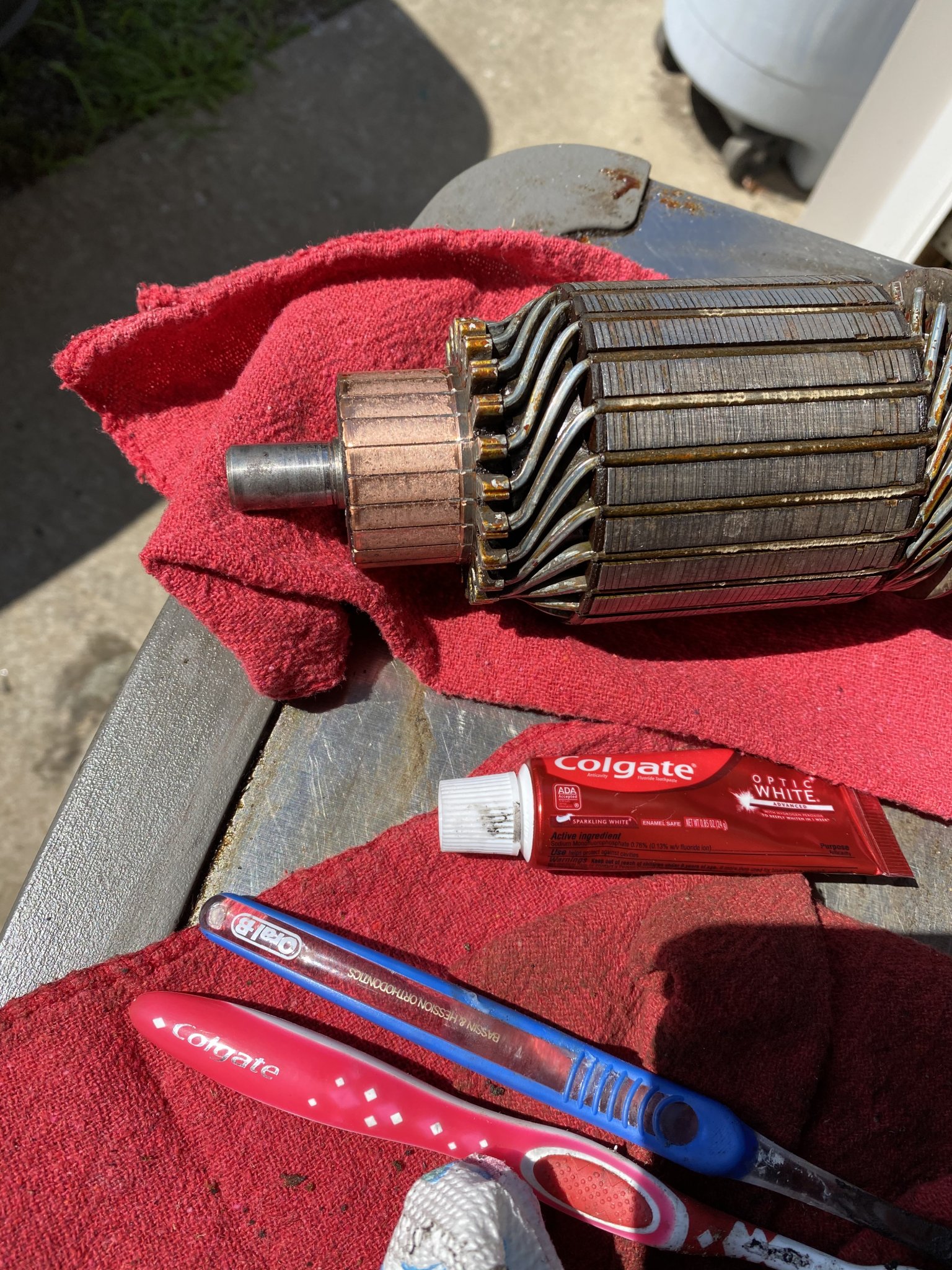

Commutator:
RCW, the commutator looks almost unused.....as you can barely see the edges where the brushes contact the copper segments. A good cleaning may be all you need on this end. Even some toothpaste on an old toothbrush would do wonders on this lightly used commutator. Spray it clean with your contact cleaner afterwards.
Since your commutator looked brand new (but dirty) I surmised your brushes were not worn much either.
The pic of a rebuild kit including new brushes confirms that:
A good cleaning of the brush holder and its parts to make sure everything is free to move and swivel should be all you need to do. I'm guessing there might be some kind of insulators to keep those brushes from case ground but its hard to tell from your pics. If there are, make sure they're ok after you disasssemble and clean before you put it back together again. You'll need to find a way to keep the brushes retracted against the spring pressure when you put that end bell housing back on the starter. then remove the holding devices once together. I might have tied the brushes back with some string through the housing openings.....then just cut the string and remove once it's together again. But it's been a while since I've done one of these.
As an example of a badly neglected motor here's what an unrepairable commutator looks like. There was not enough copper left on the segments to "true" them up again and the whole business fell apart when trying. But it was fun to try....
My guess is the operator never checked and replaced his brushes. Once they wore down to the wire connection within the carbon brushes itself, that led to the destruction of the commutator. This armature is then worthless unless you could find some NOS commutator parts from the manufacturer.
Pretty slim chance of that.
