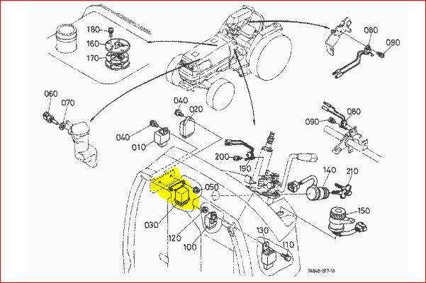

#1 Thought: Replace the relay!
#2 Thought: Disconnect the relay and hope the glow plugs haven't already burned out.
Note: It's warm enough that the tractor will start fine without the glow plugs so you can still use it, just get it replaced soon.

Where is this relay located that your are talking about. my L3600 is doing the same thing with the light.
29,065
5,366
The relay is on the left hand side under the dash, I just don't know if you can get to it under the hood or if you have to pull the dash panel out.

Had the same thing happen on a different model machine. Change out the timer and/or relay--may be two different 'boxes' on your unit.
Make a deal with your dealer to return the one you don't need after testing --by installing--one at the time to be certain which you do need. Unlikely both bad at once.
With the glow plugs continuously on you may notice battery being drained if you make a lot of short trips on your machine--alternator can't keep up with the battery being discharged if machine is run just a little bit at the time.
Running with glowplugs continuously energized won't hurt them--at least didn't on mine for a hundred hours or so until got back to where could get it under control.

Replaced the GP controller and it works perfect. Getting to it is a trick but I am now an expert. I wish I would have thought to take pics. Had to loosen the instrument panel and cowling to get in there.
